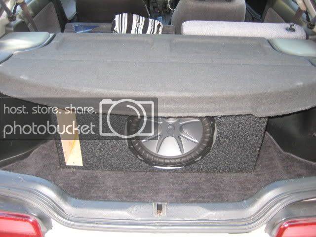

12" kicker CVX. Acura integra, just did 141.1!
Try2makeitwork
Sky High

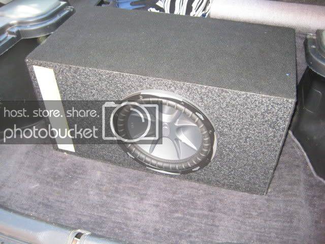

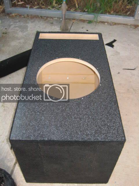

Hey First i want to say I have learned everything from this website and have used it for years! this is the first time i took pics of any part of the build.

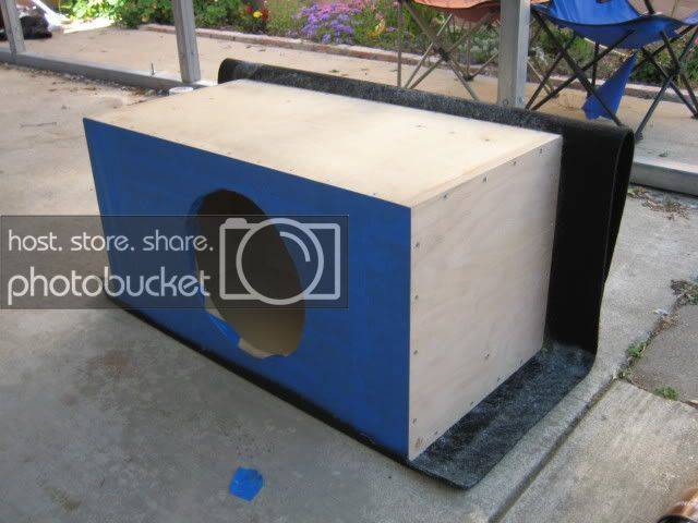

This box used to be 2.74^Ft @ 32Hz but with only a kicker 650wrms amp it couldnt push hard enough. (well not compared to my old setup. 2 MTX 10" 8500's off a hifonics BXi1600. that was loud!! tuned to about 40Hz. )

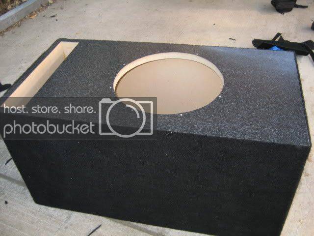

So when i got a new car the box was 1/2 too wide to fit between the pillars in the back so i cut the box down from 32"W to 30"w and pulled the port out. i used RE's enclosure calculator to get the tuning right. i built the box to be tuned to 35hz after port and sub disp. then i added interneal bracing in the corners so that bumped me up to 36-37Hz! Its great!! little too boomy sometimes but It hits the LOWS!
Box now is 30" X 15" X 15". Internal Vol is 2.5^Ft and the port is 2.5"W @ 23 3/4"

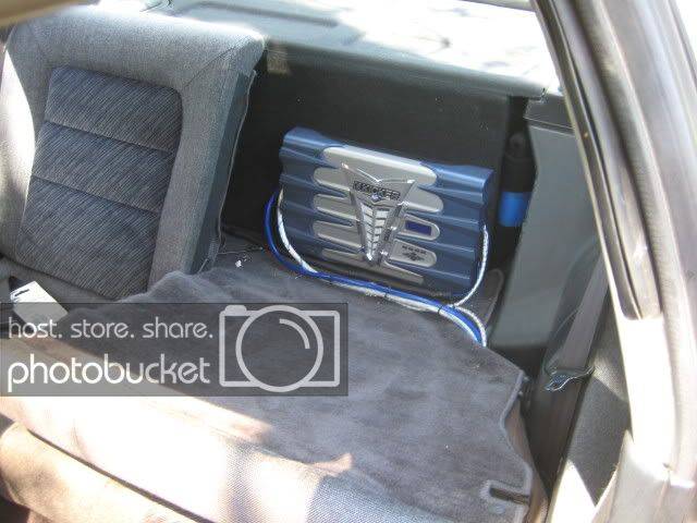

long. My amp is a Kicker 650Wrms Monoblock. Big 3 install. 85 Amp alt. 4GA. wiring and a Alpine CDA6886! the pics are from yesterday when i carpteted the box.
Enjoy!!

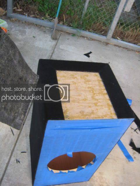

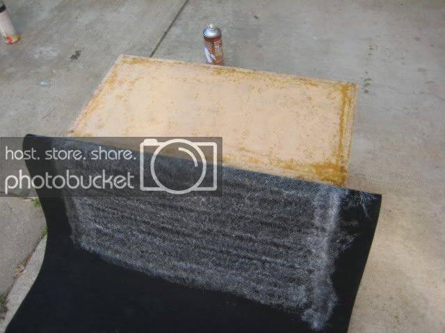

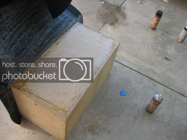

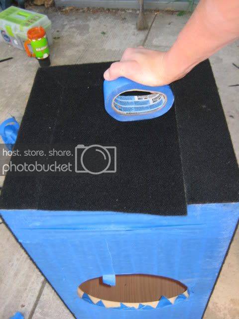

MY roller. gotta get it to stick good!

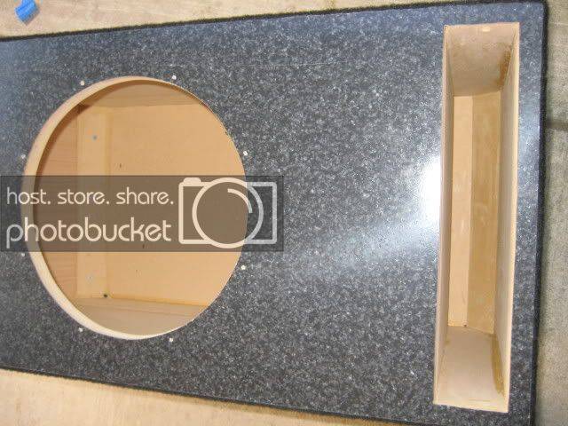

//content.invisioncic.com/y282845/emoticons/biggrin.gif.d71a5d36fcbab170f2364c9f2e3946cb.gif Look good! I used countertop laminate on the front.
The seams on the are blended good.

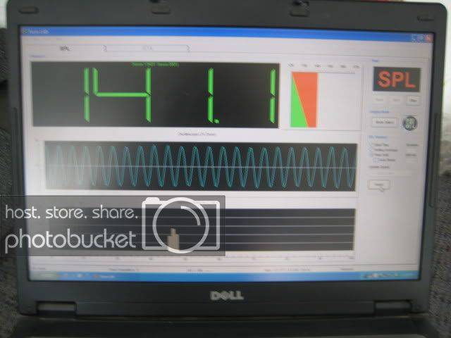

And the other day before i went to my buddies I stopped by the local car audio shop and asked if I could get on the Decibel meter. it was my first time, i didnt know what it was going to do i was expecting(guess) about 130 ish what i got was awesome! this pic was taken after i rolled all the windows up, the guys said it was true spl.
with the windows down burping a 45Hz tone someone on the roof and 2 ppl sittin on the trunk it got 142.2, no pics tho //content.invisioncic.com/y282845/emoticons/frown.gif.a3531fa0534503350665a1e957861287.gif. im entering my first db drag in june!
