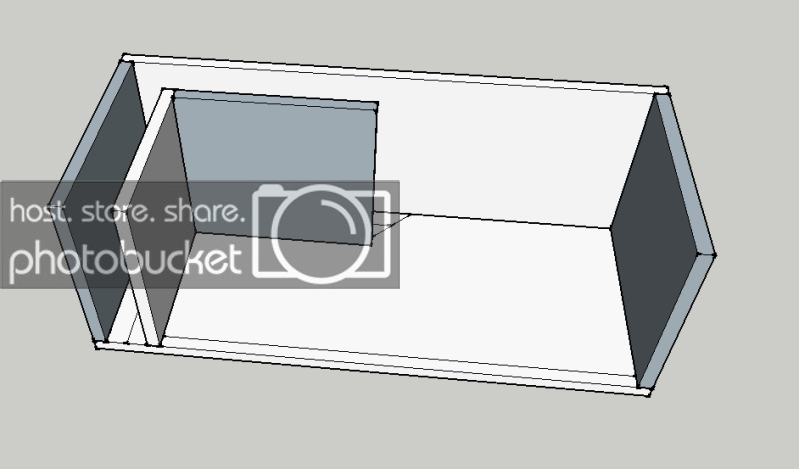

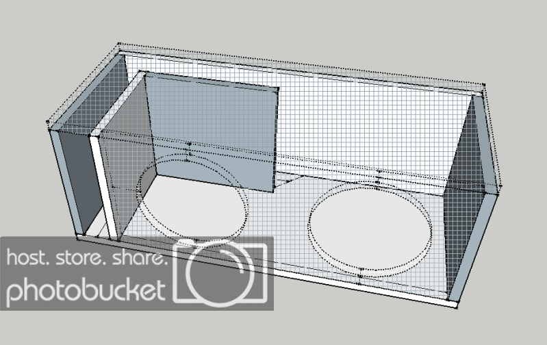

Ok so, I drew this up pretty quick.
Its 2.68 cuft after all displacements tuned to 34.
The subs see 2 cuft.
What do you guys think?
Port is 2.5 x 11 x 26.48 (X x Y x Z) Vent Mach in winisd - .07
Anything I should take a look at?
