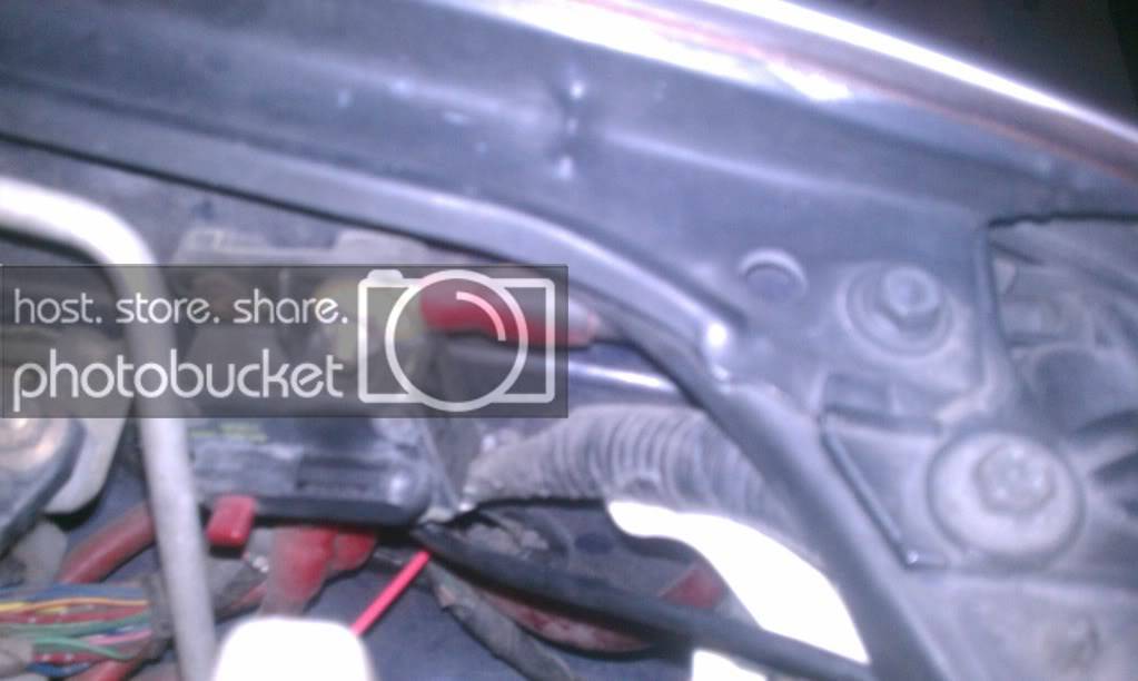

I have a soundquest 100a Circuit Breaker instead of a fuse. (It came with the car)
When I blast music for more than 45 minutes or so it'll break itself. Which is really annoying because I have to pull over and push the little thing back in before I can listen to music again. I can tell when it happens because everything but my head unit shuts off.

go by the basic 100watts=10amps roughly so you would need a minimum of 150amps of fusing(this is why your tripping the breaker),also circuit breakers go bad the more they trip the easier they get to trip I would just pull it and change to a fuse/holder, also your not fusing to protect the amp your fusing to protect the wire from burning due to shorts and over drawing what it's rated for it can only carry so many amps of current before it starts to glow(like a light bulb filement)
ahhhh. Thanks again man, you've been a huge help. Someone gave me a 250a fuse with 0 guage and a really cool chrome terminal connector (Hopefully chrome plating doesn't affect it) that i've just been letting sit around. So i'll put that on prob right now and use the little bit of 0 guage that's left on it to try and get a free negative terminal to chassis upgrade :-D. I was reading on amperage and it didn't make sense why no equipment had amperage ratings because that's what fuses are rated for but i didn't know about that formula.
Amps = watts/volts. Then you multiply that answer by 1.2x, to account for the (approx) 80% efficiency of your amplifier.
So a 1200 watt amplifier at full tilt can pull 112 amps at 12.8 volts, or 100 amps at 14.4 volts.
Circuit breakers should not be mounted under the hood. They rely on mechanical motion to trip, and corrosion can affect that. Ive even seen a CB that was rusted shut, and you could not trip it at all. So placing one under a hood where it is exposed to the elements, is just not a good idea. In trunk, they are fine. Under the hood, use a fuse.
no problem man I would throw the fuse in and the breaker away or if you could run another power wire to your highs amp and use it there where the amperage draw isn't going to be near as bad and leave the 4g wire for your sub amp with your 250a fuse there, it should be good to go after that!
