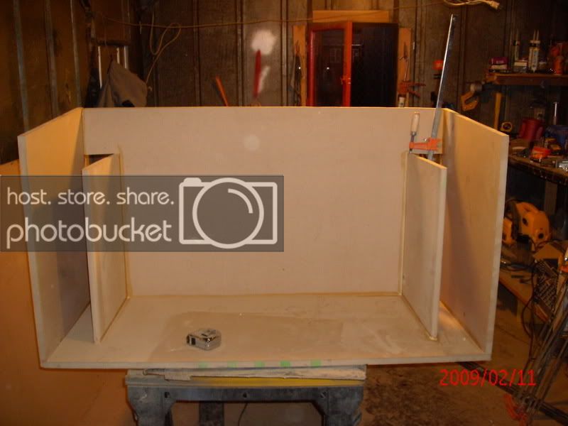

10.6 cubes 34hz 2 L7 15's
azimuth
funded*by*soros

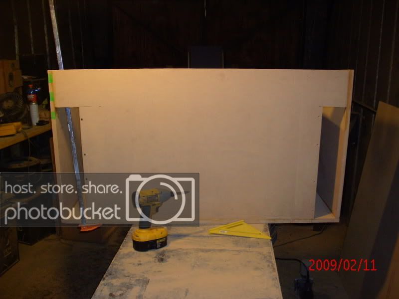

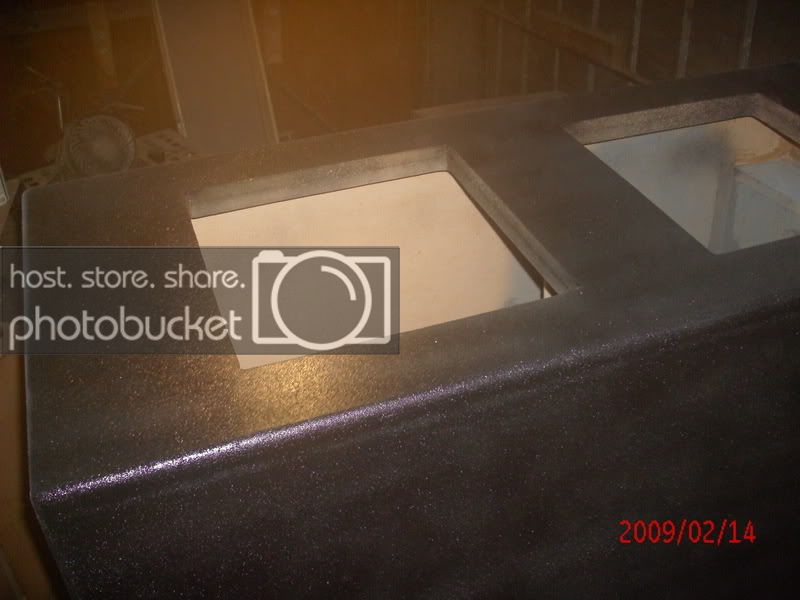

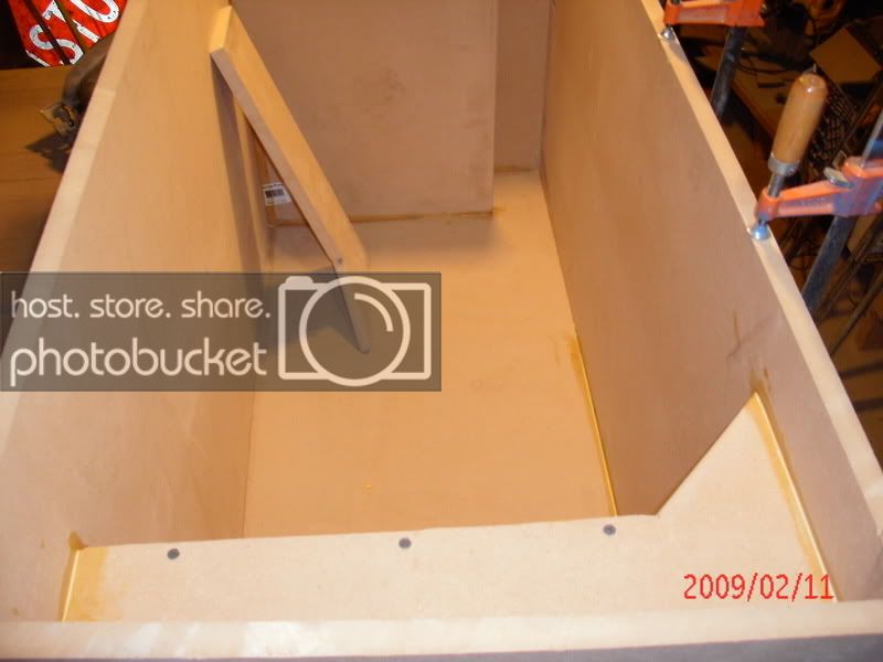

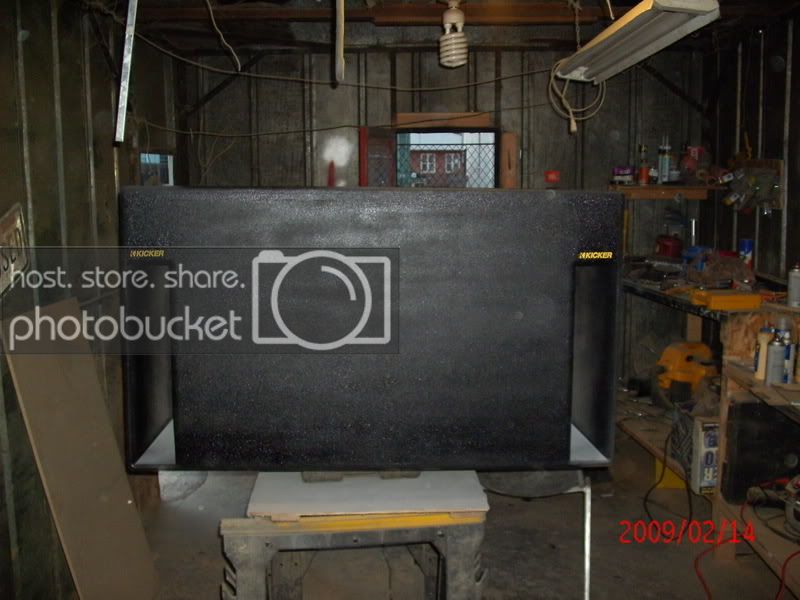

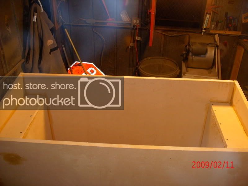

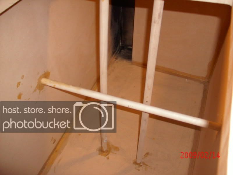

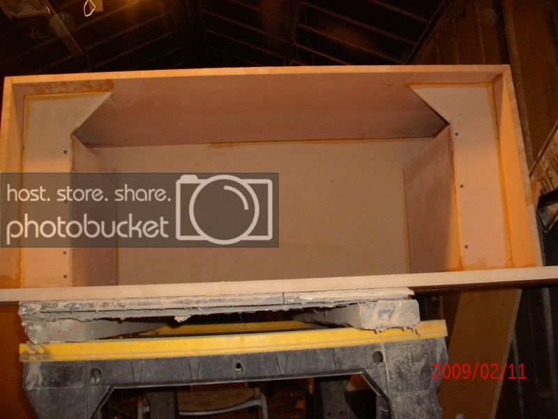

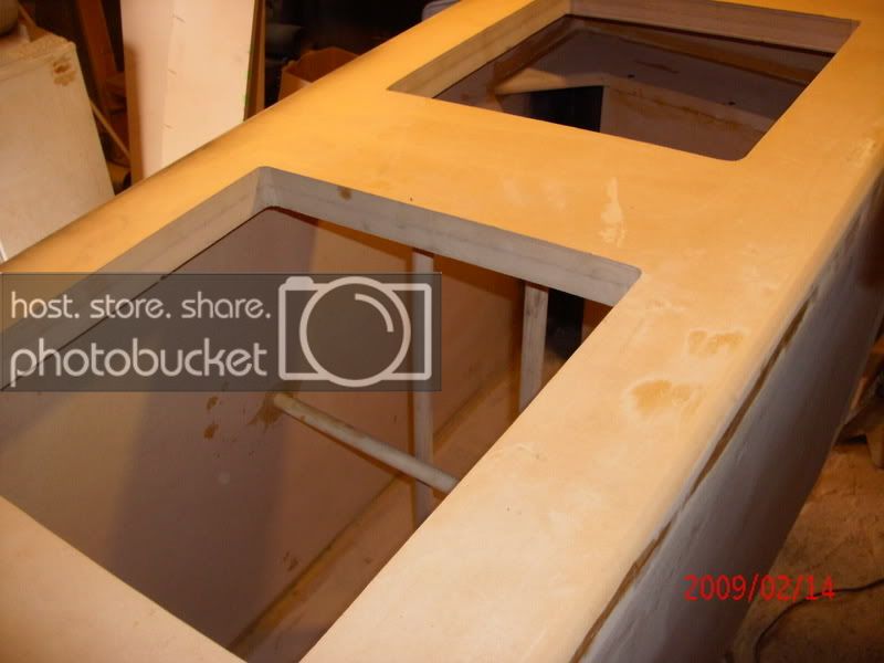

subs are angled slightly forward. port back. going in a yukon. will do the bracing and baffles tomorrow. he didn't want to pay for a double baffle, but i'm going to add a piece of 1/2 inch mdf i have laying around, making it a 1 1/4 inch. bracing with 1 inch dowels. painted textured gloss black.

Lol No double baffle. What a cheap ***
1 1/4 should be enough with the extra 1/2 inch, but i'm not cutting in to an 8 foot sheet of 3/4 for free. i told him i'd use dowel for bracing. i'll use 3 1 inch dowels for the baffle to the bottom, and 2 connecting the front to back. i'll probably end up making about 12$ an hour on this build:crap: better than nothing though.
Nice so far, waiting for the finshed pics though... Definately would have done at least a double baffle though.

well, it is double baffled.......kinda. 1 3/4 inch, and 1/2 inch. should be ok if i brace it good.
