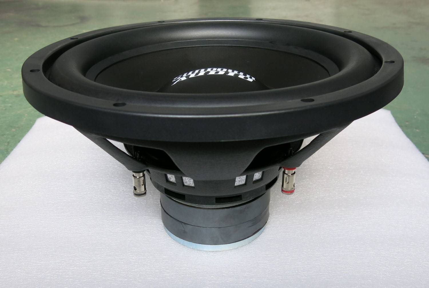

I started talking about doing this line back in November on Facebook then on CACO. I decided to take it all the way to the prototype phase -- this is what I came up with so far. We are talking $60-70 MAP on these from a dealer //content.invisioncic.com/y282845/emoticons/smile.gif.1ebc41e1811405b213edfc4622c41e27.gif

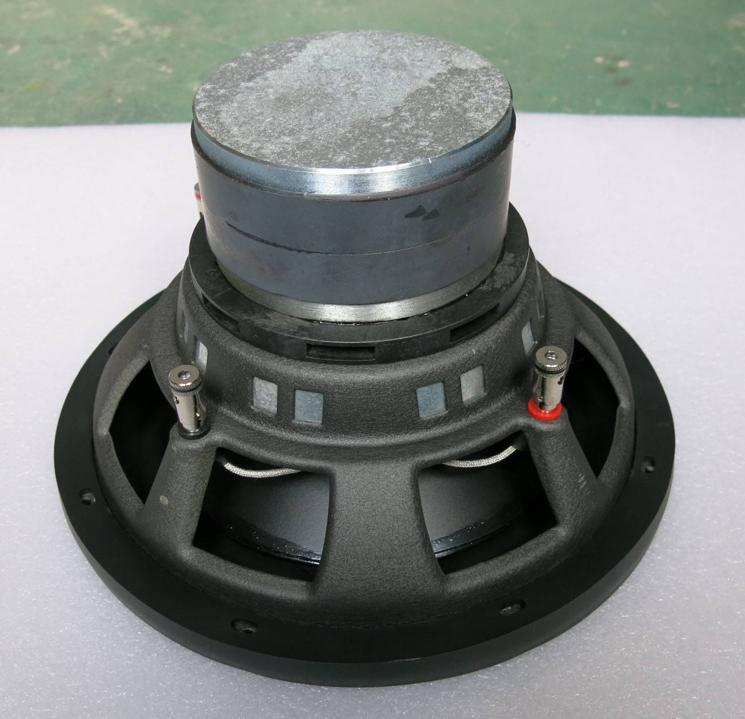

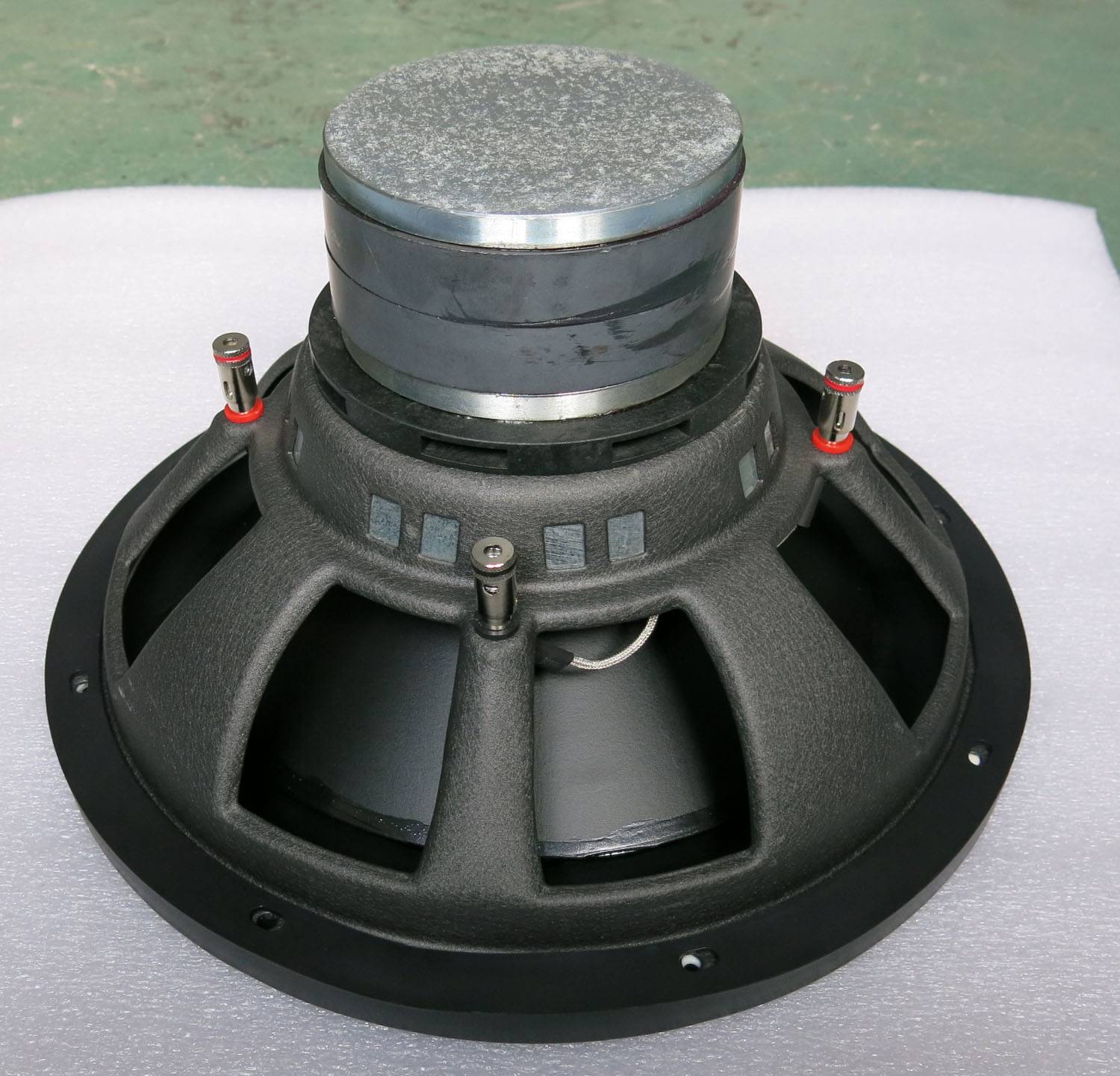

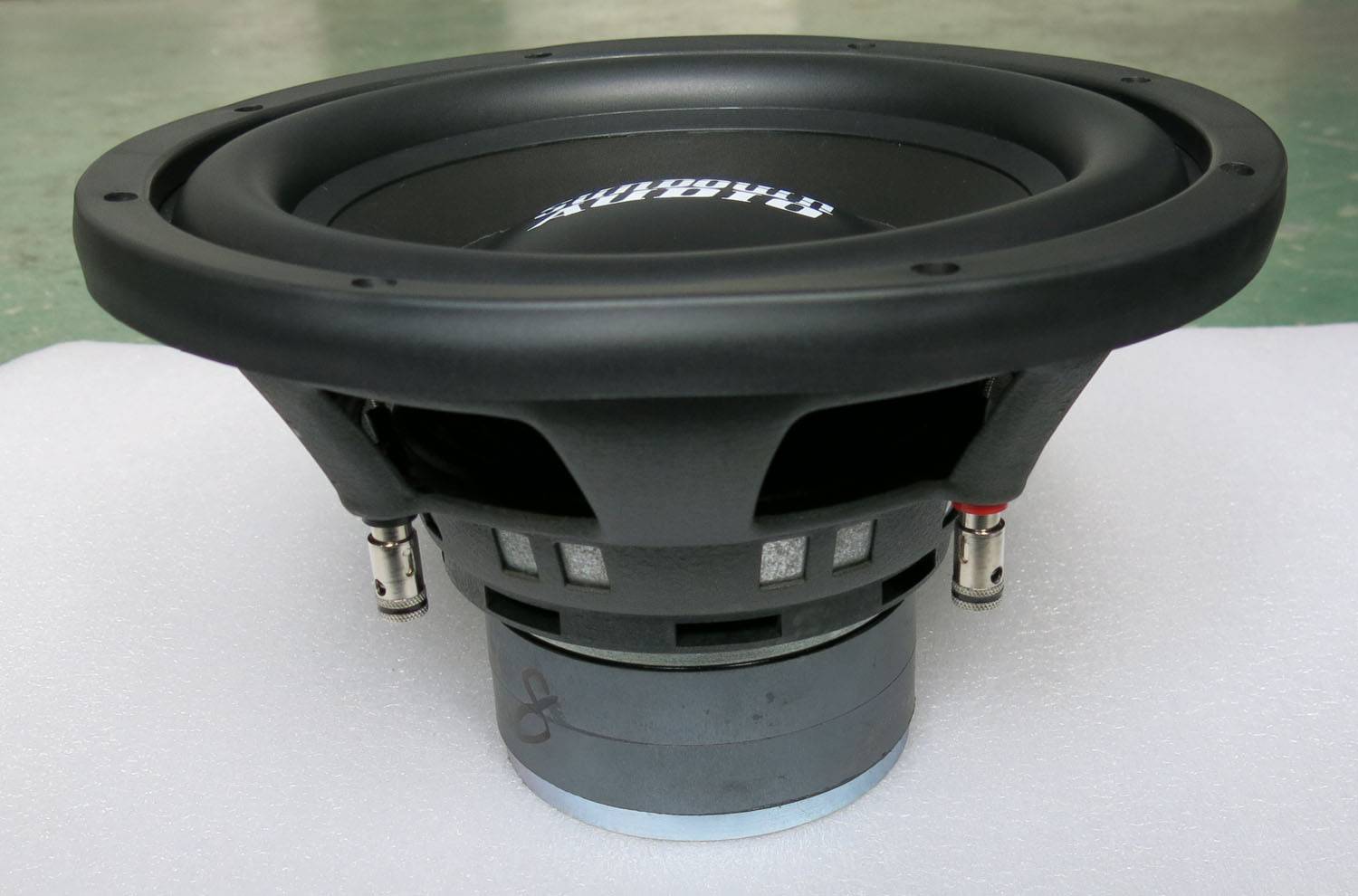

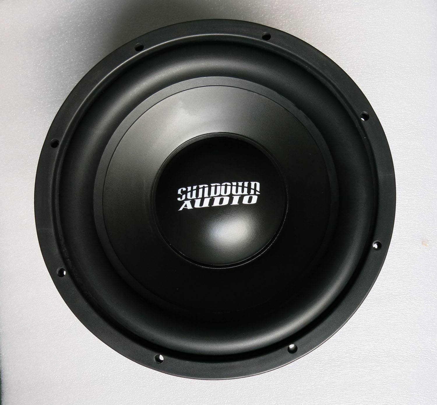

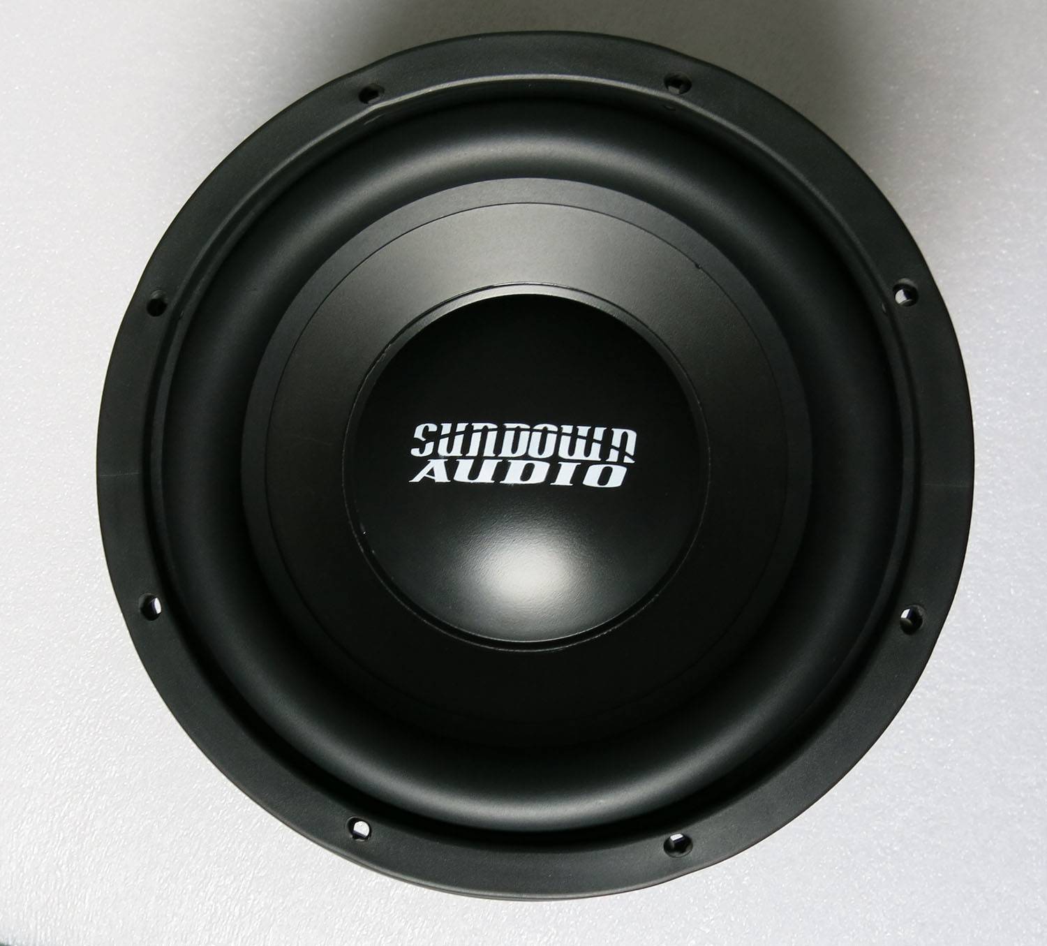

Here are some initial photos of the FIRST rough prototypes. I am essentially testing for ruggedness and for the soft parts and coil being what I want first. The motor will likely increase in OD a bit if I can't get Qts down with other methods but I started small to ensure we aren't wasting any costs on making it too large off the bat. Had to get a feel for what % I would be off compared to FEA to go from there.
If we go to production the frame itself will have the vents removed -- for the prototypes they are plugged. The finish of the motor will also be a bit nicer but not to the point to increase cost to the end-user. The look from the front is pretty well final. The motor is alot deeper than most in this class to support some legit levels of excursion as well.
10" Model :
12" Model :
