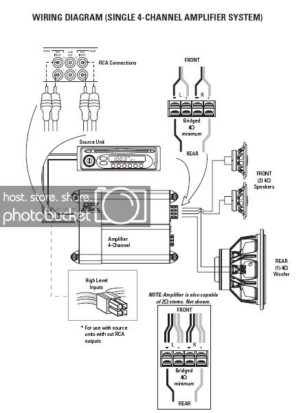

This is what I was thinking:
Components Bravox:
60 watts RMS
140 watts Max
MTX or Kicker sub:
MTX sub: 300rms
Kicker sub: 400rms
MTX amp:
75 Watts RMS x 4 channels at 4 Ohms = 1% THD+N
150 Watts RMS x 4 channels at 2 Ohms = 1% THD+N
300 Watts RMS x 2 channels bridged at 4 Ohms = 1% THD+N
This is what I was wanting to do:
First question: If I do this, what power will I be giving the components and the sub? I looked at the pdf manual, and I couldn't find this info.
Second question: I am trying to save money by doing this, obviously. What I wanted originally was a 4 channel amp powering two components and two coaxials, and a class D amp powering two 12" subs. But, after seeing car audio prices here in brazil, I quickly forgot about that idea. Anyway, the question is.....is this setup (the single mtx amp powering the comps and sub) a good idea, bad idea, OK idea....etc.
