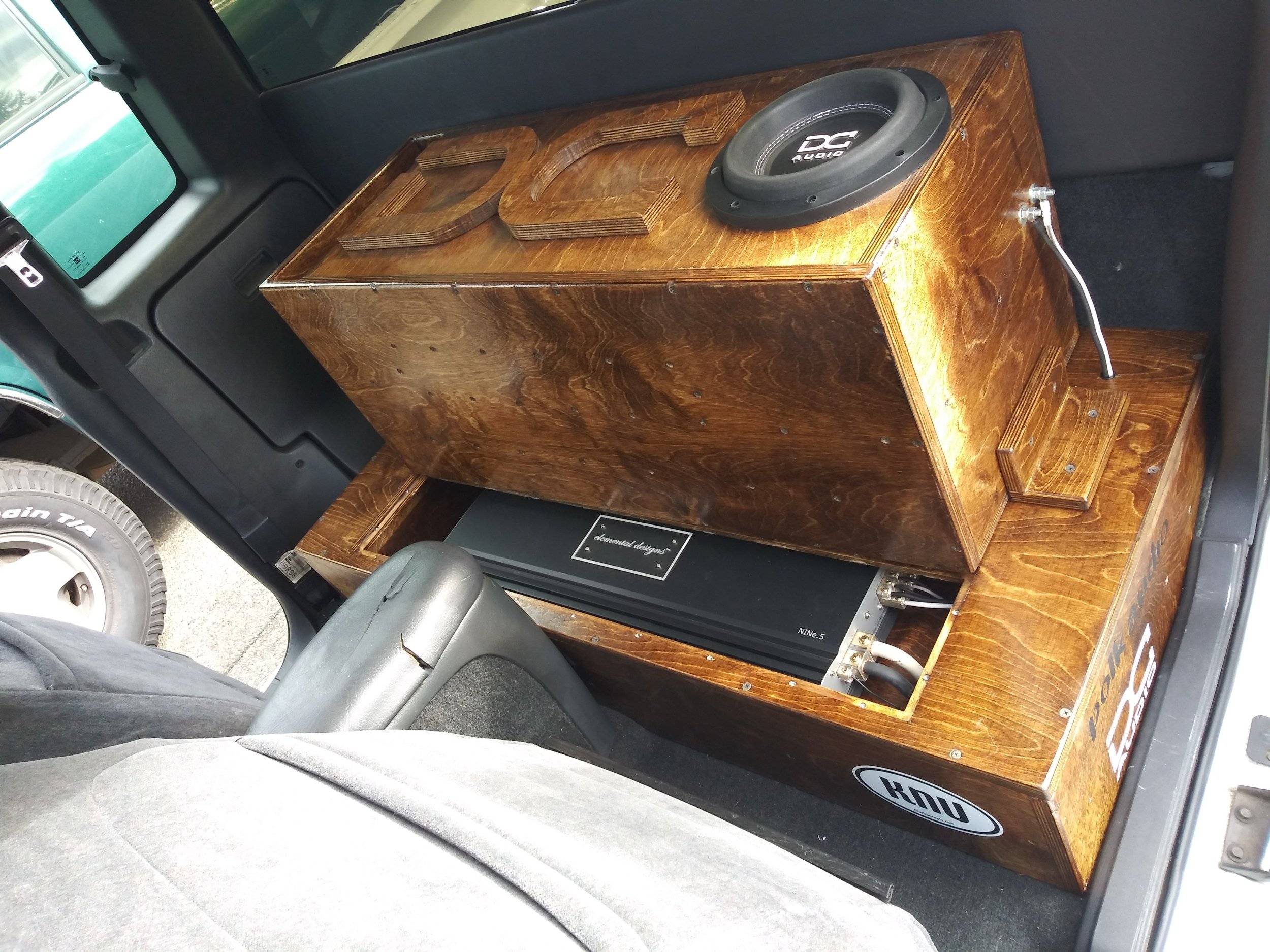

I beg to differ. This is a 5 ch amp and at 27" in length, it'll bust out over 200 watts into 2 ohms and about 1k for the sub ch @ 1 ohm. At the same time, these older ED amps, esp this one, isn't easy to find.
