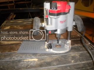

The guide from Jasper does not list all the routers the jig will fit. I have a Milwaukee router that IS NOT on the list. I was going to buy a new router when I ordered my jig. But the jig did have the right holes to fit my router and it works fine.
