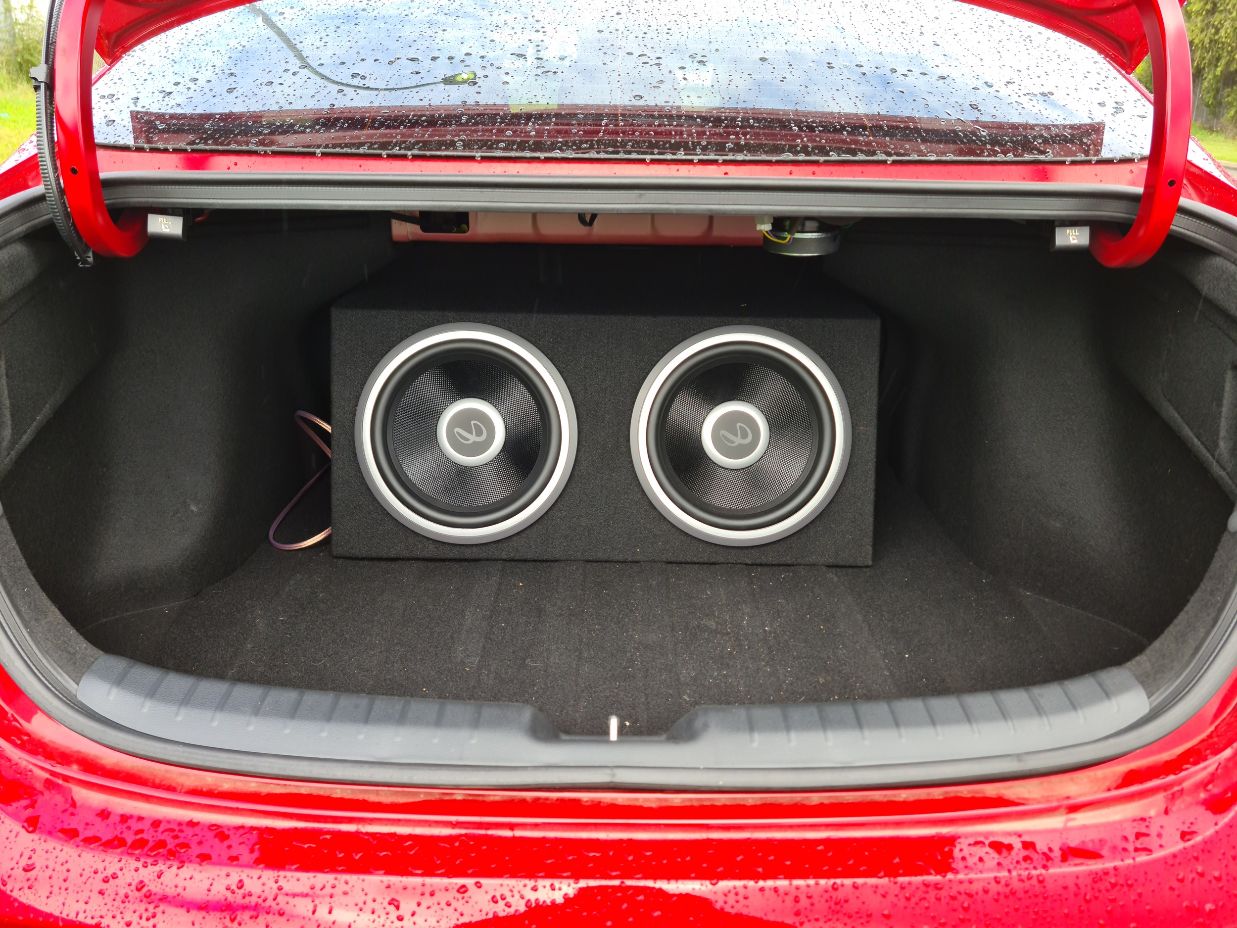

Can confirm that you can in fact fit 0G through a factory grommet. Its a pain in the ass but possible. I will try and get some pics and update this when it stops raining. Everything is installed and all running perfectly
