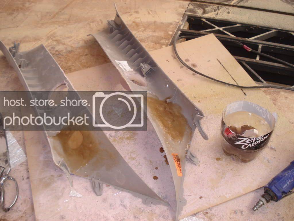

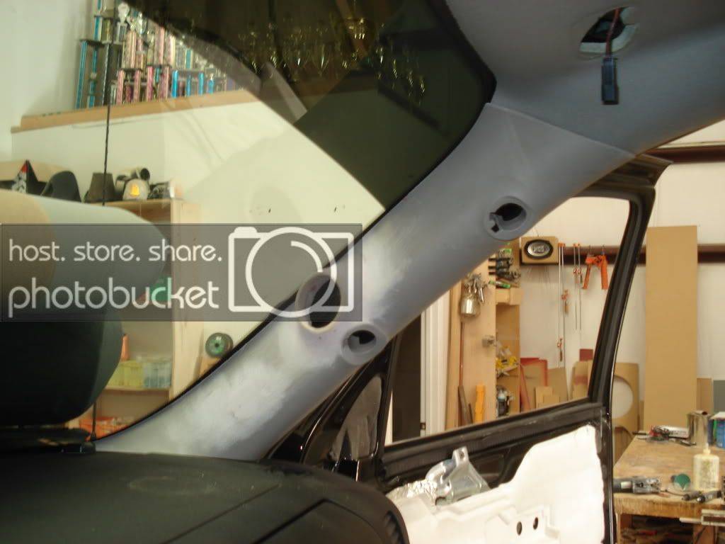

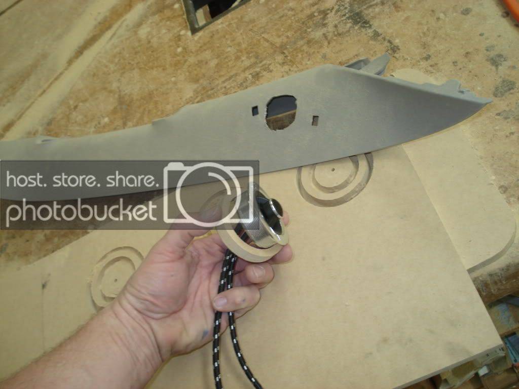

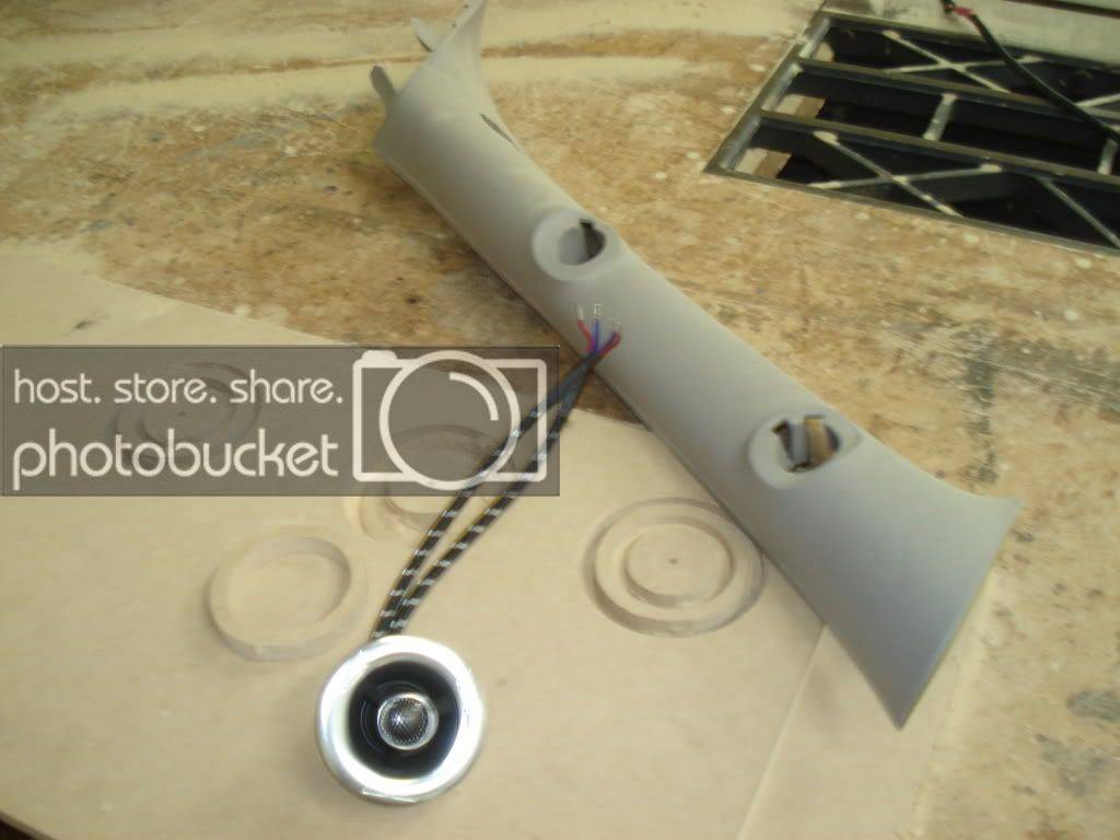

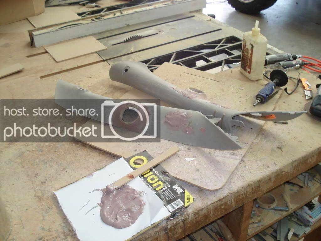

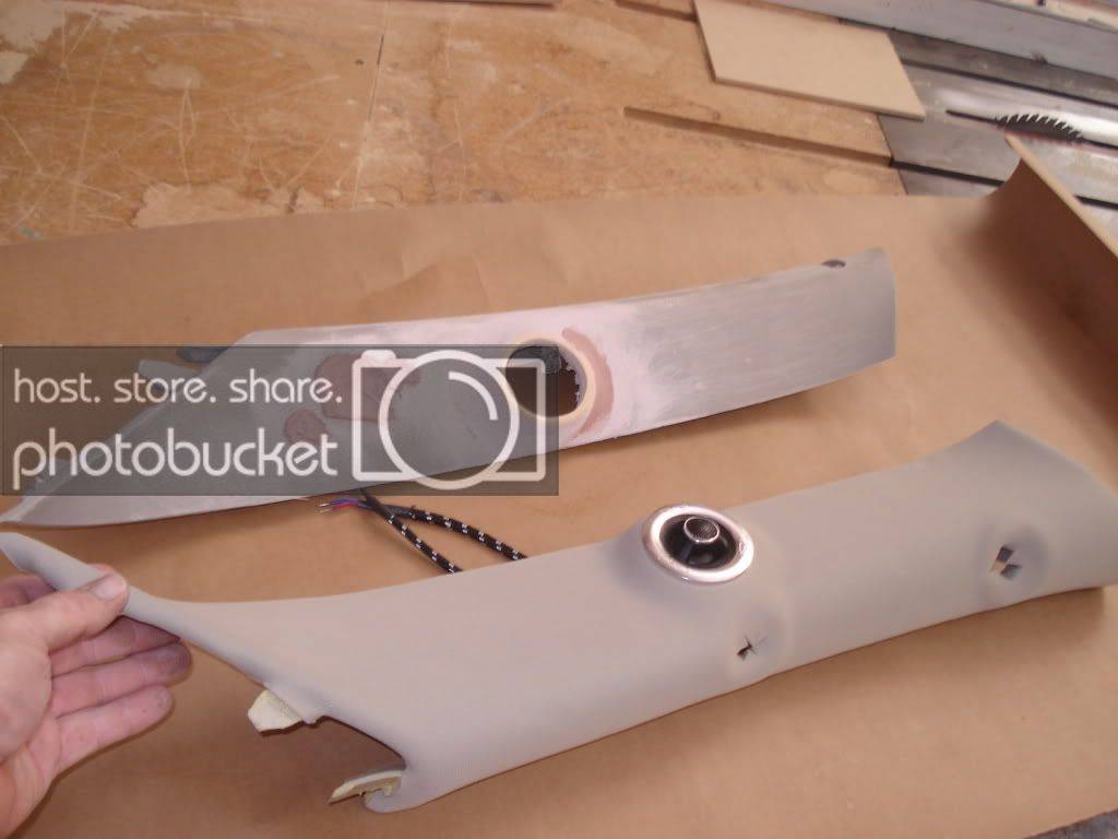

mendon mafia 10+ year member `94 caprice, 15" Fi BTL 2,069 1 Cocoa Beach, FL Nov 20, 2009 #23 what did you cover the pillars with and how did you do such a good job!?!?!?!?!
CranberryYumYum 10+ year member Senior VIP Member 444 1 Indianapolis, IN Nov 20, 2009 #25 it's bondo with fiberglass strands

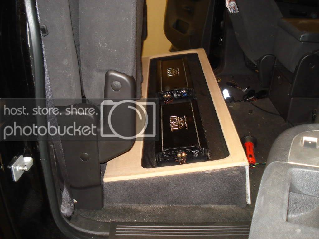

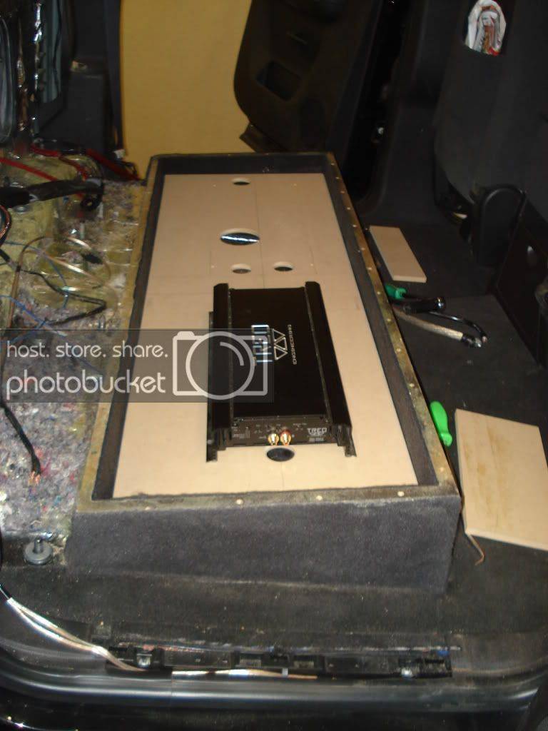

OP zierbox 10+ year member Only The Very Best 672 7 texas Nov 23, 2009 Thread Starter #29 any reason you mounted the two outside subs sideways Click to expand... The only reason the outer subs are turned was to accesses the terminal connection on the speaker
OP zierbox 10+ year member Only The Very Best 672 7 texas Nov 23, 2009 Thread Starter #30 what is that kitty hair stuff in the container?? Click to expand... This is a fiberglass type jelly with thick stands of fiberglass matt mixed in Good for heavy or thick build up, not really good for screw holes (what I had at the time)
