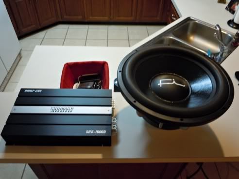

Sub, box and amp
*one 15in FI Q, cooling option and extra spider
*3.6cu ported console box tuned to 29hz
*Sundown SAZ 1500D v.2

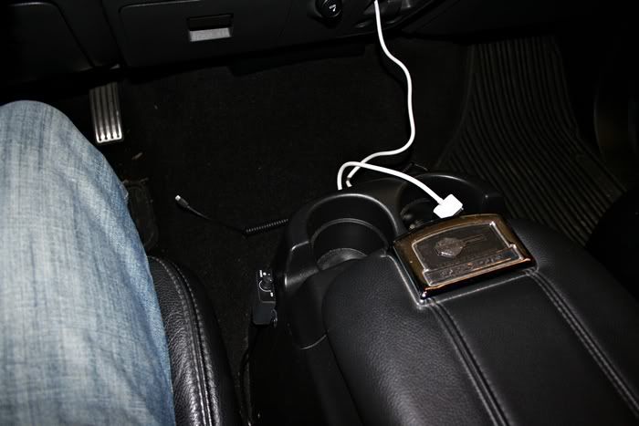

The center console box design between the back seats

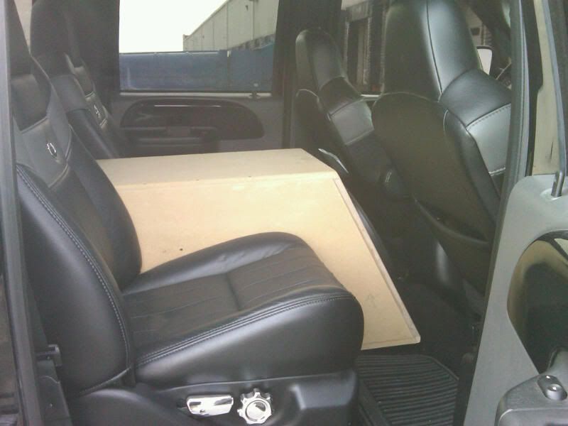

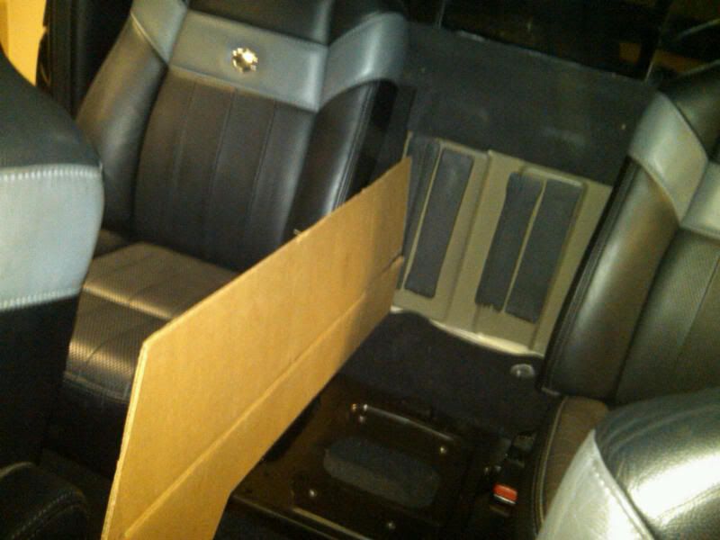

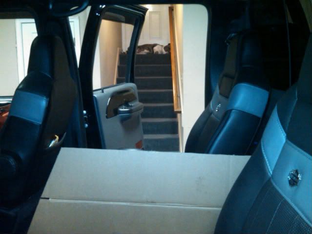

where the new box will be (cardboard mockup)

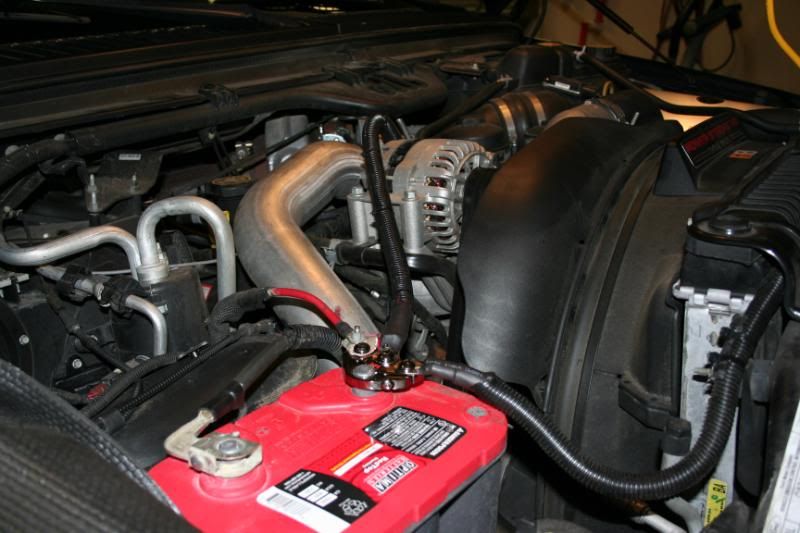

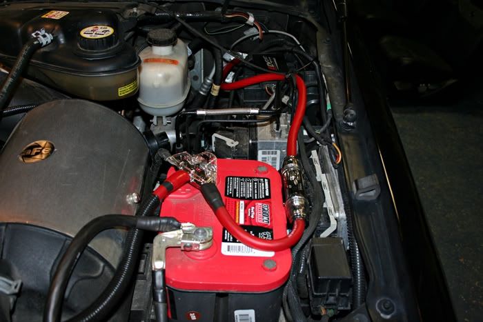

Got the big 3 done, I really like the monster cable terminals

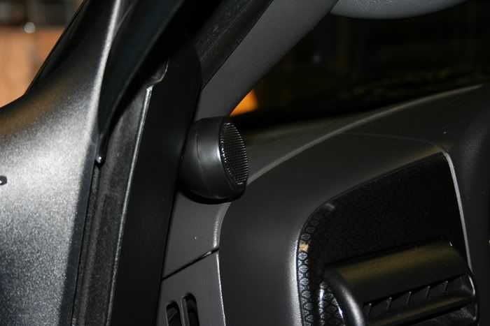

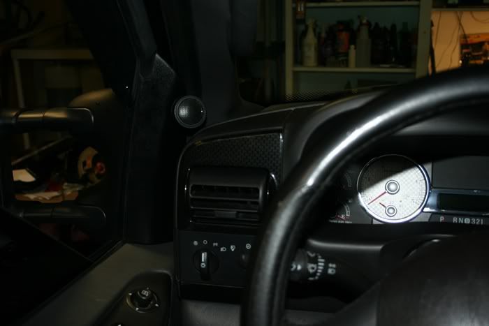

tweeters mounted and crossovers in doors

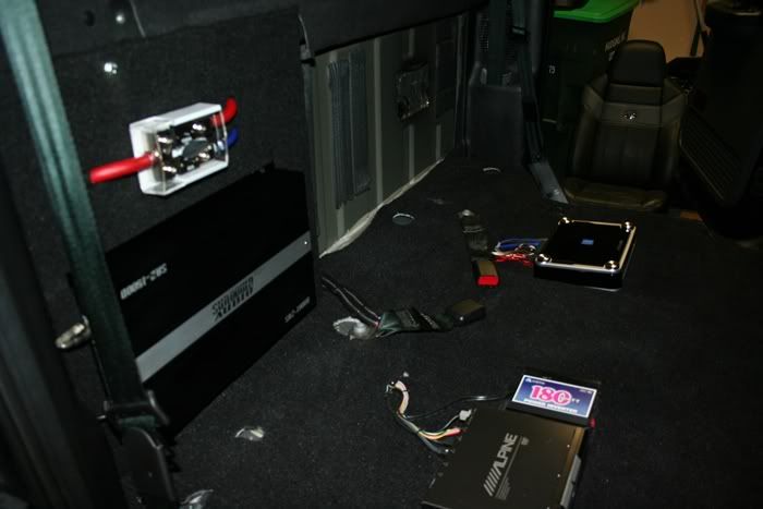

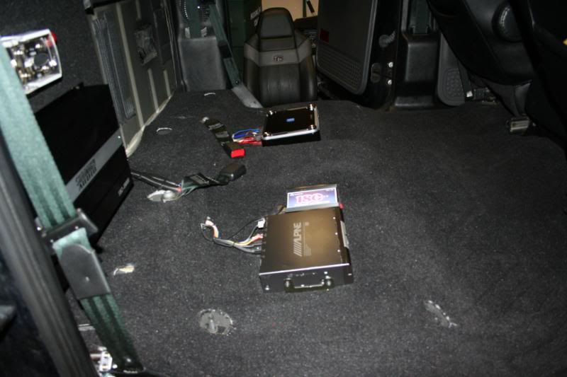

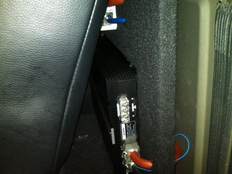

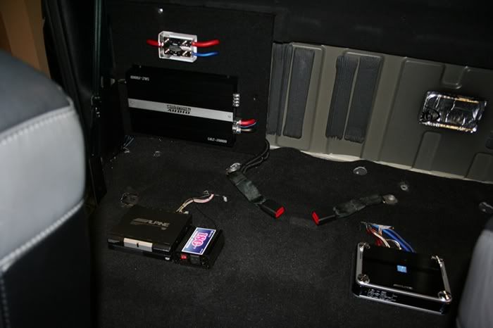

new amp rack for the saz1500 done and mounted along with the pdx4.150, alpine modem and power inverter for laptop etc.

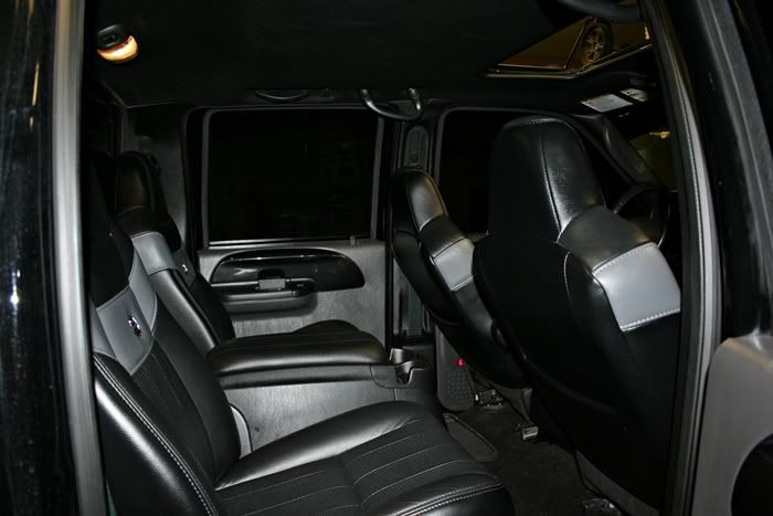

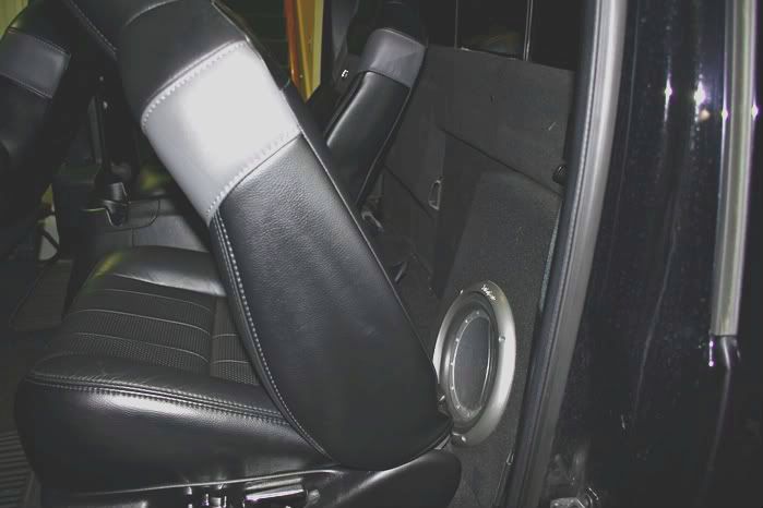

clearance behind seat

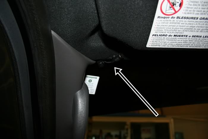

remote gain knob mounted

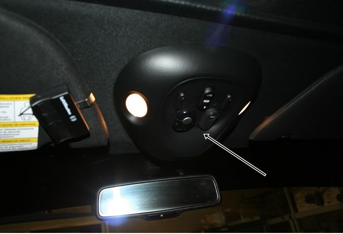

alpine radio hands free and blue tooth, mics also mounted in corner. Luckily these were already done.

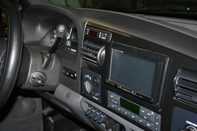

head unit and beltronics radar/voltage meter mounted in dash

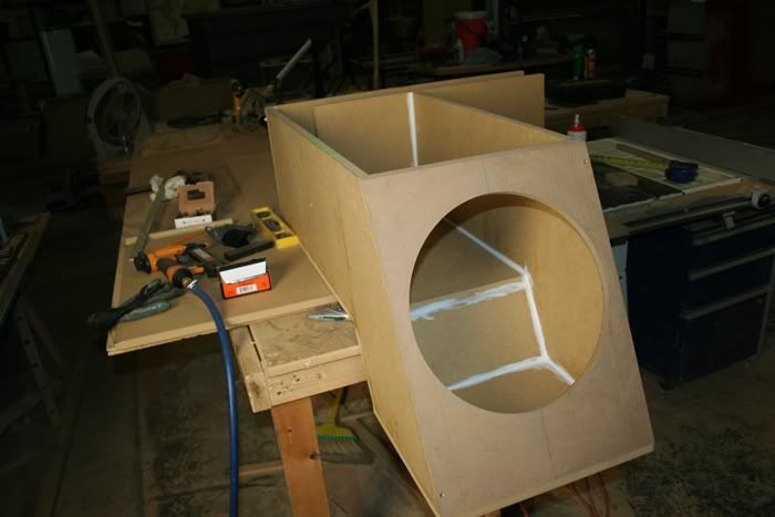

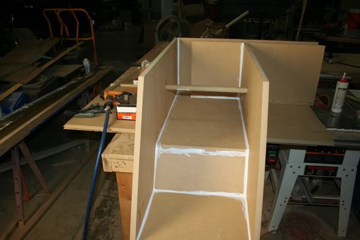

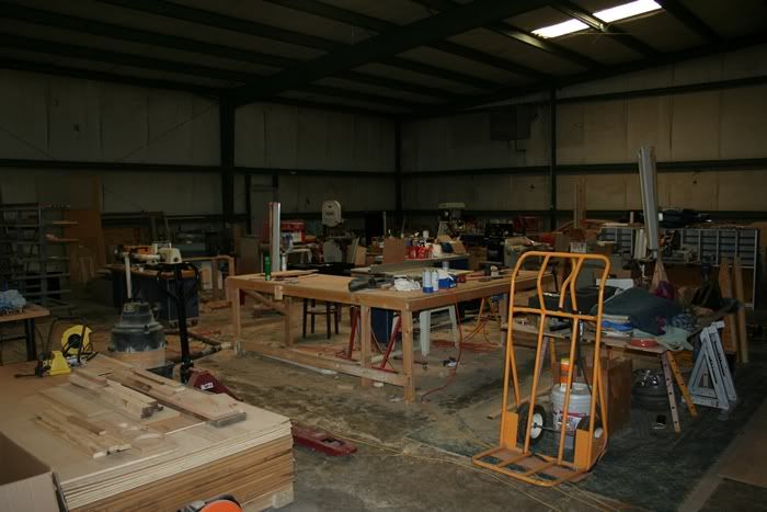

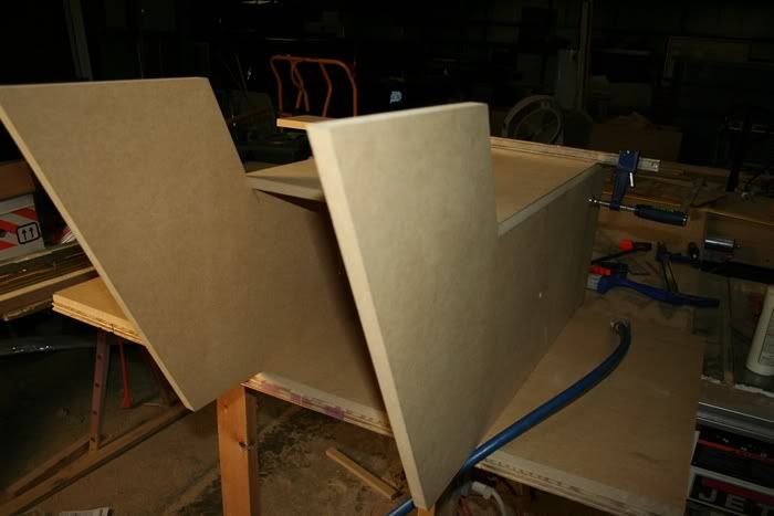

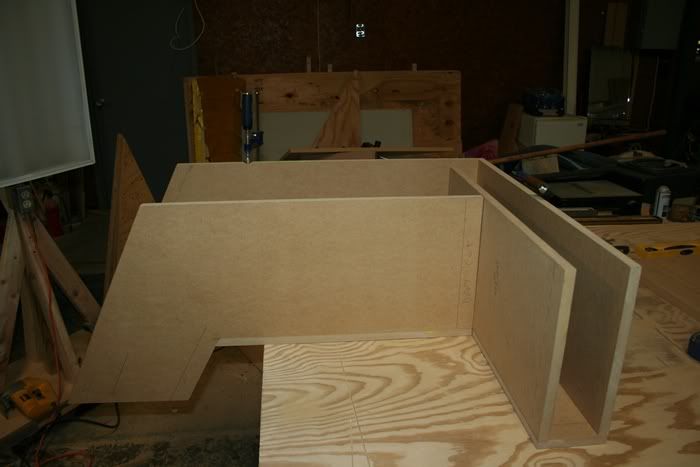

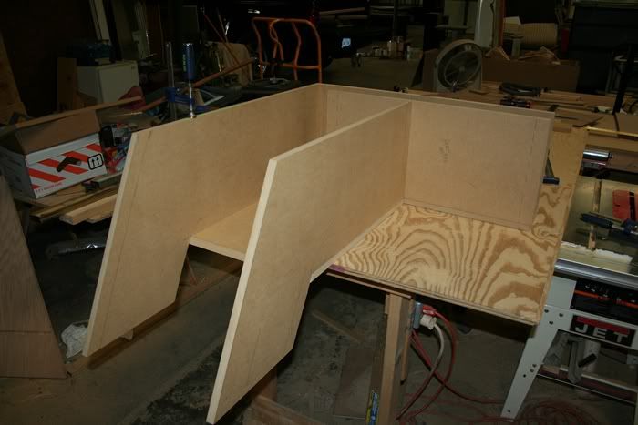

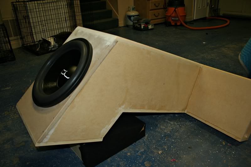

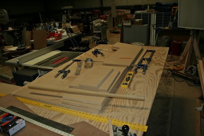

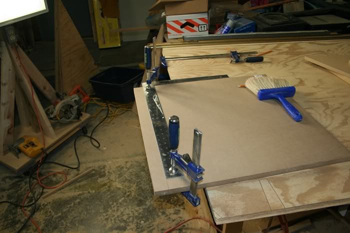

Time to start on the box, my buddy let me use his wood shop

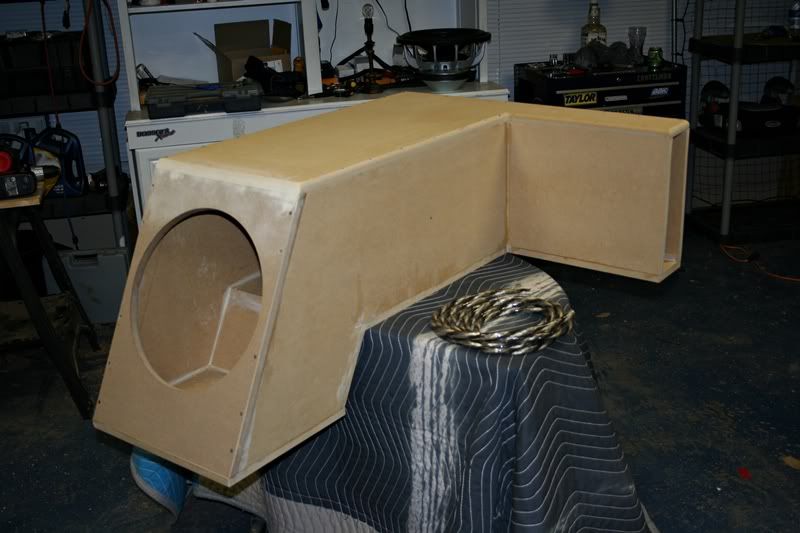

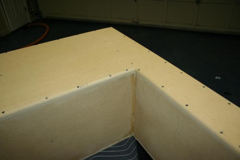

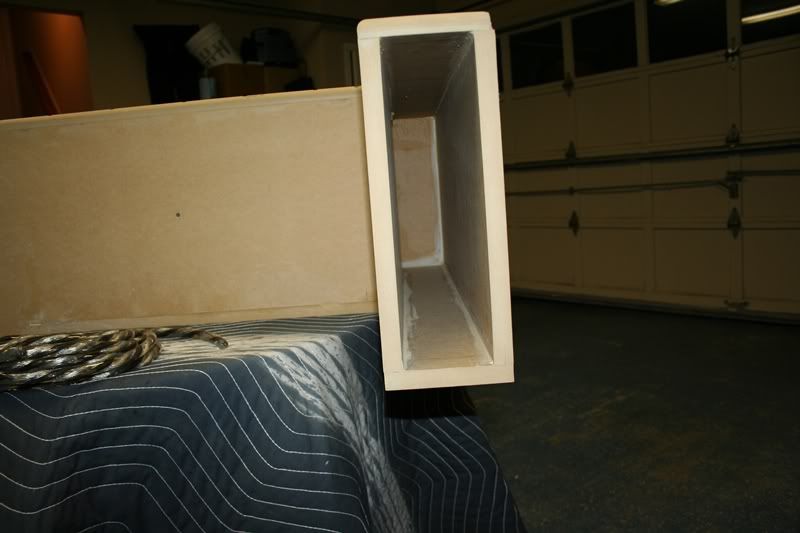

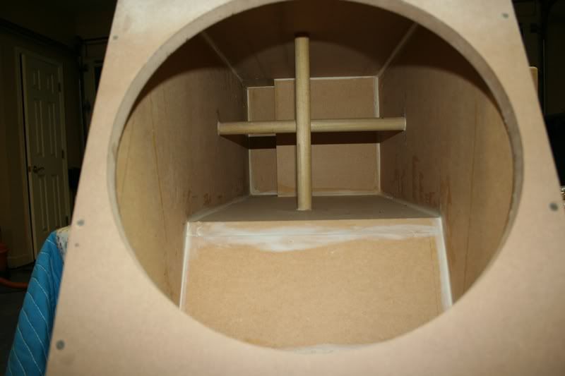

piecing together, 3/4 MDF, titebond wood glue, 1 5/8 screws every 4-5 inches and liquid nails deck and construction sealant adhesive to seal the deal
1in dowel bracing top to bottom side to side

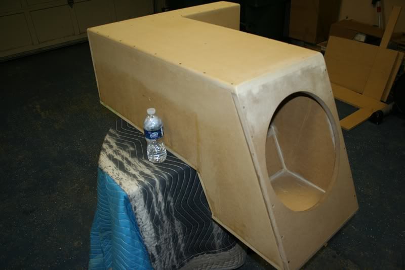

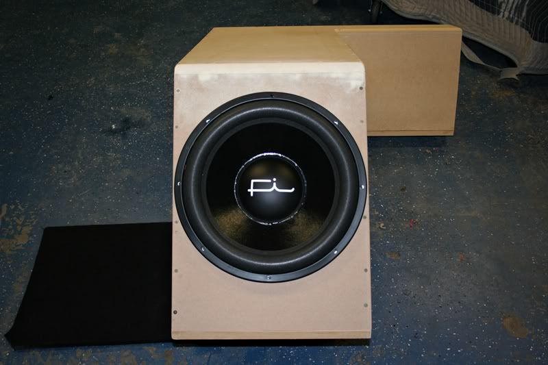

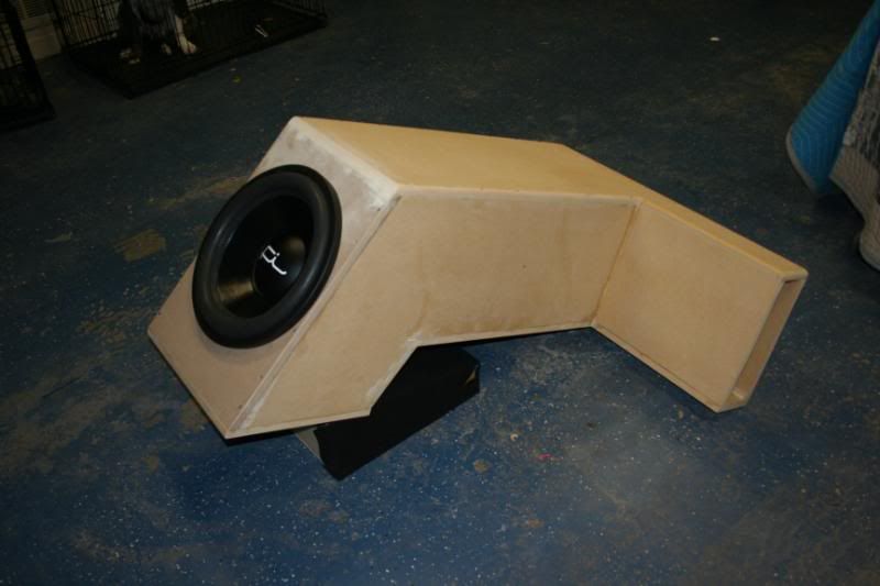

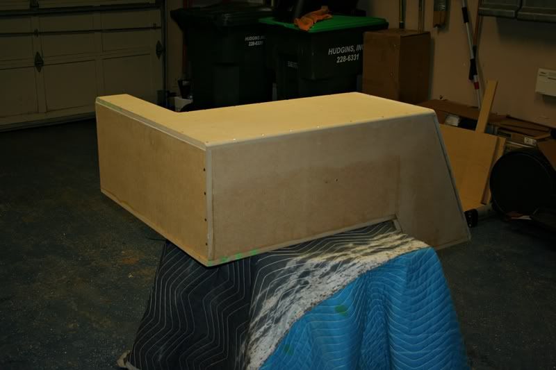

box is done, braced, side rounded, whole box sanded. just need covered

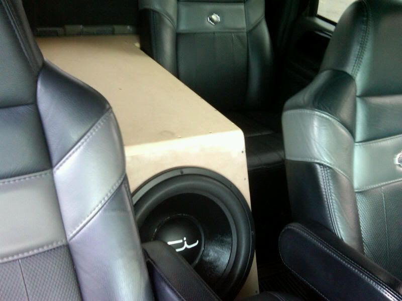

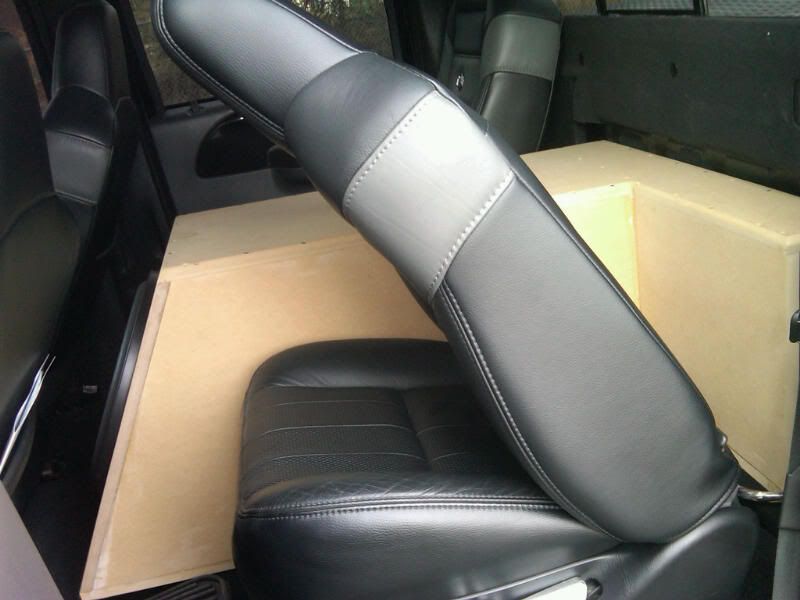

test fitting sub
The box is now in the truck and hooked up for testing and fitment. All I can say is WOW. This things digs very low and hits extremely hard!! I wasnt really going for anything major as far as spl goes but ****! This sub just pounds! All kinda window, door, dash and steering wheel flex, lol.
I guess I wasnt expecting that.
I am loving this setup and will get more pics up soon!

how did u mount the tweeters? with whatever it came with?
need pics of it installed
very nice, very jealous, i wanna do same thing just havent done it yet =/
You are local to me. I have a office in LaVergne
They are mounted with the cup mounts that came with the tweeters. For 59 bucks from Electronic Express they are a deal and sound good. Maybe too in your face for some people but the suit me well.

is ur buddies wood shop local as well or na?

His shop is local, I would have to see about using it again. Its very hard to line it up and had the time scheduled for a few weeks in advance.
