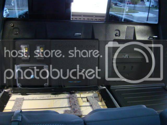

I have a custom box built with a shallow mount sub in it behind my rear passenger seat, and I'm just not satisfied with it. I'm sure it's because of the small box size, but I am kind of stuck with that since there is not a lot of room behind the seats in these vehicles.
It seems to sound very "hollow" and not very deep and full like my other systems have been. I have stuffed the box with polyfill, tried every tuning option I could, and I'm just not figuring it out. Do you guys have any advice?
Here is my equipment and a few pictures.

How big is that box? It looks small, and it looks(honestly) like it's even smaller than we're seeing, there's just cutouts for where wire goes in to hide it. Looks like they could have extended it further and just cut-out for that bracket.

most thin subs require .8 or so ft3 looks like you got that what powr? anddoes it clear the seat when you pound it almost all thins want 1.5 to 3 inches free air in front

I'm not sure exactly what the airspace of that box is. But I know it's small. Smaller than I wanted. The shop that I hired to do it did not do what I requested at all - not even close - and that is why they gave me the Alpine amp for free, to make up for it //content.invisioncic.com/y282845/emoticons/smile.gif.1ebc41e1811405b213edfc4622c41e27.gif

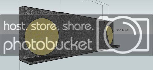

This is what I had originally drawn up in AutoCAD - I was going to build it myself but I got impatient waiting for myself to get out and do it so I just decided to go have somebody do it. Do you think this design would be better?
This was going to be one complete box instead of two seperate parts, and the space behind the amp was going to be airspace as well to make the box as big as possible. The amp displayed in this drawup was originally the Kicker zx700.5 that I had.

And as for how much space I have for between the seat and the sub - since that picture was taken I have taken off the back panel of that seat so it frees up a little more space. I would say there is at least an inch or two of space.

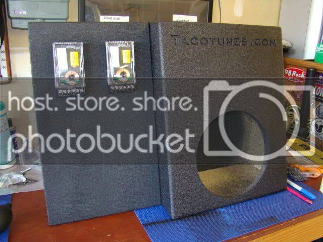

Here's my set up in my '06 Tacoma Double cab.
.55 cuft box with an Image Dynamics IDV.3 10" sub and powered by the same PDX5 amp. Also have some polyfill in it. Mine hit's pretty hard, nice deep sounding bass. Nothing that's overpowering but definetely not a hollow sounding sub and box.
The box is made by Tacotunes and covered with Line-x. I made the amp board attached to it for my crossovers and amp.
