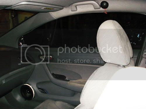

the headlights are stock....as far as tweeters there is a good place to mount them at each kick panel....that far corner dash is a bad location //content.invisioncic.com/y282845/emoticons/frown.gif.a3531fa0534503350665a1e957861287.gif I'm trying to decide between a set of Excelon componets or Critical Mass coaxs...I have both sets here....

how deep are the civic doors
i couldnt get Phoenix Gold Rsds to fit my accord. //content.invisioncic.com/y282845/emoticons/frown.gif.a3531fa0534503350665a1e957861287.gif

you can fit 2 3/4" MDF spacers to stay within stock grill so you've got over 4" mounting depth
i have 4 3/4" spacers on mine and removed the stock grill
i just repositioned the tweeters here.. i tried every spot and this sounds amazing, haven't cleaned up the MDF dust yet, or covered the wire
