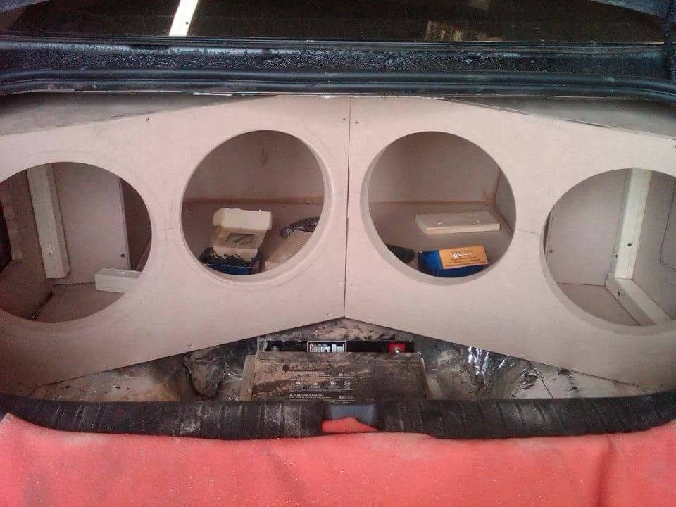

i have 04 gtp but i just have 1 12 u should see mclericos old grand prix wow.. yeah cscstang makes killer boxes
I did a 99 Grand Prix forward fire. Pulled the seats and carpet and drilled out all the welds I could to remove sheet metal from the back. 2 RE SX 15s on 2400 rms in 8 cubes at 34 hz and it was loud af. I miss that car so bad.

yeah i had 2 orion hp ported for 3 yrs and i got same inferno spoiler he had on his (don't think it was in pic) and it cost like $500 painted and installed subs rattled trunk so bad i took it out and used 1 for next 5 yrs just sold both couple months ago.. port and sub firing into cabin don't work for me (i never sealed it off though) guy here said his only worked with port on side and u need a couple inches free in front of port.. so i'd say make box fit back seat opening then make wider at back for more cf and do port on back box wall out the side
