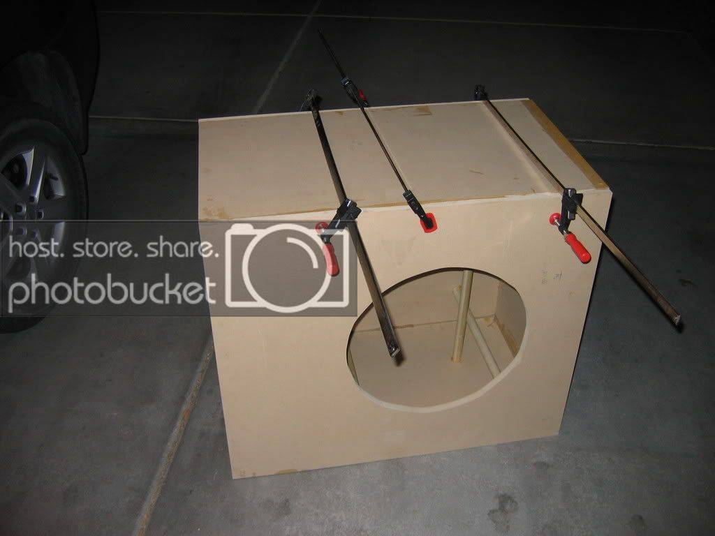

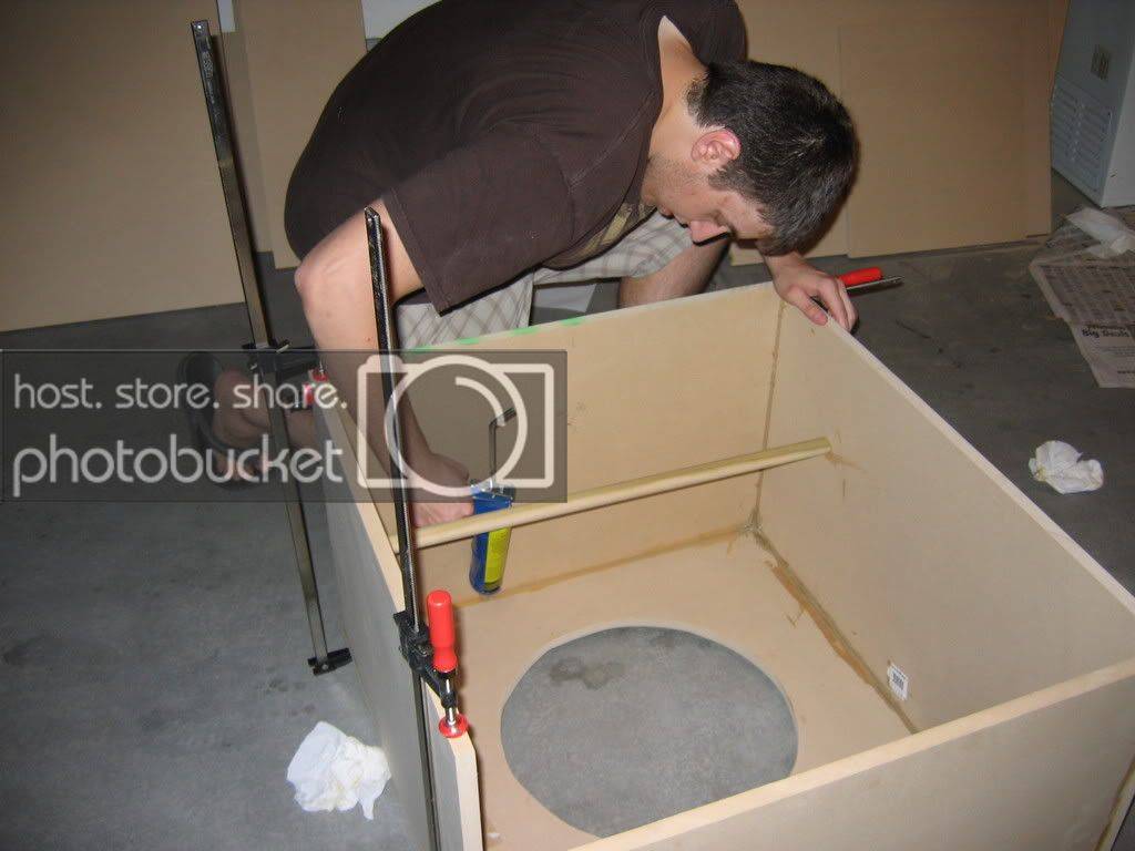

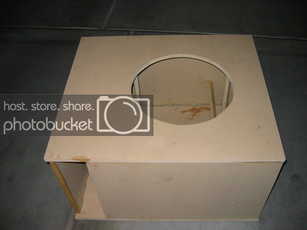

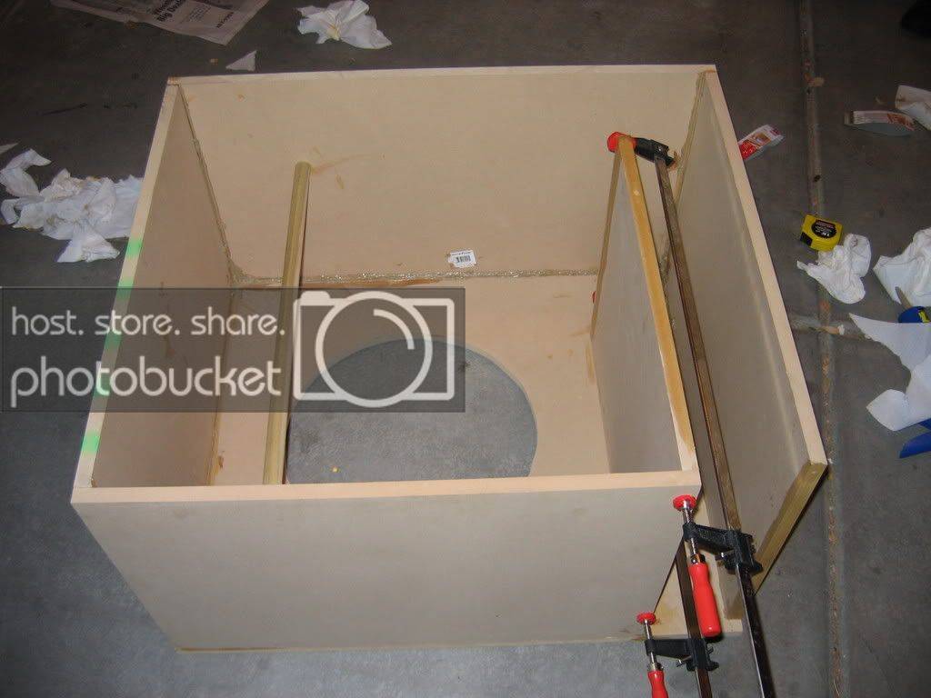

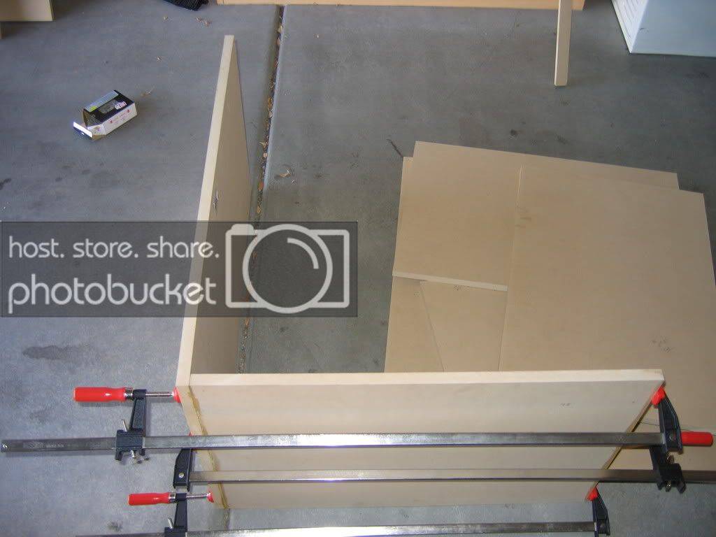

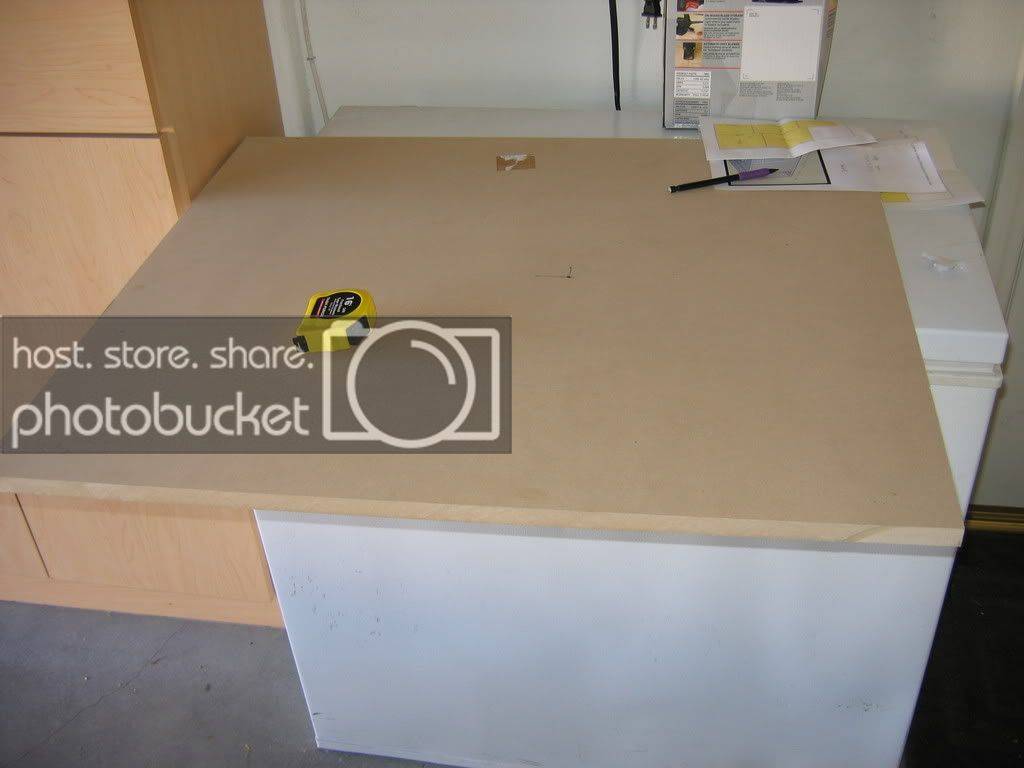

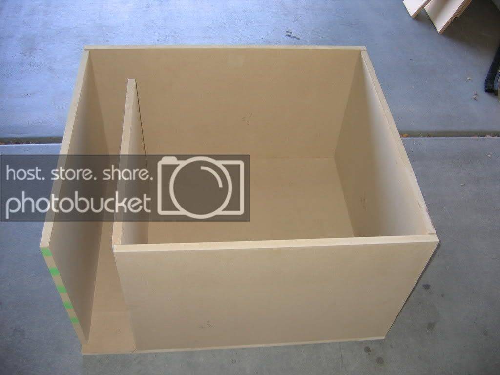

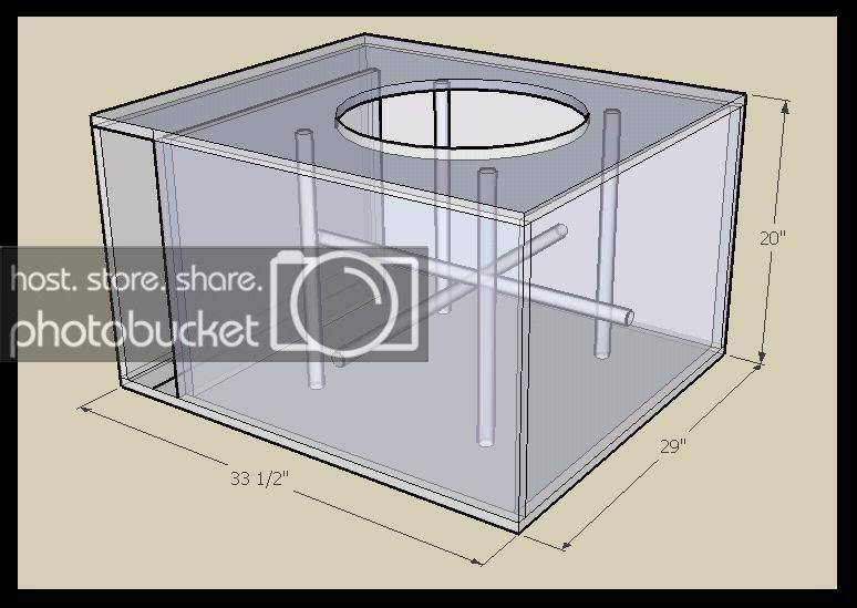

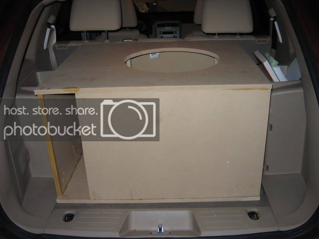

Well I finished building the box, besides Lowes not very good job at cutting wood (the very end up the left side of the port is probably 1/2 inch short), I think it came out pretty nice considering it is my first box. It is 7.75 cufeet tuned to 30 hz. Well here it is-
The design by BuckyBoy

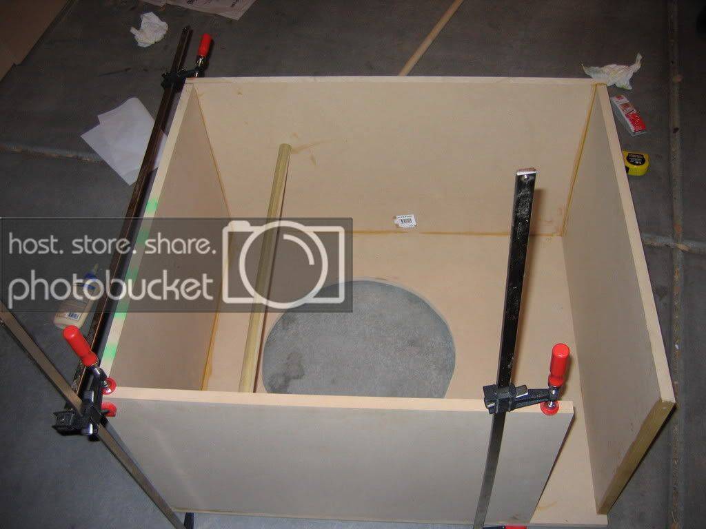

Setting it up seeing how well all the pieces fit together
Doing something

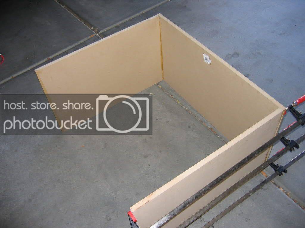

Putting it together

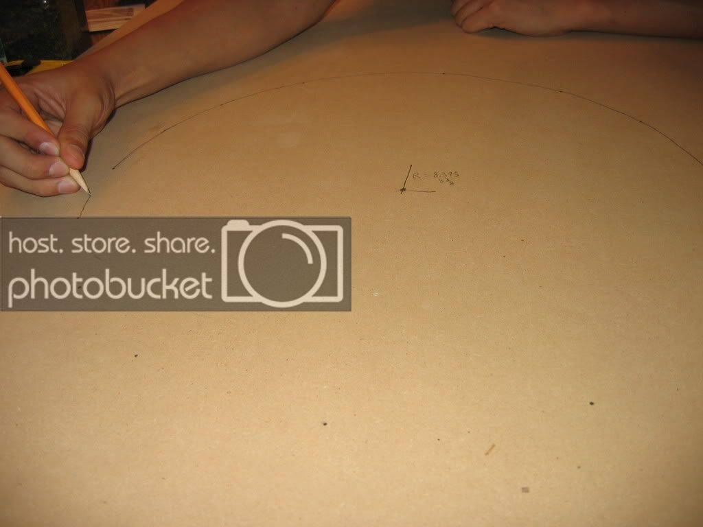

drawing a hole

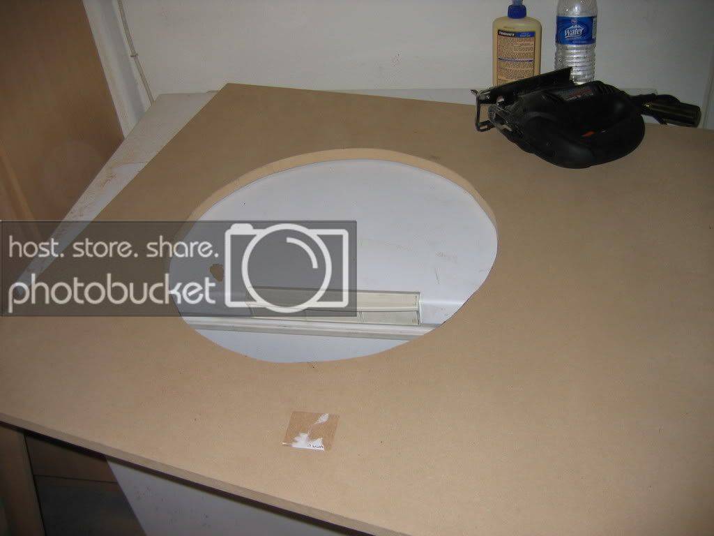

Cut the circle

Finished box
Fits PERFECT in my car and couldn't have asked for anything better
I will eventually carpet it or paint it //content.invisioncic.com/y282845/emoticons/fyi.gif.9f1f679348da7204ce960cfc74bca8e0.gif.
Nice, U dont use screws?
Nope I used titebond II, clamps, and construction caulk
