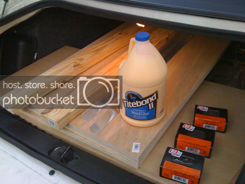

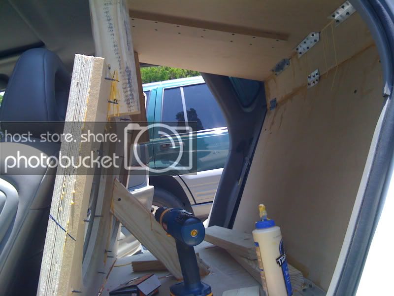

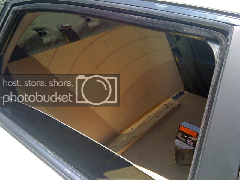

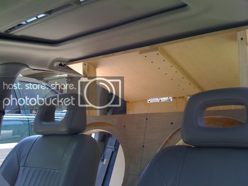

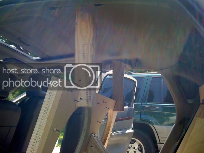

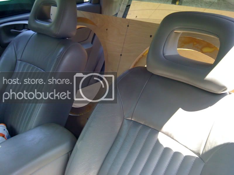

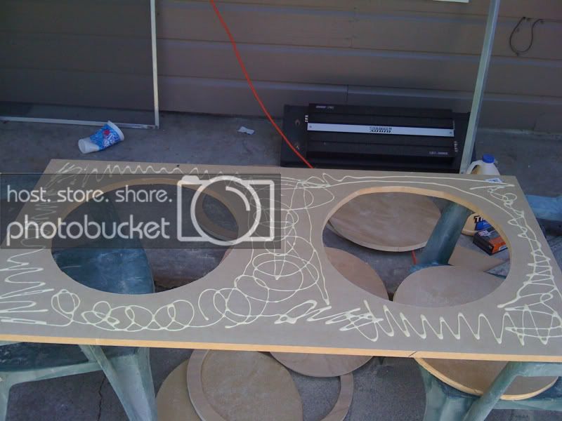

started on this yesterday. 2 dc lvl 4 xl 18's
keep in mind this is no where near finished..the inside will be just as pretty as the outside //content.invisioncic.com/y282845/emoticons/smile.gif.1ebc41e1811405b213edfc4622c41e27.gif. input?
box will have a LOT of flex and probably fall apart unless you plan to double up all the walls and add proper bracing. Your 2x4's don't mate up very well, so the glue joints will be very weak. You have solid *** subs, so make it as strong as possible...
What's net size and tuning?
fiberglass my friend. like i said its not finished yet i still have to do the port on top a few more 2x4's then i will liquid nail all joints then fiber glass...rage extreme then maybe more glass.
