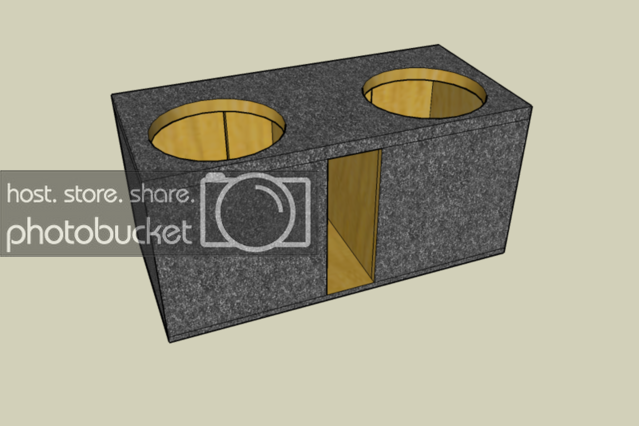

very nice build. but you should of put a hc2400 in front to. even a hc2000 can fit without cutting any metal. nice amp. mine have been very solid for me. what are doing for the box?

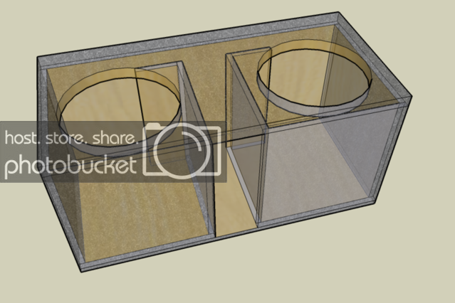

BOX= 7 cubes after displacement
33hz tuning
106.5 sq inches of port

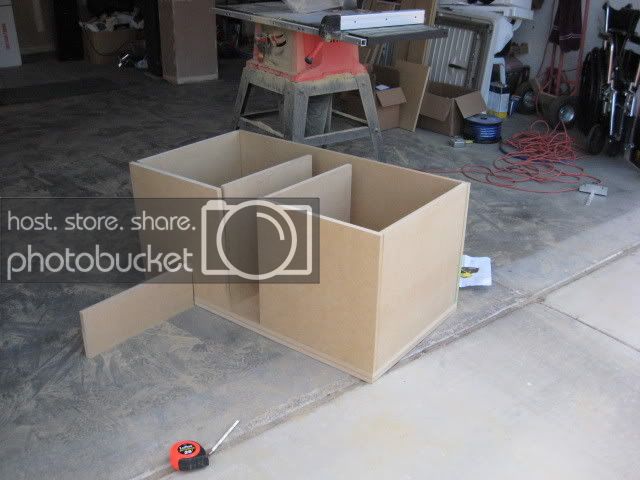

test fit

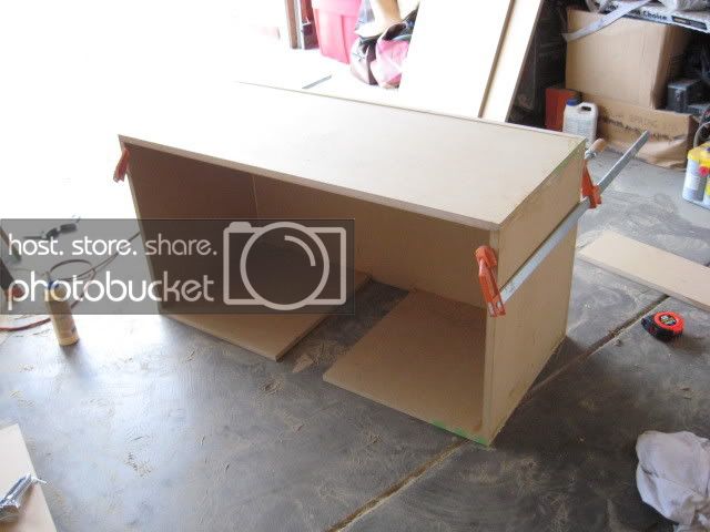

glued and screwed some sides

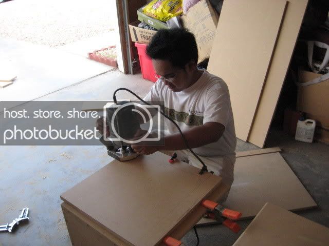

round over the edges

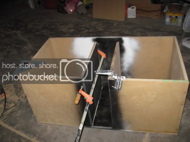

painting the port black
