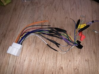

Here’s a picture of the wires that I didn’t know about because the instructions don’t mention them and it doesn’t say anything on the wires.
Thanks again for the replies!

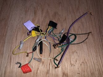

Yes, those are the ones that threw me off as well. Until Deiimos mentioned the Steering Wheel Control wire on the Kenwood harness is Blue/Yellow, that is when I realized the color codes the instructions are refering to are on the radio harnesses themselves. That is something that should have been pointed out by Axxess.
Those wires you pictured last are to be disregarded and taped off. I believe they are for other brands not mentioned in your instructions. I would clip off the bare ends before taping to avoid accidents.

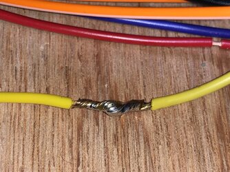

And I’ve always soldered the harness’s together, but honestly I think twisting / taping will be fine 99% of the time if done well.
But here’s how I like to do it for any future readers that are considering different methods; I prefer doing it like this because I know for sure it’s going to be a long lasting connection behind the stereo. (this was from a double din I installed in my truck, I got the stereo second hand so the factory harness wasn't in great shape).
Don't forget to put the heatshrink on first, I can't tell you how many times over the years I've forgot to do it and the heatshrink is sitting on my desk :ROFLMAO:. In that instance you can de-pin that wire from the connector, slide the heatshrink on, then put the pin back in, but an added step you really don't want to deal with. 😭
It is similar to a"linemans splice", loop the wires through each other in a U shape, then back on themselves, twist together, then solder.
Just for reference, but twisting the wires should be fine, just take your time with it and tape them well.

Ok on the wires that needed to be disregarded and taped off… I took all the wires loose from the harnesses and going to start over. lol.. Did that before checking on here for a reply.
