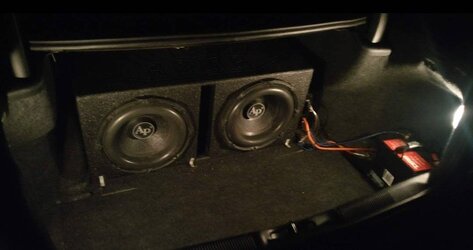

I bought a car used and the previous owner left his sound system already hooked up. From what I can see, it came with the following:
• Two Audiopipe TXX-BD2 12" subs inside a ported(?) QBOMB box. (However the left subwoofer blew)
• 1600w Audiopipe Amp
• Extra Battery that helps support the system (?)
• Stock 4.3 Touchscreen Uconnect Head Unit (Dodge Charger 2013)

The electrical setup is decent I suppose is because it's a 2013 Dodge Charger. The main battery is in the trunk which makes it easy to connect to. It's underneath everything you see in the picture.

he doesnt have the specs listed, but i didnt think that qbomb made too many center ported dual 12" boxes. here is a pic from his google album
I am not seeing specs for the Qbomb box in this topic.  If its the HD212 on their website, that is tuned to 39hz, personally I don't like tuning for music that high.
I'm pretty sure this is the box: http://www.qpowerinc.com/details.aspx?product_id=48 (QBOMB12V)
Well thats why they slam. 40 Hz tuning is brutal.
