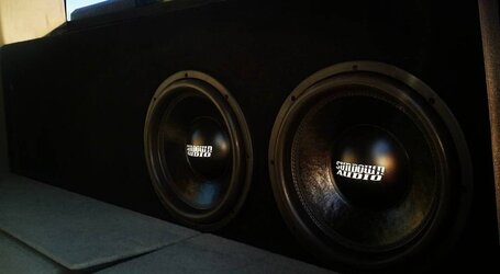

I've attached a picture. Sorry it's hard to see but the rectanglar port is passenger side front.
Wait where is the port relative to the woofers? That pic is too dark and tells us nothing they could be sitting on a black carpeted floor for all I know

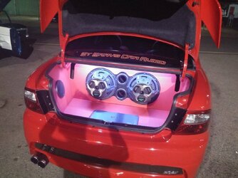

Sorry that is the only picture I had on my phone of mine personally. Here is a picture from netaudios site of one similar to mine to show where the port and subs location is.

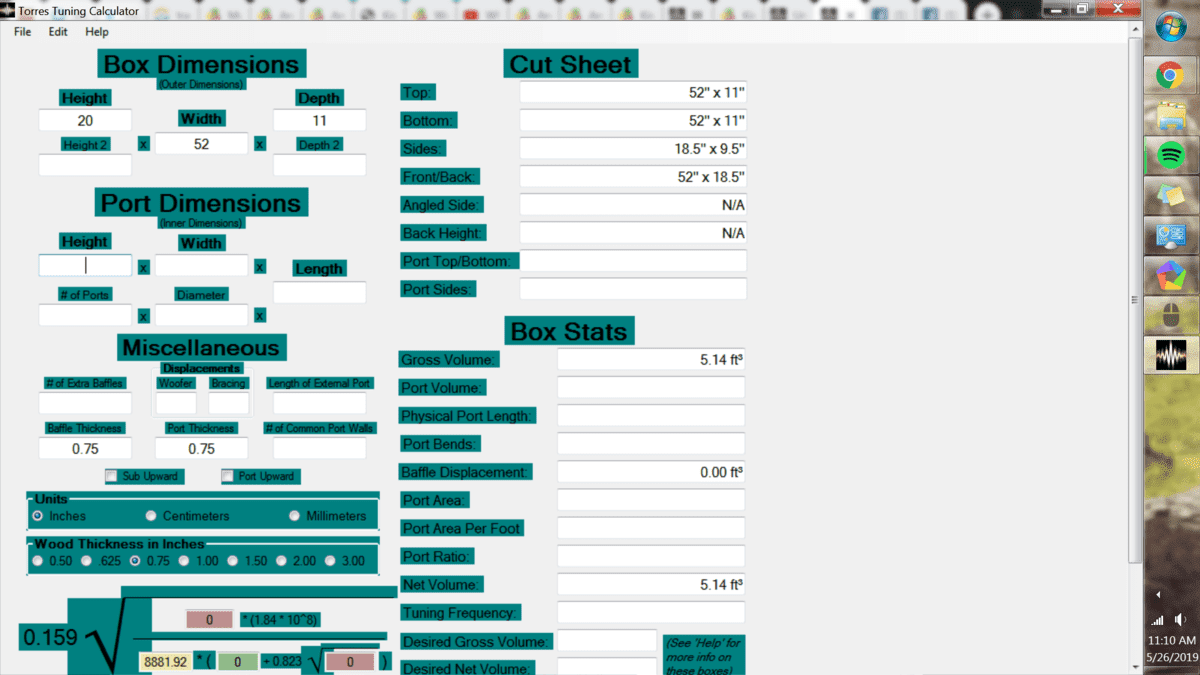

those measurements are no where near 5.25 cubic feet.  its 5.14 before port and sub displacements and it sounds like there's extra thickness to the box as well. I'm pretty sure you are well below 4 cubic feet.  more like 3.5 to 3.75 cubic feet net airspace after all displacement.
Well now I feel stupid. I never double checked I just believed what net audio told me which was 5.25cft. Thanks. I just took actual measurements and its 60" width by 10" up top and 60" by 11" bottom. 18" height.

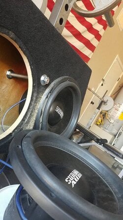

Figured it out. Found out my back and front walls were flexing so braced with some all thread rod. It made a world of difference. Excuse the sawdust I hadn't cleaned up yet when I took the pic lol. Thank for all the input guys
