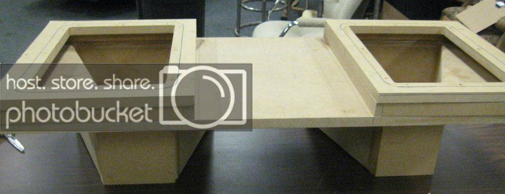

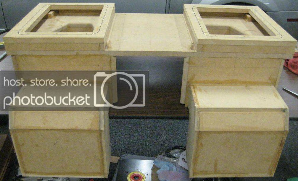

The foundation of the box. It will be replacing what the factory considers rear seats. Had to build it to fit down into the area that once held the seat bottoms.
This will give you an idea of what I'm talking about for the bottom of the box
This was the original concept, boy how things will change throughout the build

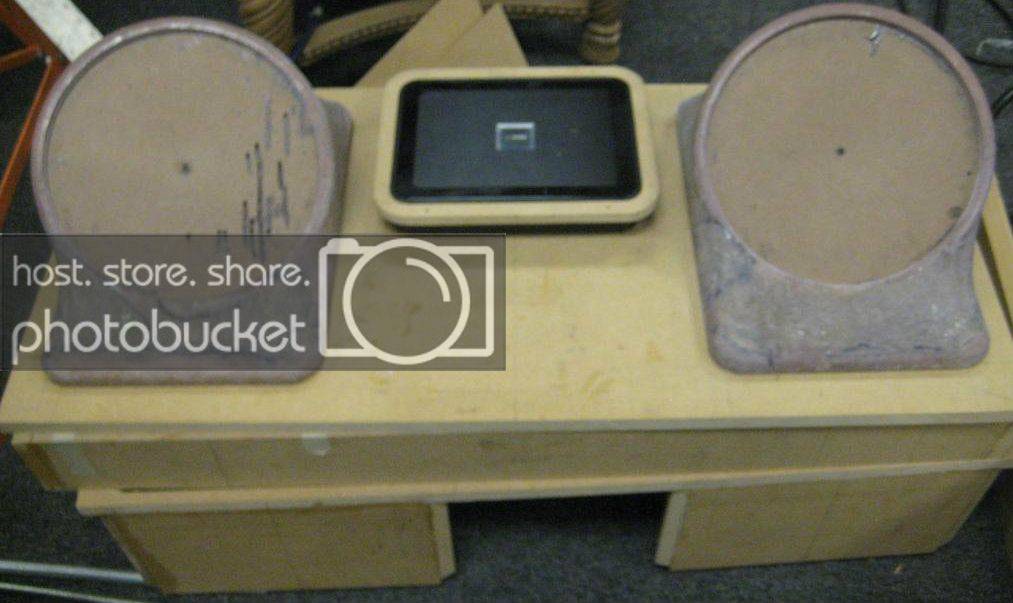

sub pods are mocked up and speaker in place for a quick test fit. Lot's of test fitting during this build. That's a JL Audio WS6 10" sub
Now that I know the magnet will clear the inside of the box, time to start setting up for fiberglass.

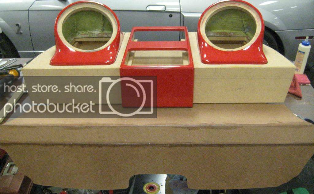

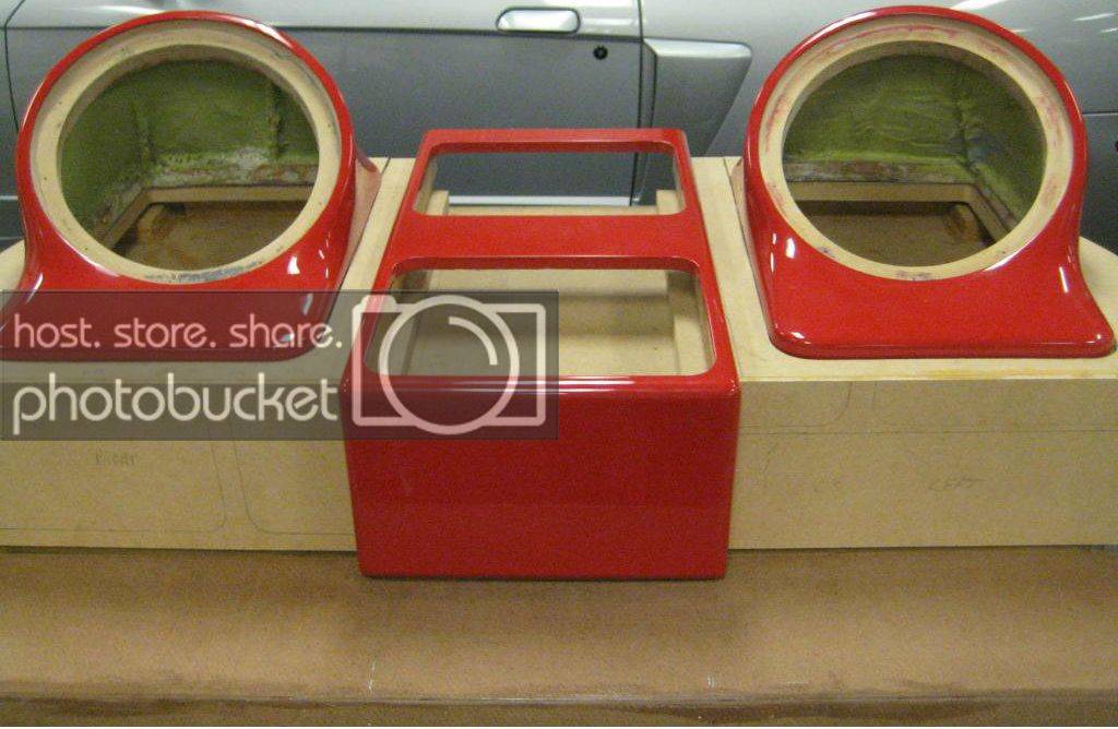

The new box after the alterations were completed

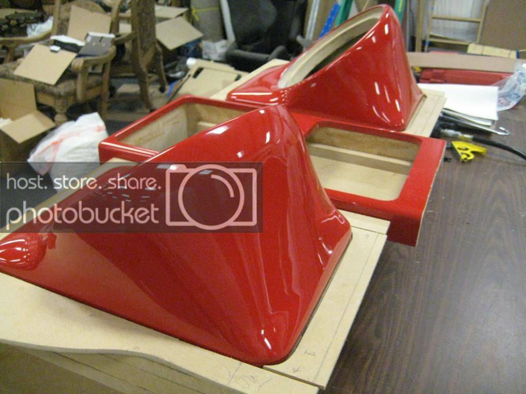

I’m not going to bore everyone with pictures of all the bondo and sanding. Matter of fact it was so boring that I didn’t take very many. But **** it took a long time to get everything smooth. It was a must so that we could reproduce that “just dipped in a can of paint” look. The pictures don’t even do these justice. I’ve actually had people ask me if they were still wet when they saw them.
Thats not a scratch on the front, just the way the light reflected I guess.
You can see the panels in place with this picture. The lower part will be wraped in carpet while the top part will be coverd in suede.
