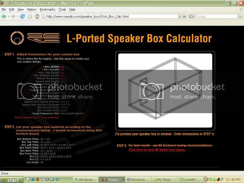

*EDIT* I'm using RE enclosure calculator for the box design
Would you be able to dump in the dimensions or w/e http://www.reaudio.com/speaker_box/LPort_Box_Calc.html for the my best option? I've got this to work with or less: 33" long, 22" deep, 16" high

And how does this look, this is ~3cubes tuned at ~34hz.
*EDIT* What about port area? How does that work? Do I want more, less or what?
Would you be able to plug in some numbers into that calculator so that it looks right to you?

EDIT* What I'm looking at now, is 3.3cubes tuned @ 34.8hz with about 54 for port area. ??
