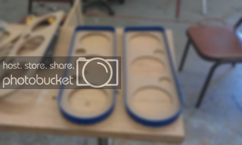

the blue stuff is low temp plastic. im not sure where you can buy it online. try a google search. i get it from select products but you have to be a dealer to get it. mobilesolutionsusa.com... try that

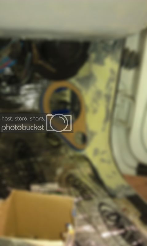

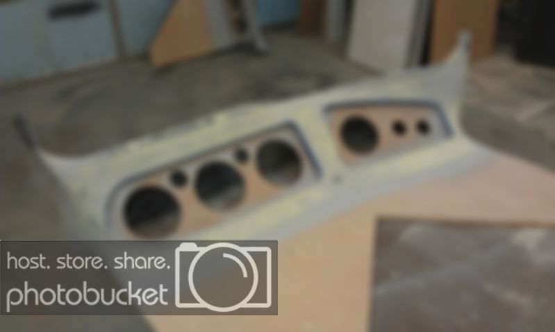

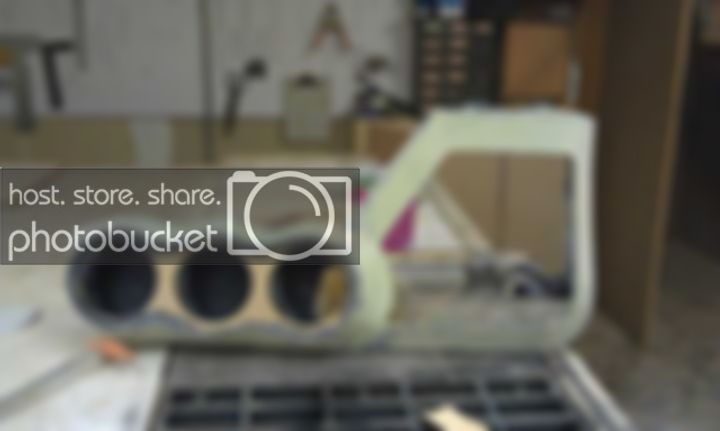

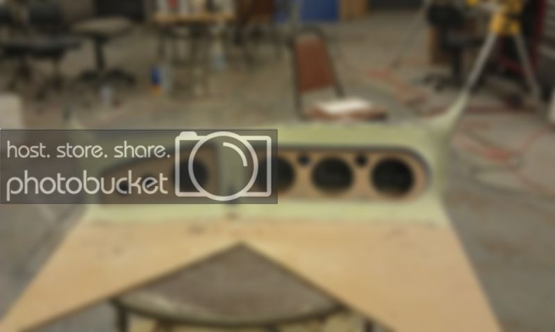

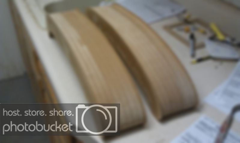

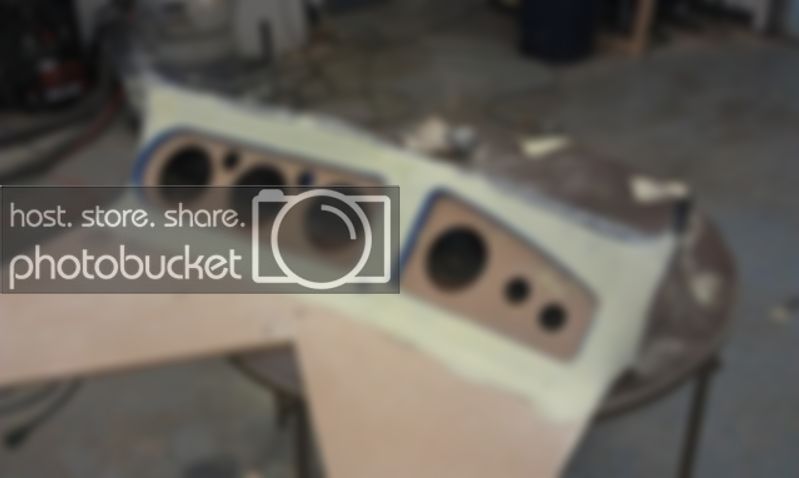

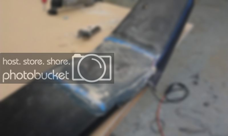

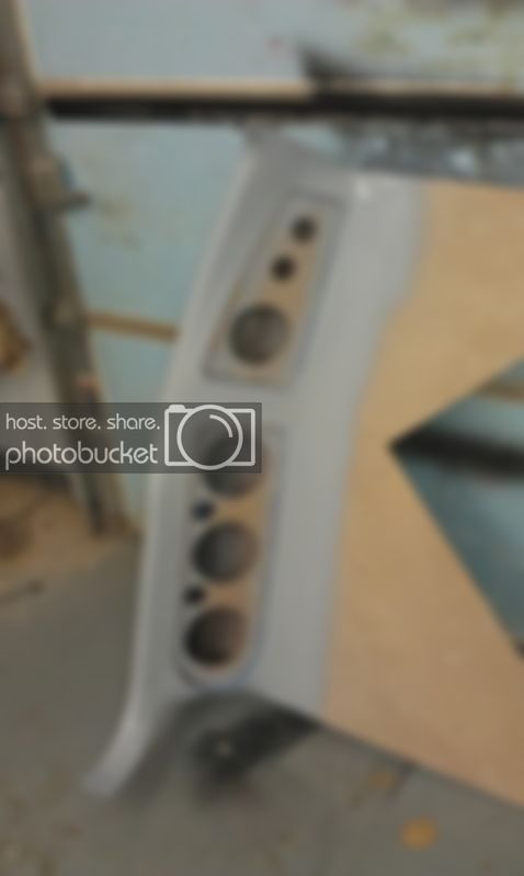

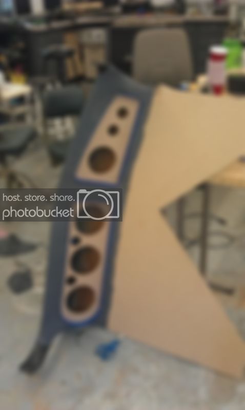

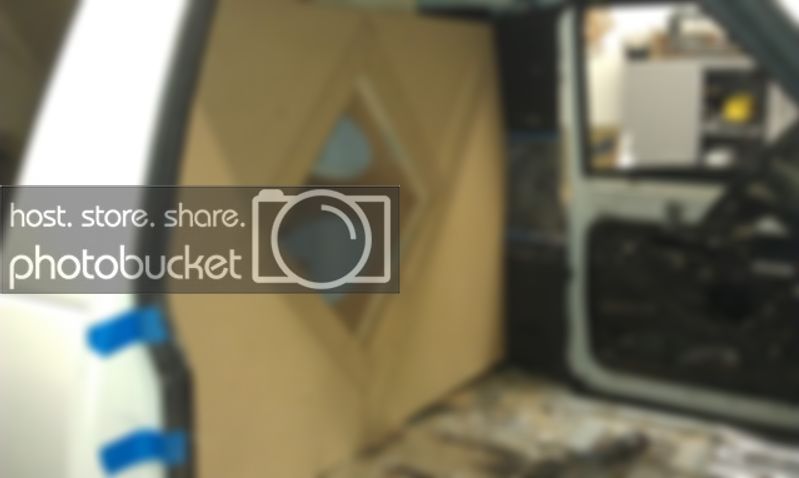

got a lil bit of work done tho. i decided to finish one of the kicks to see what the final look of the interior will look like.
used the chopper gun on this and it worked great. almost no body filling. just sanded the glass and was almost perfect.

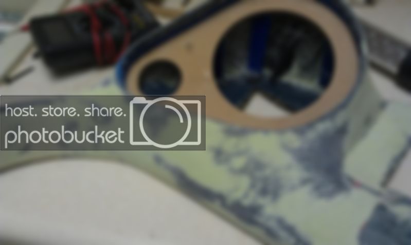

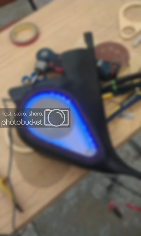

got in some of the 4 way stretch vinyl im going to use. got bored so i found some purple suede in the back room and half-*** made the grill. its not up to my standard but it looks good enough to get the point. im also using GLOSS white formica under the grill, not matte like in the pic. i wish they made a camera that would pick up purple, it looks blue here, but its far from it in person.

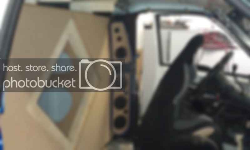

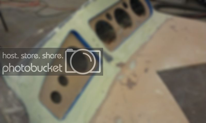

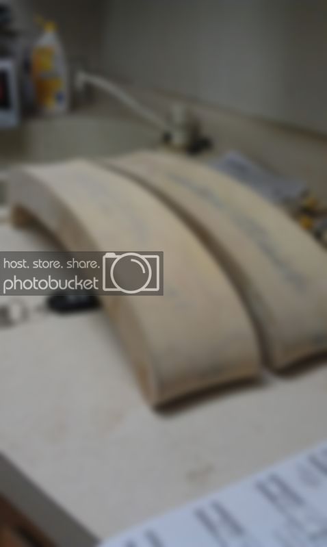

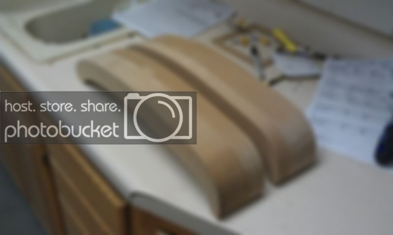

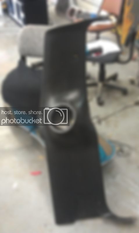

i really wanted to cry when i had to destroy these, first thing i fiberglassed that acually went in a vehicle. alot of work went into these to make them look good (trial and error lol)
i drilled holes in the sides of the plastic panel so that the fiberglass would better adhere to it.
