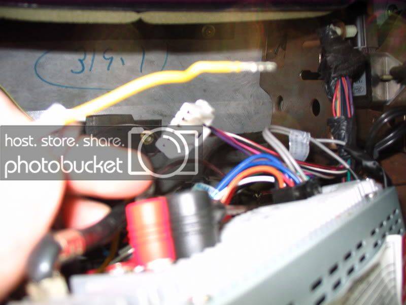

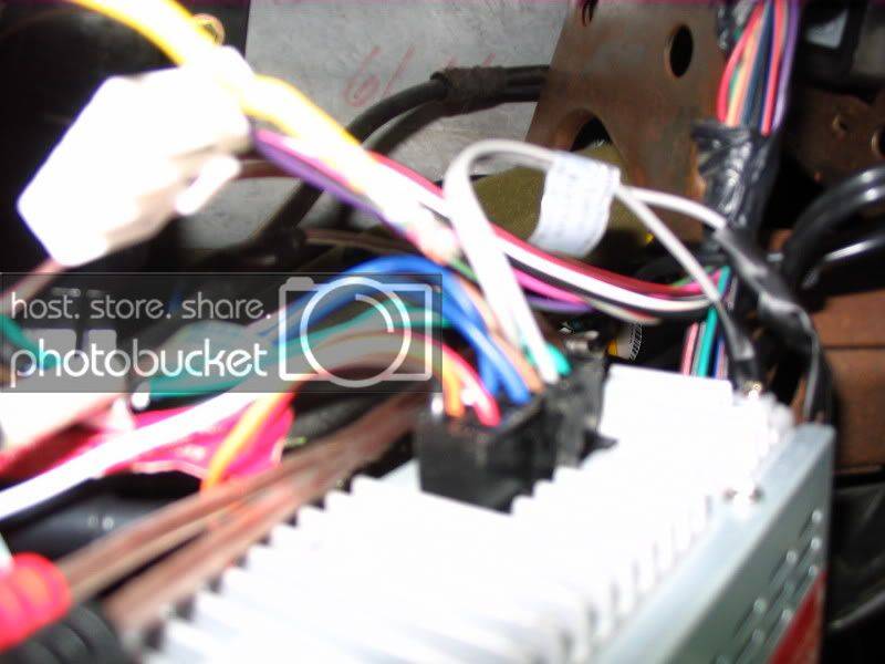

yellow power wire poped out of 16pin connector please help!!!

it you dont have the money for a new wire harness, you can still make that work!//content.invisioncic.com/y282845/emoticons/eek.gif.771b7a90cf45cabdc554ff1121c21c4a.gif put the computer speakers away!
push the wire back in, take the plug out and make sure the wire is going all the way through and has contact to the radio pins. get a clearer pic of the wire and maybe you can bend the tab to make it stay in place
I don't remember the technical name for the pins, but I call them harpoon pins. There should be a tiny little metal tab in the bullet shaped connector, take a tiny screwdriver or a knife, and bend that out at about a 5 degree angle, if there are two, on eon each side, do the same to the other. Slip the connector back into where it came from, push in until you hear it click in.
This is assuming it is what I'm thinking. xD Need better pics of the connector on the wire that came out. //content.invisioncic.com/y282845/emoticons/smile.gif.1ebc41e1811405b213edfc4622c41e27.gif
Harpoon pins i gotta remember that lolz awesome advice btw man right on as usual //content.invisioncic.com/y282845/emoticons/smile.gif.1ebc41e1811405b213edfc4622c41e27.gif
