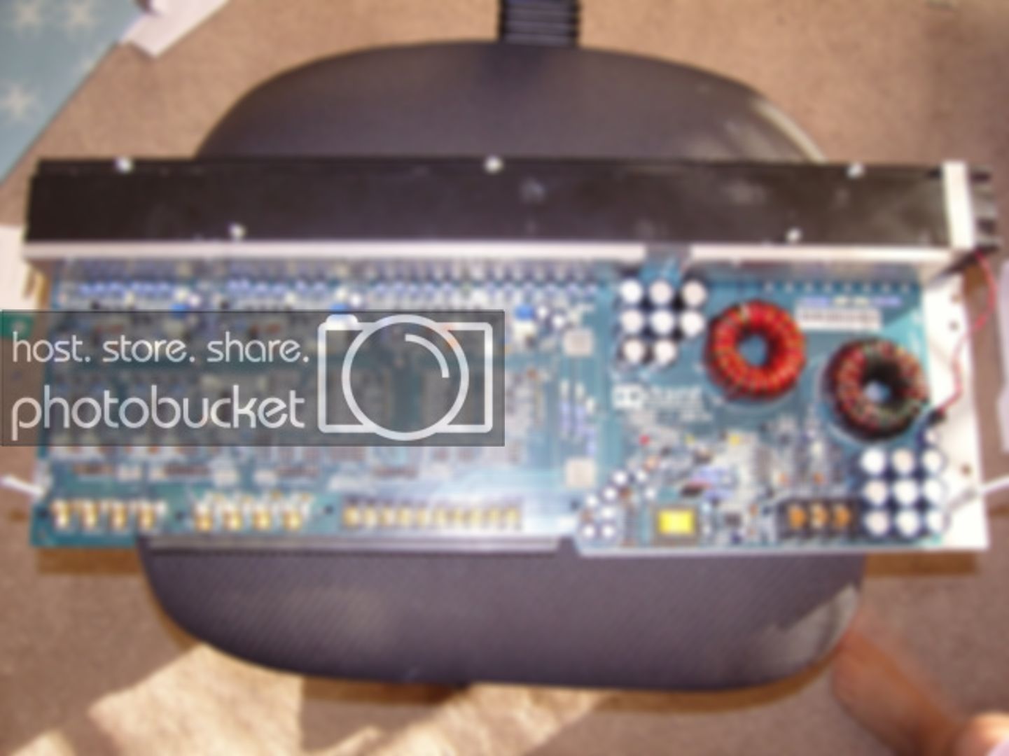

also, the 3300c is much larger than the 403a, and can be difficult to locate. it also has a 90 deg bend in the heat sink channel which reduces cooling efficiency, and it has thermal flaws in the power supply. both of my 3300c are on my bench in need of improved thermal management for power supply components. the stock design was/is flawed. the 403a addressed those issues and doesn't have the drawbacks.
