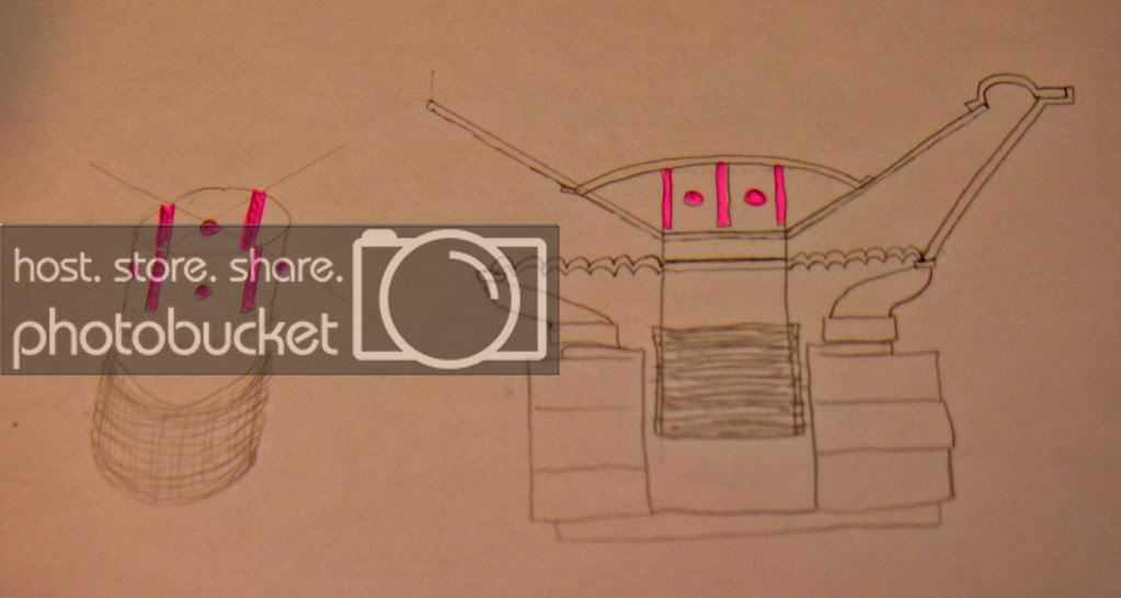

would this be possible ? cone/former/dustcap triangulation ?

it got me thinking - why couldnt the coil / former be designed to be the exact height you would need it to be to basicly rest on the dust cap when its installed. then there could be a glue ring put around the top of the coil / former and that would glue the dust cap to it - and the dust cap could also glue to the cone. making for a triangulation of sorts to the cone attachment to the coil.
it would theoreticly take alot of stress off the small glue joint at the bottom of the cone if you used a strong dust cap to do this with.
but then there might be issues with un equil air preassures on each side of the coil up under the dust cap as the sub travels in its stroke.... so I guess removing the areas in pink on my drawing below might be enough to equalize the two preassure zones enough to work..... with some trial and error.... it just seems like if it was all thought out and planned correctly this would be a good way to streingthen up the subs that are now being built to take crazy amounts of power / motor force.
please excuse my third grade drawing skills... lol
does this not seem like a logical idea to you guys ?
