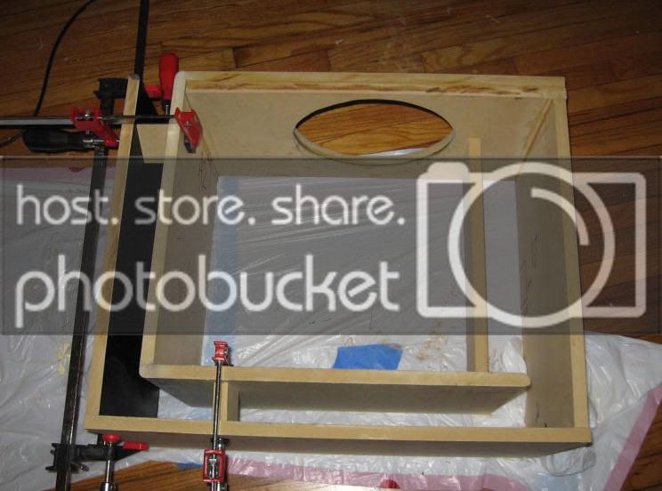

Progress pic.
I really messed up one of the sides and had to break it off, now i have to wait for the glue to dry on the ends before sanding it off to reglue //content.invisioncic.com/y282845/emoticons/blackeye.gif.66a1670f5aaf7f406e783a63e3387dc5.gif

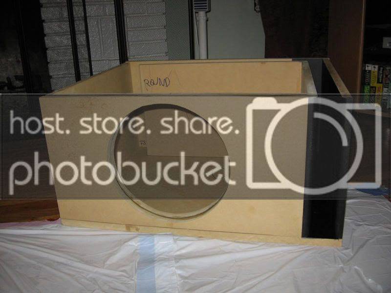

BTW I actually have good handwrinting, that "round" was written in a tight wierd angle. Also that dark ring between the MDF on the cutout is from a blue sharpie marker.
I was going between truck liner spray or carpet, leaning towards carpet.
I know handwriting doesn't matter, but I normally take pride in my lettering skills //content.invisioncic.com/y282845/emoticons/smile.gif.1ebc41e1811405b213edfc4622c41e27.gif That looks like I could be in the special olympics.

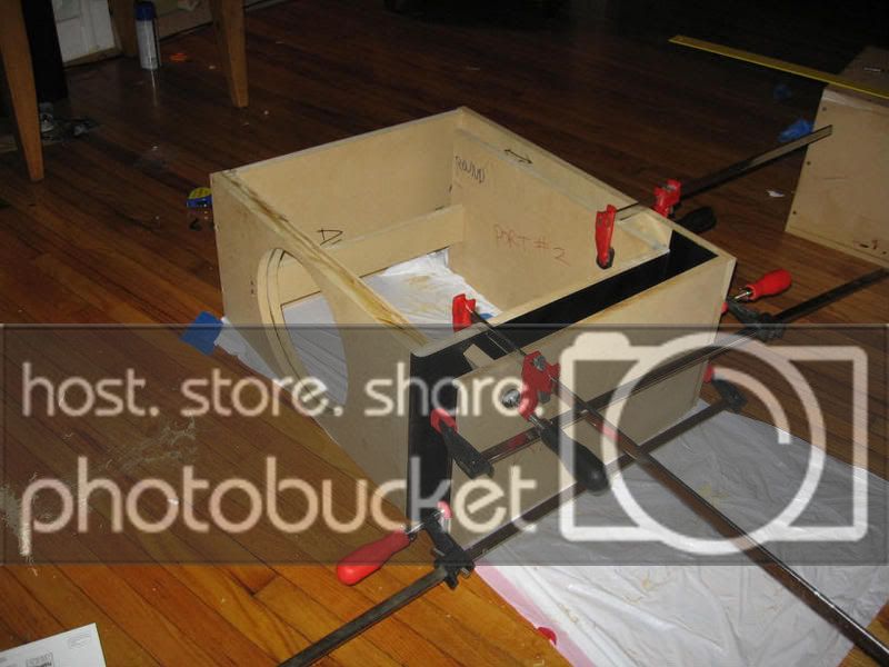

True, but it's more than enough. It's just 1 12" TC-1000. I finally figured out how to fix my angle problem on the side, it's moving along again. Should be about done in an hour or so. I can only do 1 side every half hour because I don't have enough clamps and I'm not using screws.
I'm going to finish up tomorrow, I'm too tired to finish tonight and I have to work tomorrow morning.
Had to use a few screws, oh well. One of the sides is pretty much held on with screws only, I hope that doesn't cause a problem.
The only thing left now is the top and bottom pieces, then carpet.
I'm getting rid of the brace in the port opening where the black is, but I'm gonna keep the other 2 braces. The one in the port will be turned sideways to let the air flow easier.
I'd take both the braces in the port out... once the top and the bottom are on... they're hold it secure. Also, with the driver and power you're using... as well as tuning... won't be too much flex/pressure.
