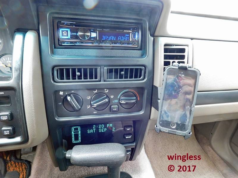

Alpine CDE-163BT CD receiver
SiriusXM SXV300V1 Tuner

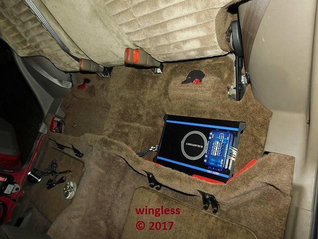

Blaupunkt GTA 470 DSP 4-channel car amplifier: 70 watts RMS x 4

Scosche SLC4 Line Output Converter (Used w/ aftermarket amp and factory head unit / shown in amp images)

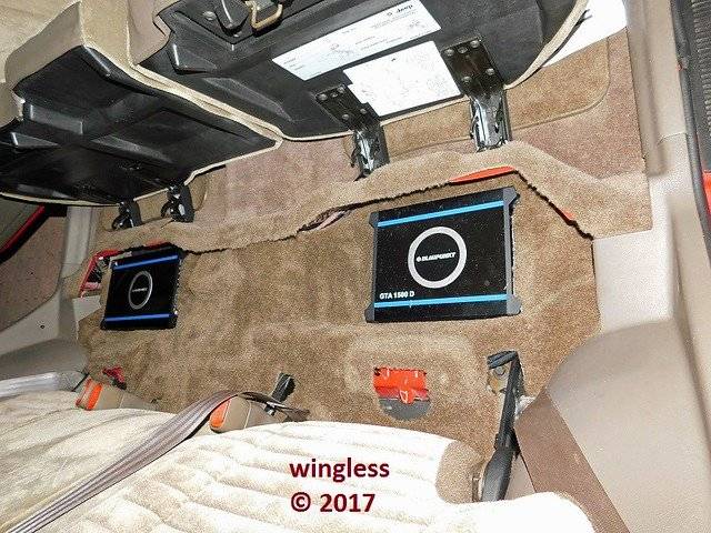

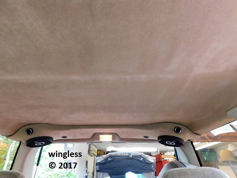

Why are you running a LOC if your running an aftermarket HU? Also...are those separates in the very back? While I condone creativity, nice whomever fabricated that area, most of the sound comes from up front anyway
Thanks for the feedback.
The answers to those questions and many more are provided in wingless-level detail in my installation topic.
The Line Output Converter was used for two purposes. One is that the aftermarket amplifier was used w/ the factory head unit for a period. The other is that when the Alpine head unit was installed I did a concurrent test, w/ the front through the converter and the rear direct line level, there was no difference detected.
The rear sound bar is an OEM part, that was reupholstered by me when I reupholstered the headliner.

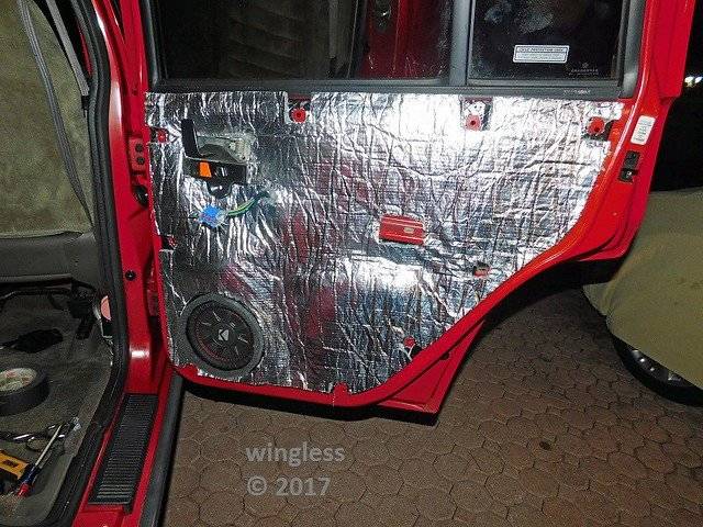

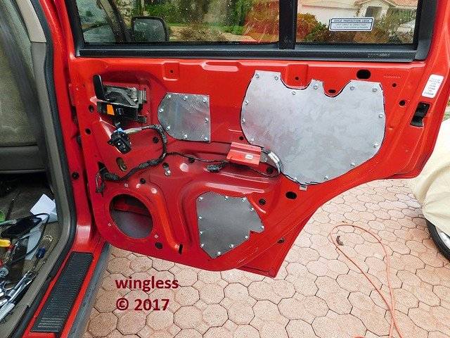

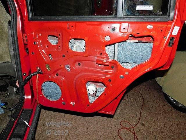

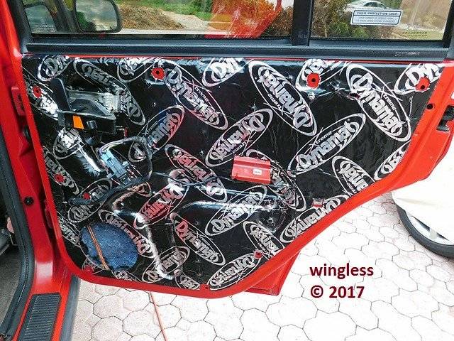

The rear door speakers are not active. I will be installing component subwoofers in the rear doors driven by a Blaupunkt GTA 1500 D 500W amplifier. I'm leaning towards a pair of these Kicker CompRT 43CWRT672 6-3/4" component subwoofer speakers, one in each rear door.
