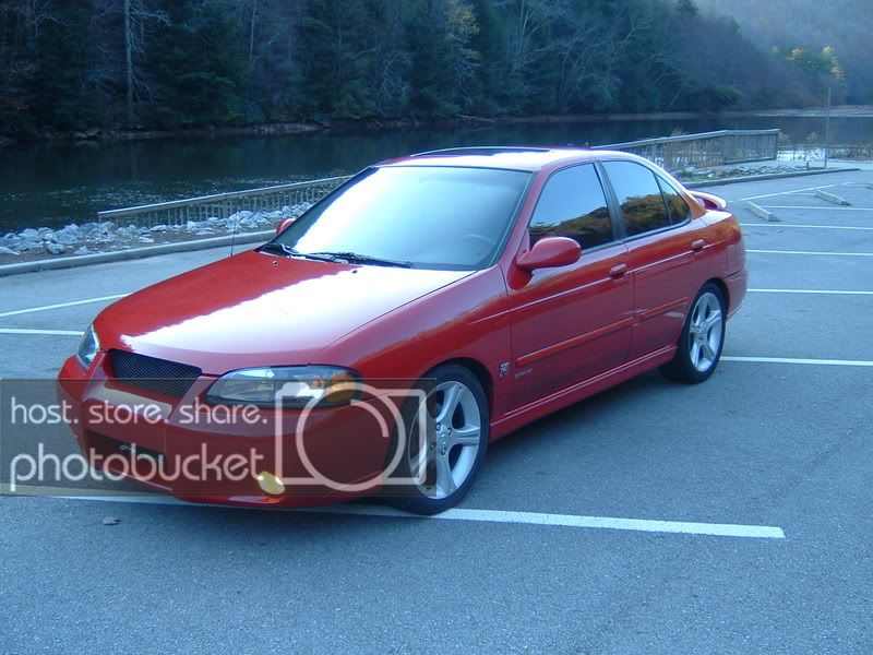

I wouldn't go with 5% though, just because I wouldn't be able to see at night. I love the 15% I've got on my car, I think it's Llumar. It's the perfect darkness IMO, it keeps people from seeing in, it looks pretty good, and most cops probably won't care. I've been stopped once, but it was just like a warning deal, he told me he didn't write tint tickets but other officers would, he just told me to keep that in mind. I haven't been hassled too much though *knocks on wood*.
Here's a pic of my car with the 15% on it:
