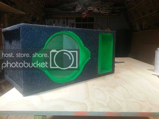

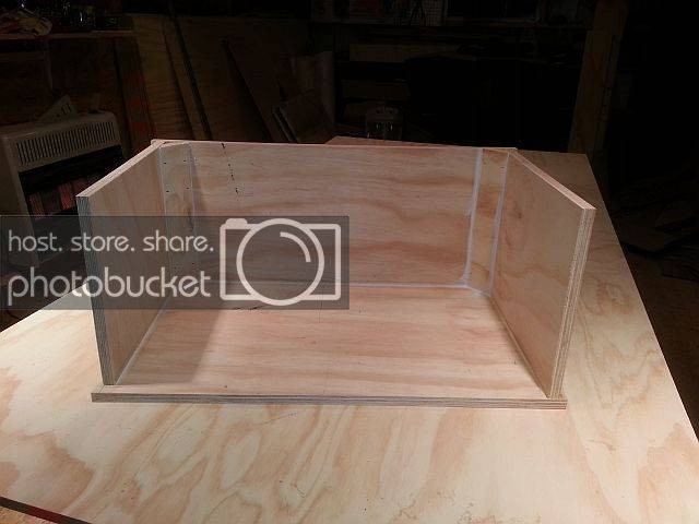

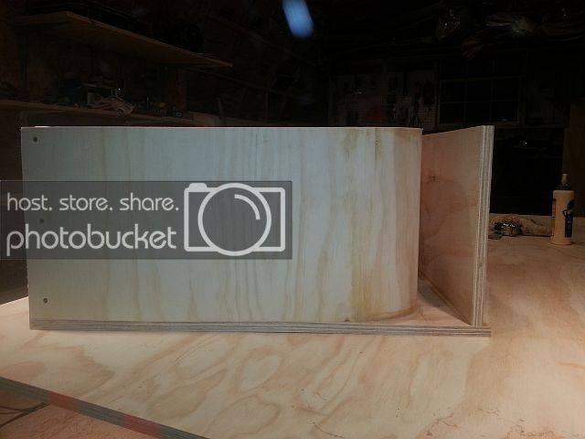

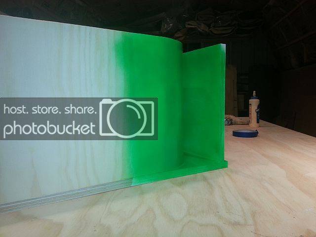

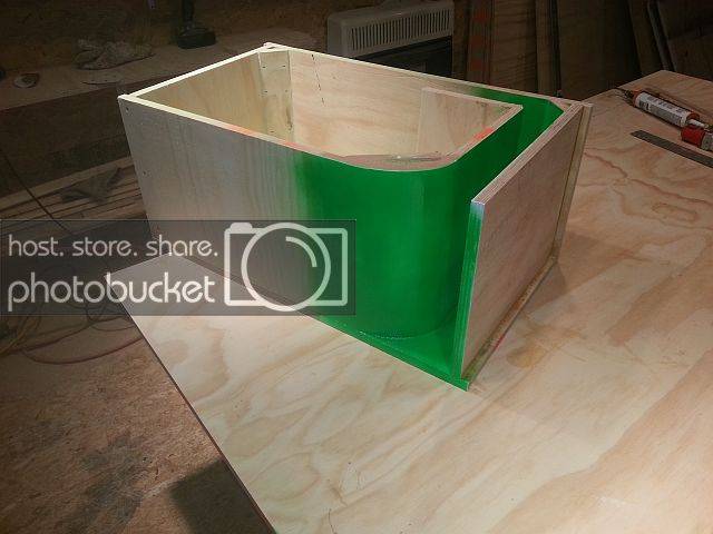

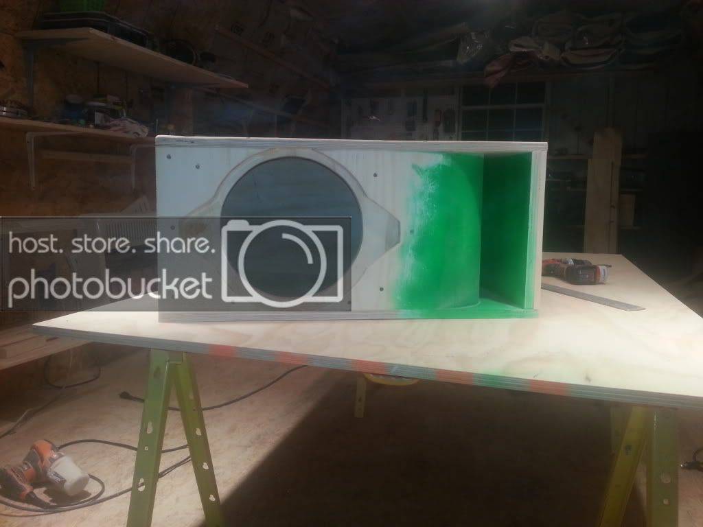

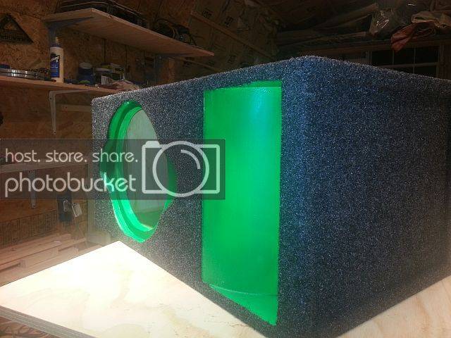

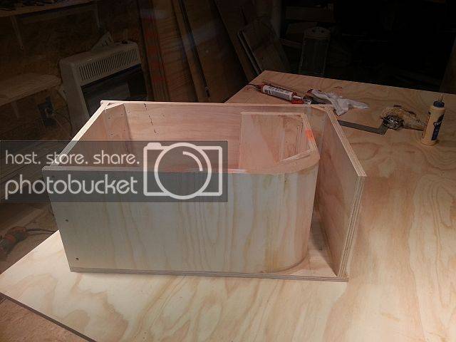

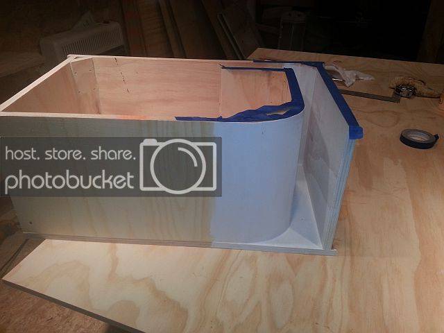

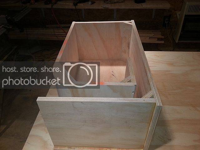

Single 12" D-Con....2.25 cubes net....33hz.......Arauco construction, kerfed port, flush mount, and neon green accents....
