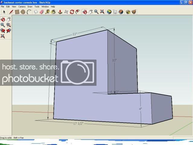

a backseat "center console" like box
it has to fit under the back seats because i need air space.

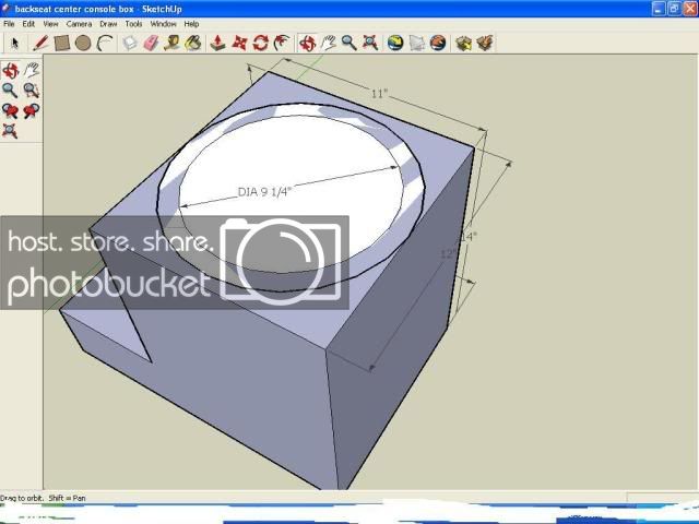

the smaller circle is the cutout and the bigger circle is the outter diameter from fi's website
my main question is because it is so close to the edge, that is my MAX depth its already pushing into the seat cushion an inch or so, will i have any problems? ill be sure to turn it so the screw doesn't mount close to the edge. any other foreseeable problems? any HELPFUL criticism is welcome
As long as you make the top that the sub mounts to an "outside" piece, should be fine, and won't matter if the sub screws go into the side panel, just make sure to pre-drill them
