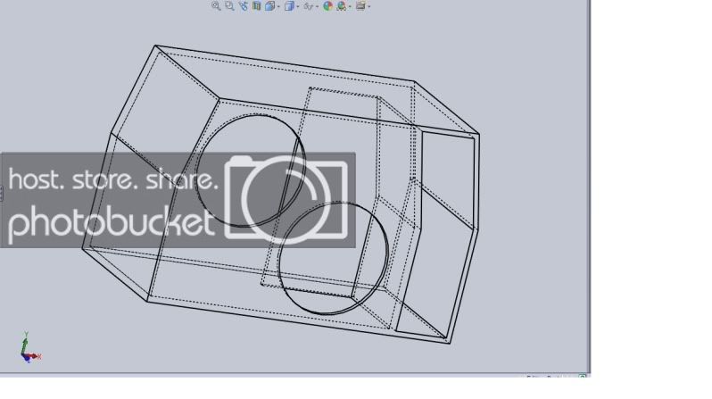

Will this port mess with tuning a lot?
plugitin
She Bangs
hmm, lemme know what you think...
yes it would where L2 is the port does not have as much area as the L1
this was my concern...
kind of just threw this together for a drawing, so no defined volumes yet or lengths. Its not too much of a difference...so i might go with it still
I would section it off and create a dual port. One on the top and one on the bottom separated by a horizontal MDF piece. Once you get to the turn, match the port according to its area. That will solve the problem.

i think i get what your saying at the turn in the port. ill draw her up a little later after work...thanks man
