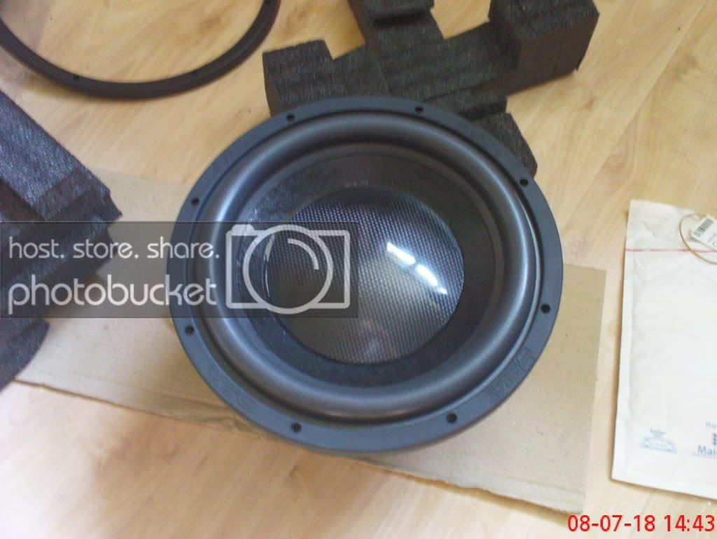

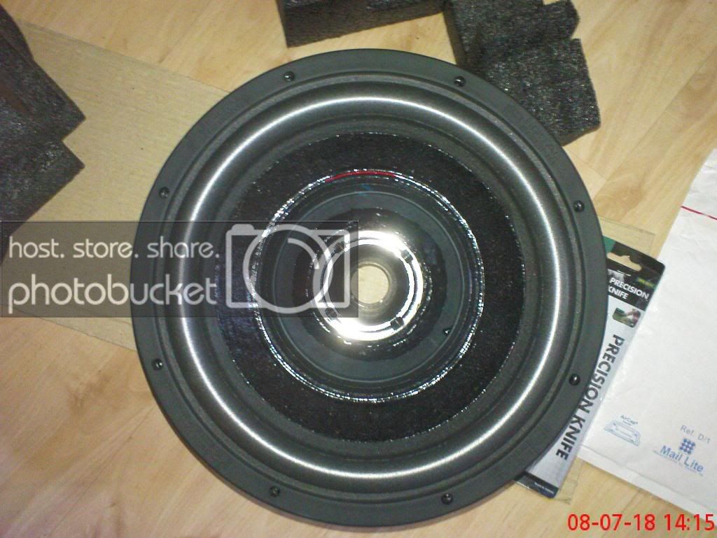

i have been very careful and cut the old paper cap off, and only 0,4" is still there from the old one, but how and with what can i glue the new cf cap on? can i use some black siliconeglue? i´m a sort of a pedantic, so i want it to look nice too..
and the new cap is a little bigger than the old one, i marked the pic with some red paint where the new cap will sit,

okey, one more thing, as you can see the new dc will be right on top on the old DD black cosmetic glue that are a bit in on the cone, does the ca glue fix on that old glue you think?
ok sjobas i've actually done the same swap on mine....use the ca glue around the outside and do not use the activator. it will turn the glue white....the cf cap will get a white dusty film after the ca dries....then just dust it off and everything will work...i have pics if you wanna see.
