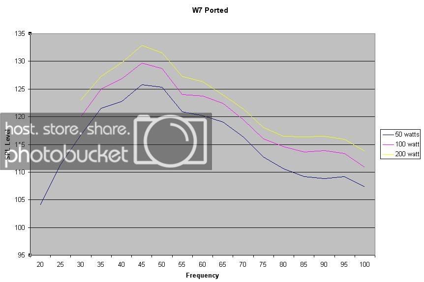

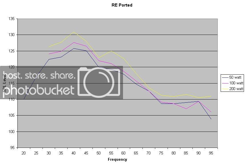

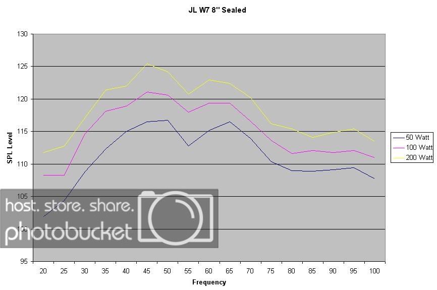

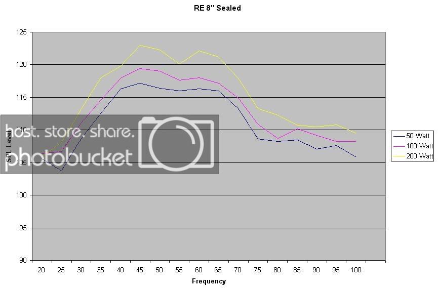

Here's a bit of real world..
JL W7 8" sealed .5 cuft
Re 8" sealed .5cuft
W7 8" ported 1.0 cuft 35hz
Re 8 ported 1.0 cuft 35hz
RE 8 efficiency - .13% (83.3 db 1w/1m)
W7 8 efficiency - .112% (82.7 db 1w/1m)
why was the W7 as loud with 50 watts, and much louder with 100 and 200 watts than the RE 8?

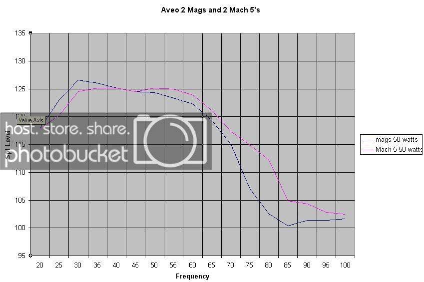

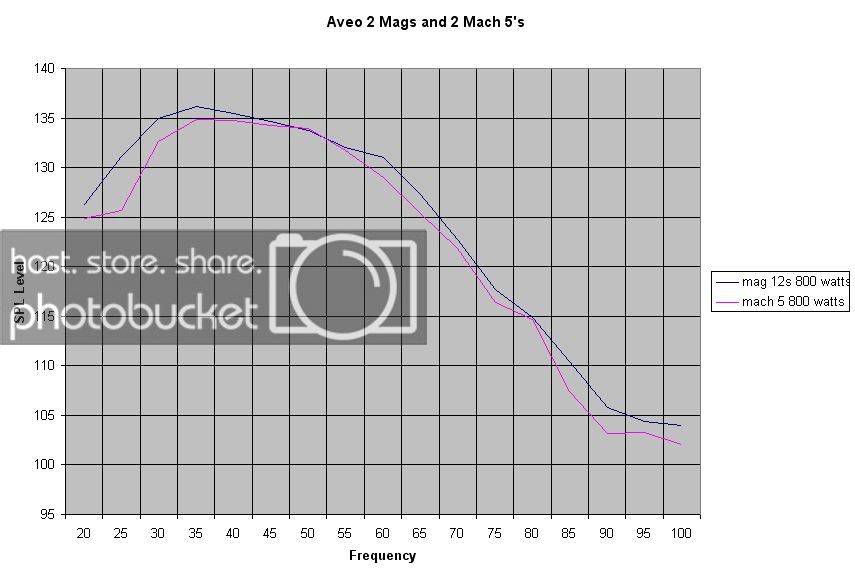

Here's some more real world..
Mach 5 12's 85.5 db 1w/1m
SI Mag 12's 85.7 db 1w/1m
nearly identical efficiency... yet the mags are 3 db louder on the low end, and the mach's are louder on the upper end with 50 watts, and not as loud as the mags on the upper end with 800 watts.. its not supposed to be that way?

In his case, it might be, a small 8" driver can power compress with a few hundred constant watts or less over a minute or so. The w7 8" has a larger 2.25" vc.. very large for an 8" driver. Second reason may be xmax limitations due to either compliance or coil height. Or some Bl product issue at higher excursion. Again, all this is real world based on VERY different variables. apples to oranges. My argument is very straight forward and irrefutable.

I'd wager it was a combination of BL induced and heat induced compression, since the RE driver uses a totally standard overhung design, whereas the 8w7's topology yields a flatter overall BL curve.
