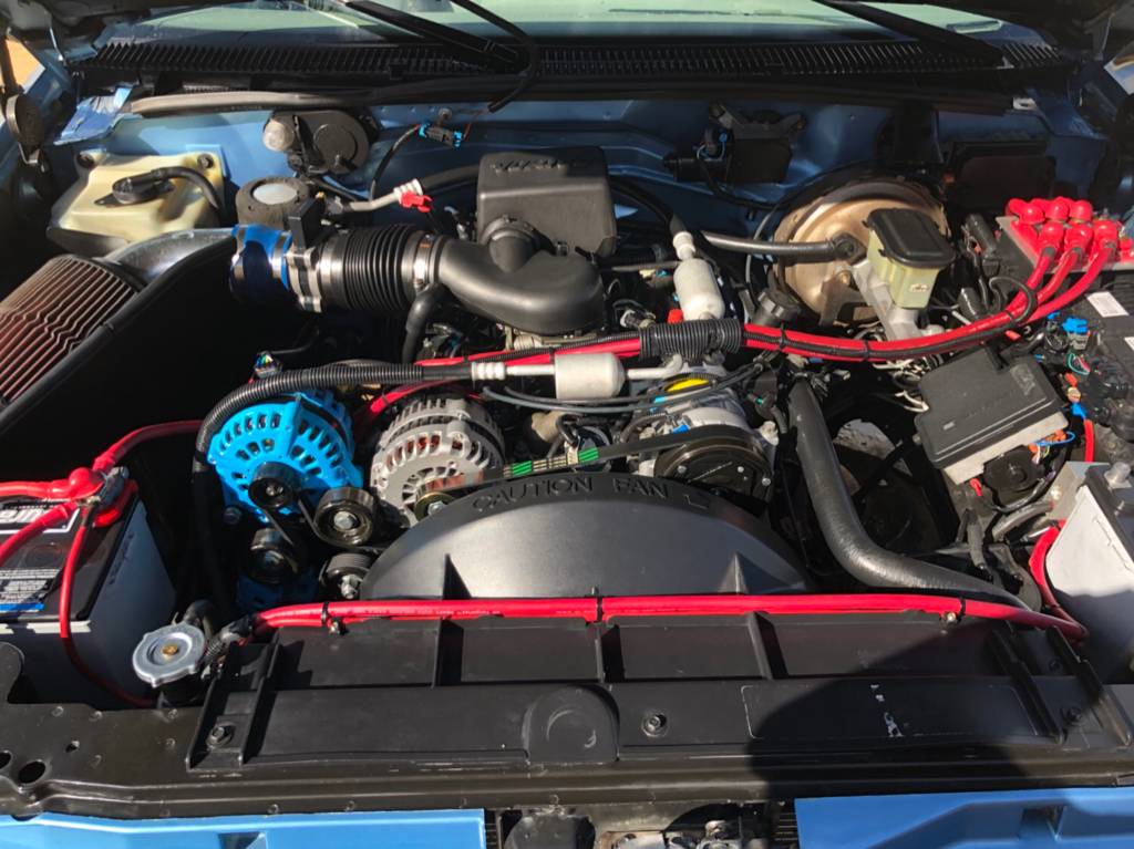

No corrosion at all , I cut a piece open and it’s not that lumpy , maybe just insulation after getting warm I don’t know. I do know the other two don’t do it though cuz I replaced the temco with Royal excellene under the hood and still looks like the day I put it in

for a second there i thought the fuses on the right were a distributor lol
Ya the boots to cover lugs look like plug wire boots //content.invisioncic.com/y282845/emoticons/smile.gif.1ebc41e1811405b213edfc4622c41e27.gif
3 years later
man that looks excellent! no corrosion is a good thing. if you run it and keep it warm it should keep the moisture out but i chose the tinned wire because i live in New Orleans and i rater be safe than sorry.i paid my *** off for it though. i think it was 200 a spool..
