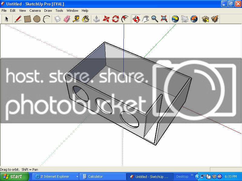

which template
vehicle --000 Ford Expedition
3rd row is taken out
Cargo--D-36" W-48" H--19" Like to keep level with rear seats
as for freq id like to keep it in the low 30's sound good for 2 or 3 cvrs 12"?
is my amp in sig sufficiant to run 3 ported?
... 9.39cuft after sub/port displacement - Tuned @ 32hz
( 48"W x 30"D x 15"H )
