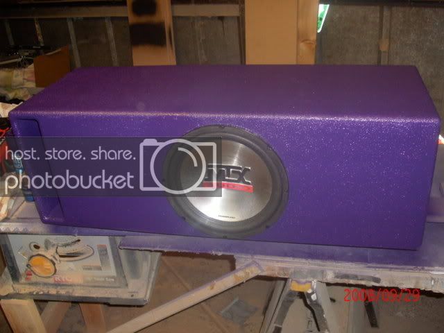

paint. it is far more versatile than carpet. it can be flat, gloss and in between. you can texture, or leave it smooth. you can do combinations. inside port different color, etc. far better than carpet. but you have to do good woodworking.
i like to roundover, texture and paint

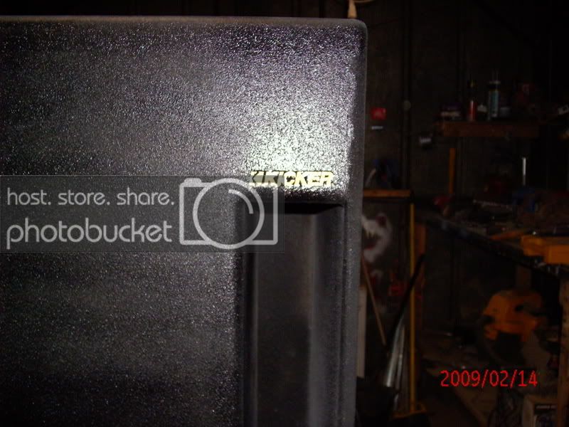

What do you use to get that look?
it depends. i roundover everything with a router. sand it pretty good. prime. sand. paint with primary color. spray textured paint. re-paint with primary color. use either matte, semi-gloss or gloss clear enamel.
