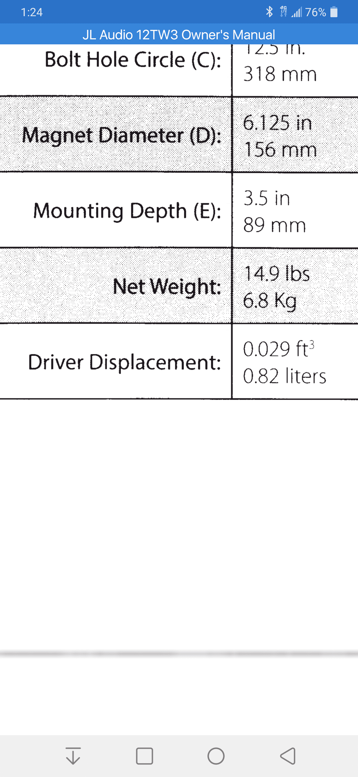

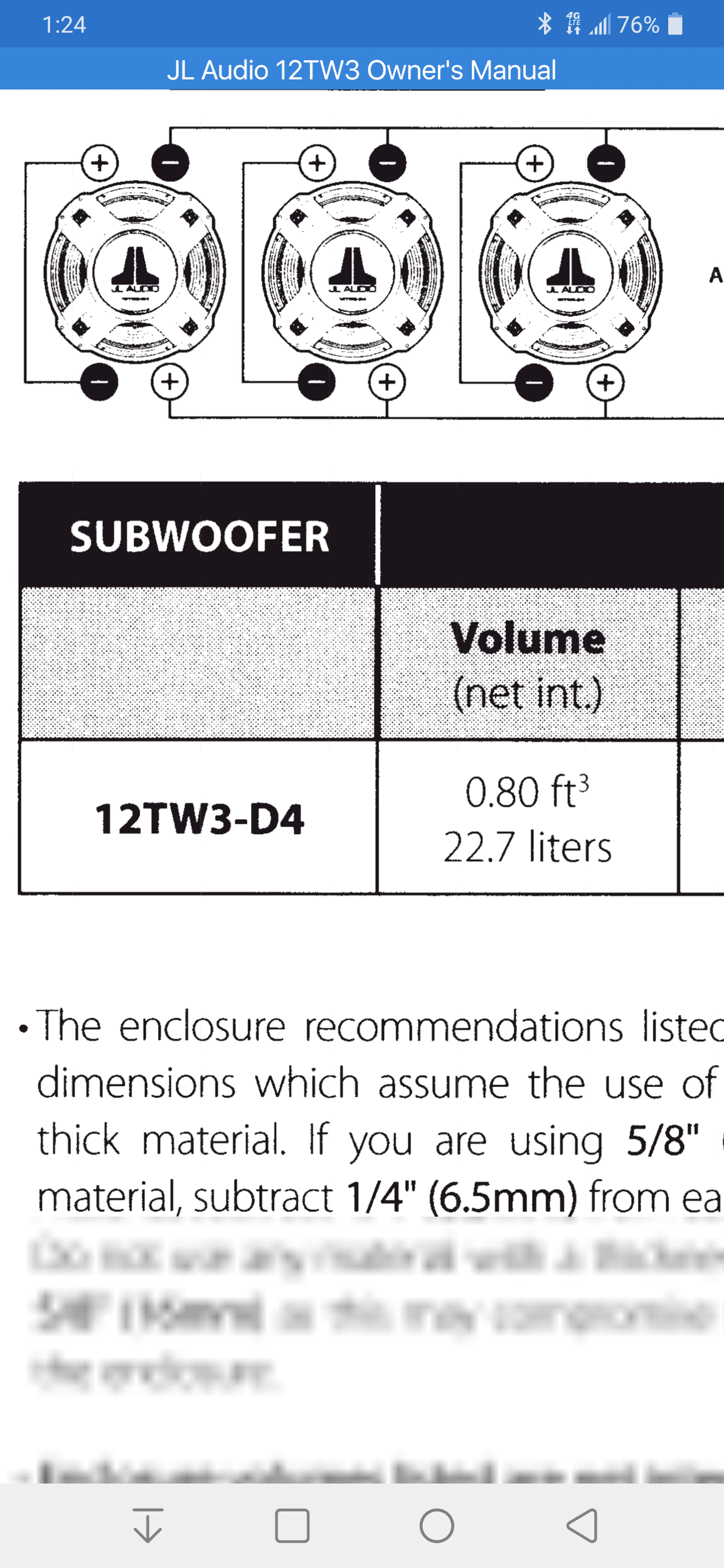

That .6 is also before sub displacement as well..
These subs need atleast .8 per sub NET sealed..

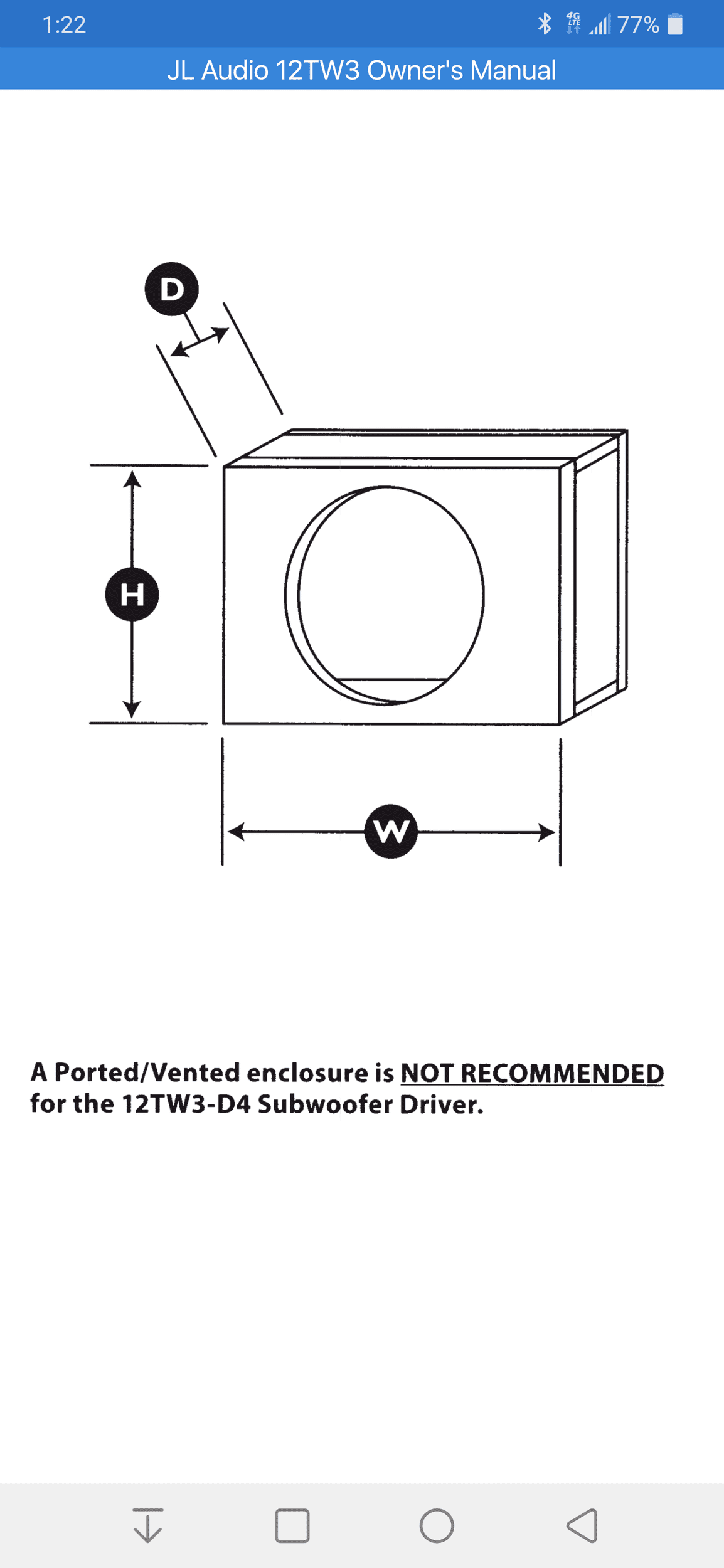

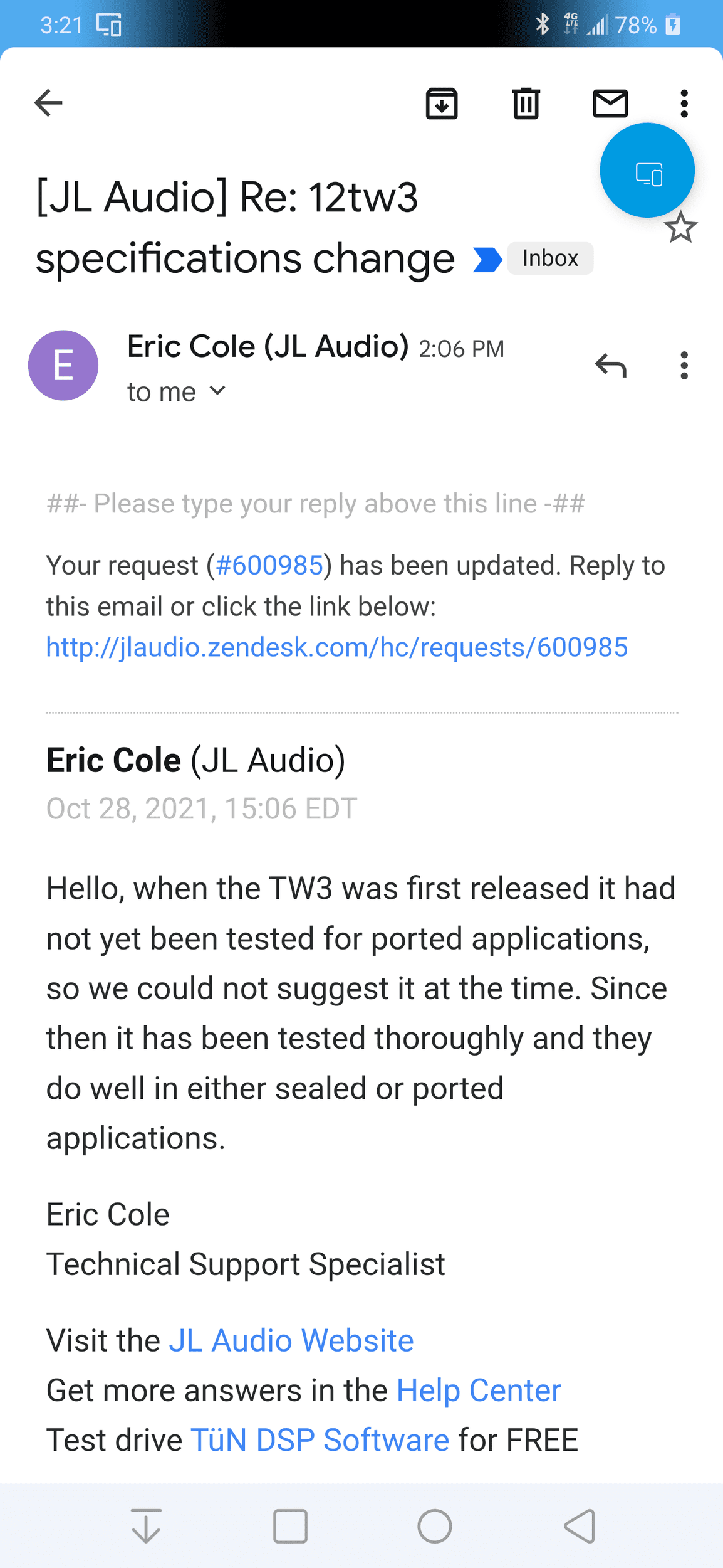

JL states .95 per sub ported, If you could fit that under your seat I'd give that a try.
Ported is not recommended for these subs.
I did have them in that exact ported box, from the JL website, when I first installed them but then I picked up another helper and needed the backseat. Frickin crybaby, “I don’t like riding in the bed when it’s raining or snowing out”. lol So I had to do sumthin different. I’m actually now in the process of raising the seat with some little custom built spacers that I’ve machined outta….ok, with sum stainless steel washers I bought at the hardware store 😜…..and I’m going to rebuild the prefab box and try to add a lil more interior volume to it. Gonna have to keep it sealed, as there’s no way I’ll be able to get an extra .4-.5 cu ft outta each side, but I’m hoping to get it as close to JL’s specs as possible. I definitely like these subs tho. JL always does it right n I’ve been using their products for years. When I decide to change out my Rockford Power series subs, in my car, I’m likely gonna try some W7’s. Been threatening to for several years. lol
