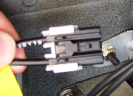

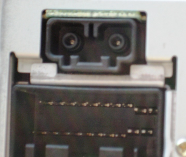

Changer Port:
Changer plug:

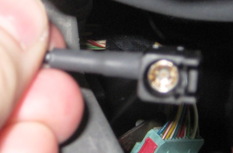

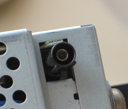

Antenna Port:
Antenna plug (sorry camera wouldn't focus):
changer is what looks liek fiber. your best bet is hardwired fm modulator, the metra one is pretty good, and get the antenna adapters to match it, so you dont have to cut anything. looks like the chrysler/euro antenna plugs
