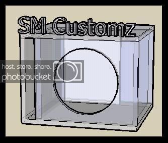

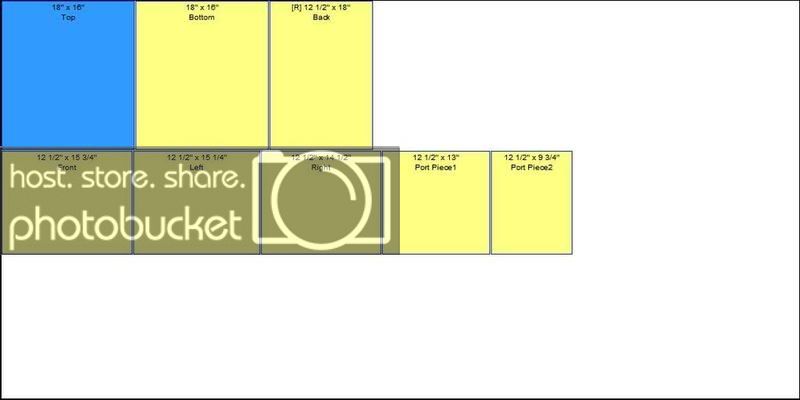

Alright its for a 10" HDC3 ran off a sundown 1500d, does this design check out?
18Wx14Hx16D
1.35ft^3 @ 35Hz
Port Width=1.5
Port Area=18.75
That is a small width port, but the recommendations are...
(1)12-16 square inches of port per cubic foot.
1.35x12=16.2 so that is sufficient
(2)The W and H of port shouldn't be more than 9 to 1
12.5/1.5=8.333 so that is sufficient
Sound good?
alright how do i go about making the deflector ? just like a triangle for the one corner before the port and the corner at the L of the port correct?
