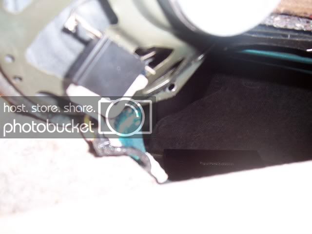

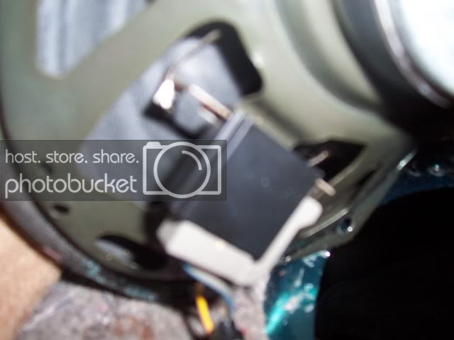

im talking about these wires should i cut them?: which one is + -

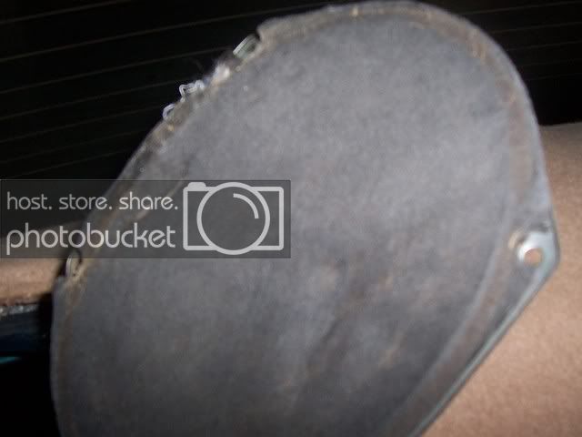

well when i was doing it i destroyed the speaker it looks like this now lol:

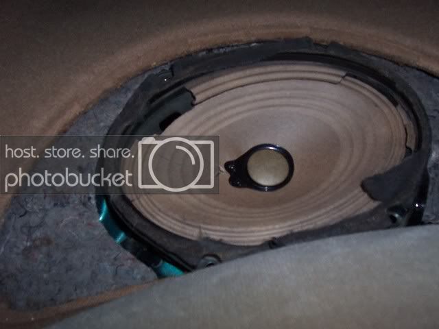

when it should have looked like this: lol
Its ok to use a little force with those POS stock speakers //content.invisioncic.com/y282845/emoticons/wink.gif.608e3ea05f1a9f98611af0861652f8fb.gif
As for the connections, just snip off those connectors and strip off the end of each of the two wires for each side. Those two wires are now your negative and positive speakers wires. Either crimp or solder the speaker connections that came in the box to the correct stock speaker wire and you should be good to go. And I believe that usually the wire with the stripe on it is the negative, and the solid is the postive. I might be wrong on that:confused:
