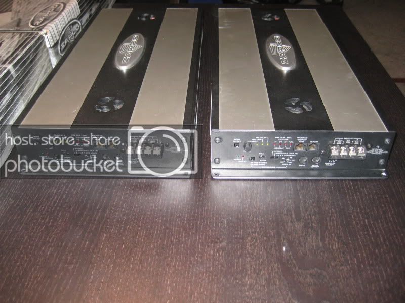

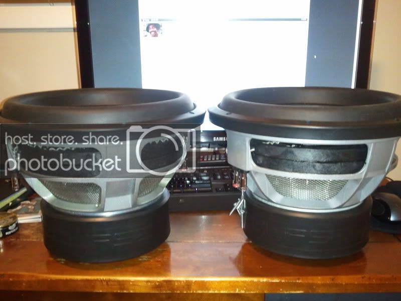

Going to start my instal very soon and this is what I have planned for the sub stage.
I have an 03 explorer. Deadening the entire vehicle with 2 layers in the hatch.
Box tuned to about 34hz. Rebuilt sw9122's subs side by side facing hatch. 4" areo ports in bottom corners with a 3 inch space from bottom and side.
Each sub will be powered by a Zapco c2k 9.0xd. 2200rms @ 4ohms. obviously the subs will probably take about 12-1400 max. So a total of about 3k rms @ 4 ohms.
Either way... I'm gonna find out soon:)
