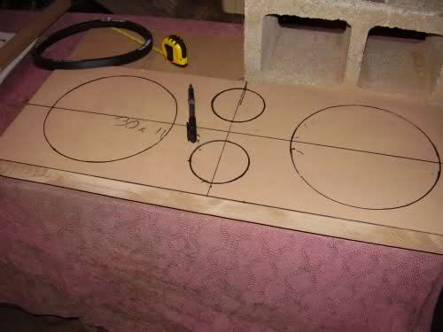

Heres a pic of the front baffle, everything is already cut out
typically the general rule of thumb to follow is 12-16sq inches of port per net cubic foot in the box. using the low side 12sq.in./ft. usually yields a more responsive and punchy bass closer to that of a sealed box, 16sq.in. yields a more "boomy" loose bass line.
for you box example, if you are using 2.5cubes net. you have a total of 14sq. in of port total..you'll definitely need more port area. more in the range of 35 square inches..
He doesnt "need" more port area, that box will sound just fine with no audible noise, none at all.
Ive went as low as 10sq in of port /cube with a slot port and the results were just fine
Following the factory recomendations is obviously best, but not always necessary
Your 2 ports will work just fine
Ok. Most i can add though is another 3" port, and do 3 3" ports 12 inches long. Would that be enough area? I can do either that or do a 3.5" x 11" x 14.5" slot port. Slot port would def be easier, what do you guys think about that? With that slot port id have only 2 inches at the rear of the port though for air to flow through between the port and rear wall //content.invisioncic.com/y282845/emoticons/crap.gif.7f4dd41e3e9b23fbd170a1ee6f65cecc.gif.
