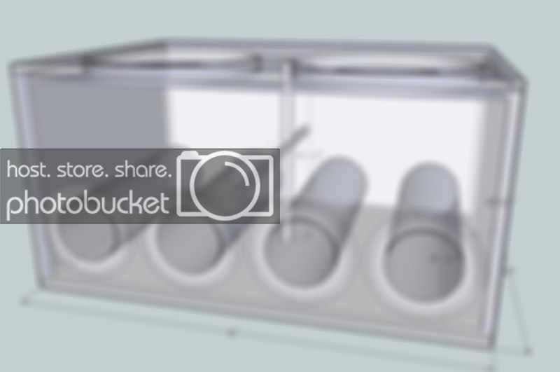

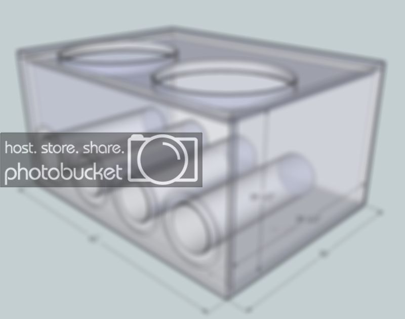

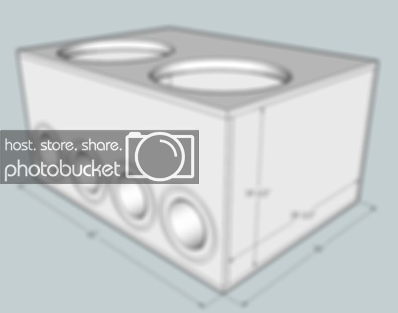

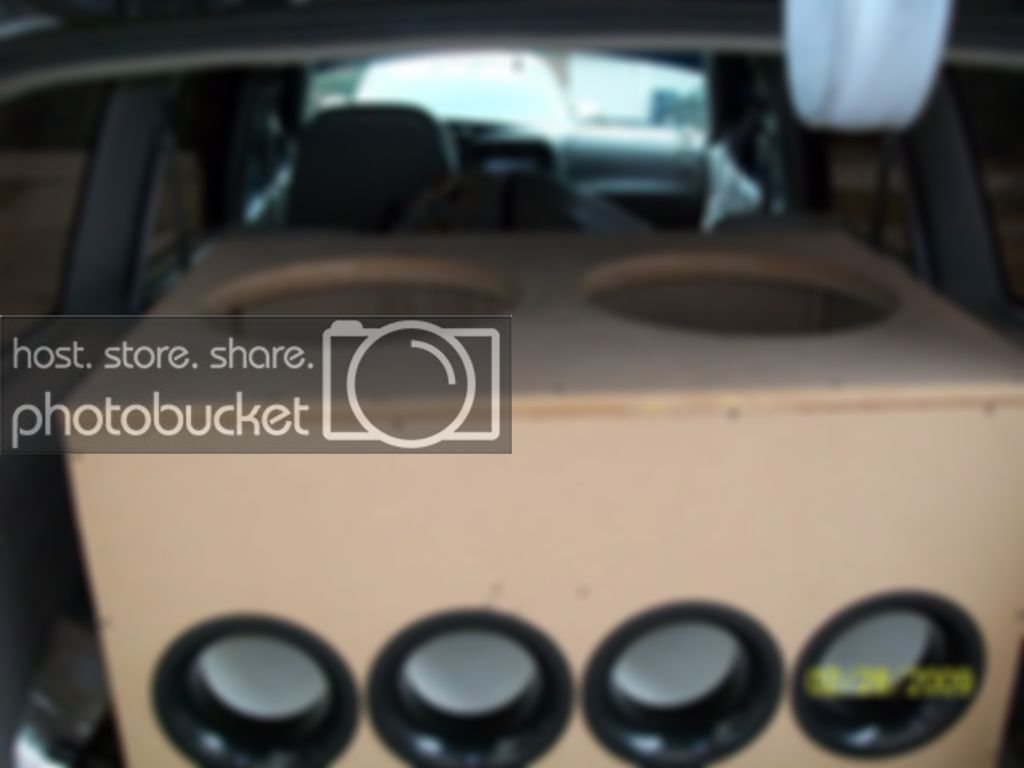

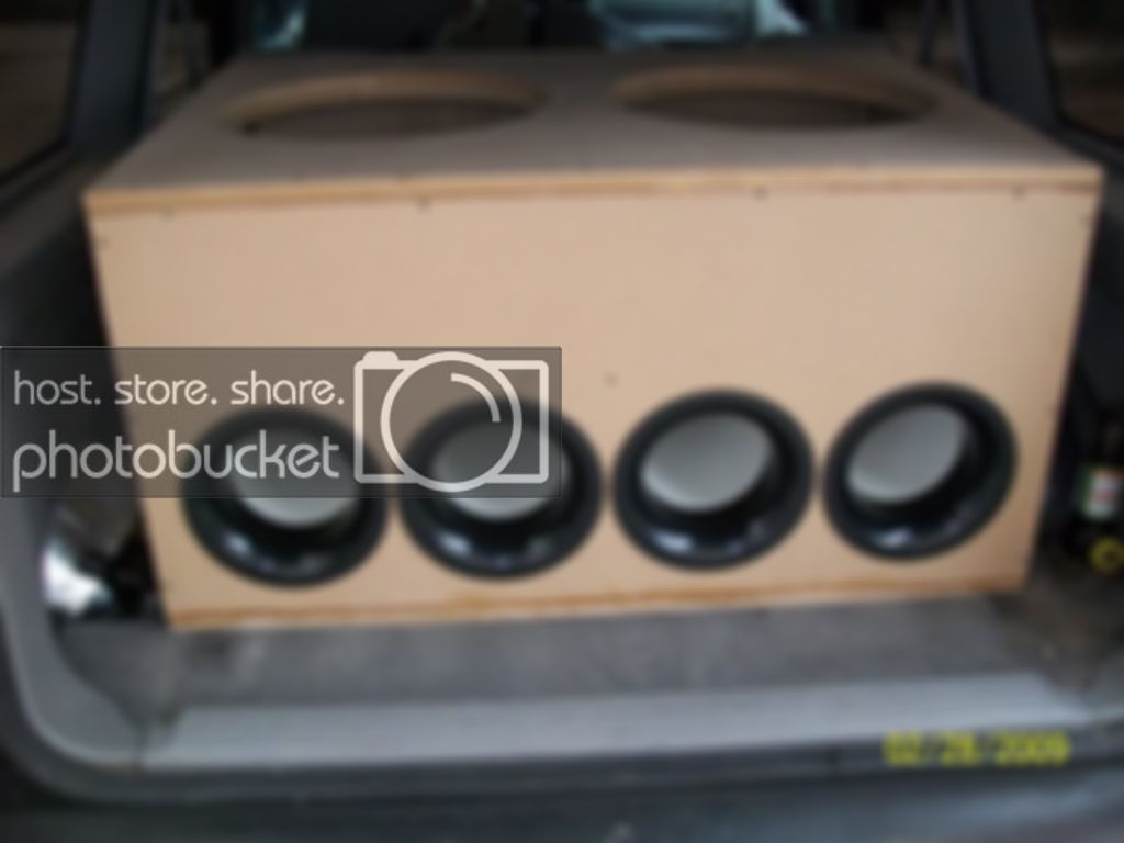

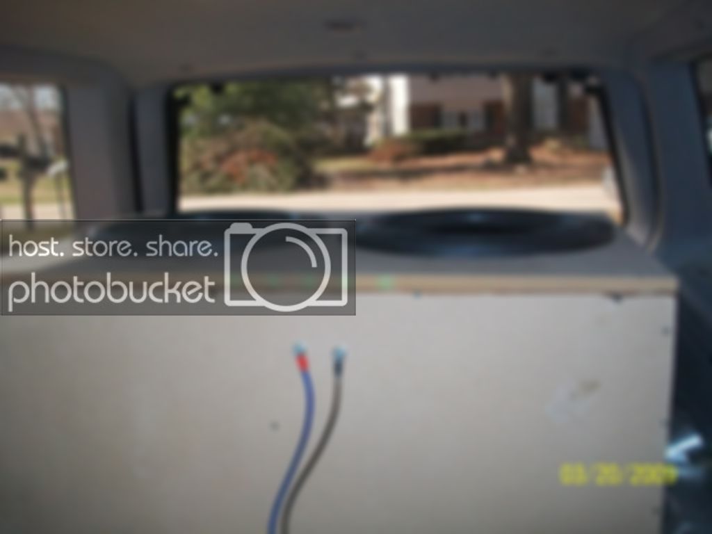

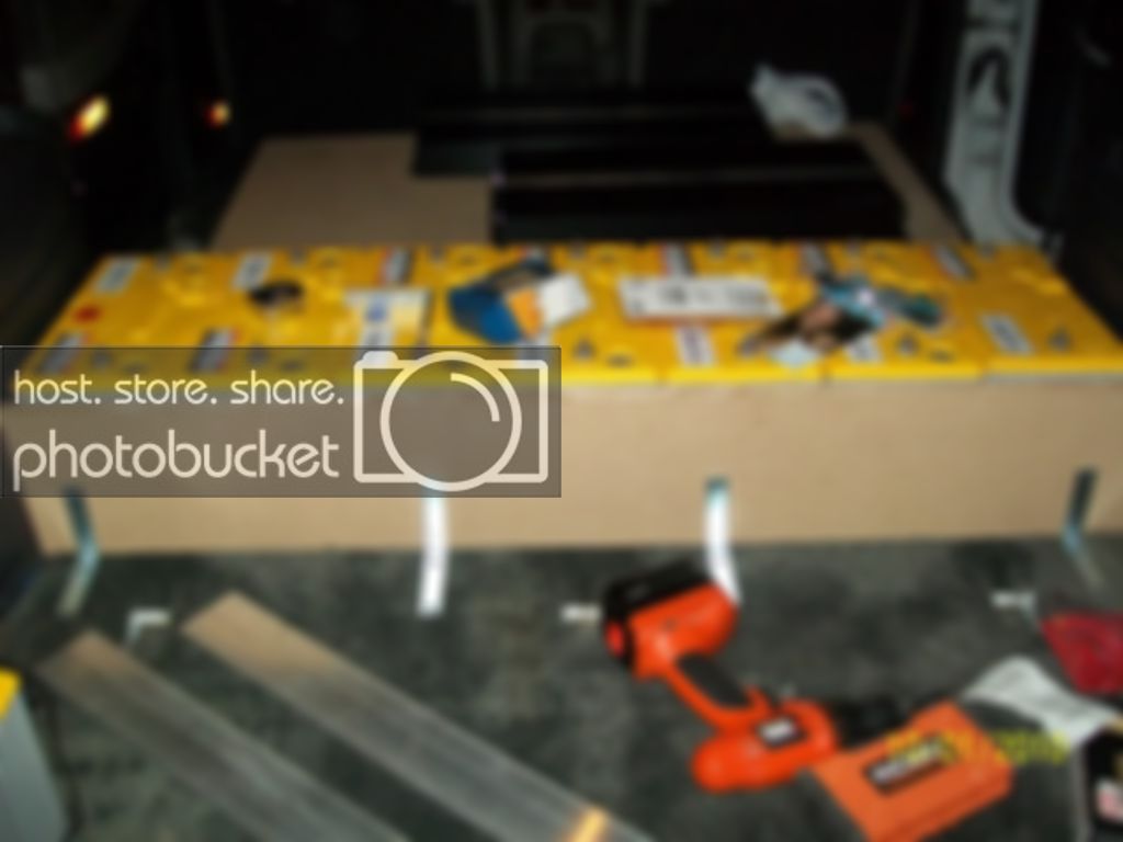

box is 10 cubes tuned at 32 hz will be raising the tuning to 36 tomorrow let me see if i still have the box build pics aso its subs up port back double baffle on the subs and the ports it has 4 6" aero ports only thing i did was fill the rear hatch so far no deadner out of cash at the moment the 52 is on music sealed on the dash only alt i have in the truck is a dc powr sp270 and at full tilt i stay at 14volts now thats sick with the power i have.subs arent anywhere near broke in just got it playing today got to deal with my first ever pico issue.
