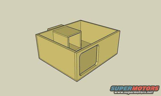

Here's the current box. I believe with it being so high it may be blocking out some of the output I could get from this.
Let me know what you guys can come up with. I appreciate it.
-Casey
Is there a possibility of making something like this work in a sub up setup? I am worried about loading issues with the port in the center... I don't know what sub placement would give me the least loading issues, or if it would even sound right?
