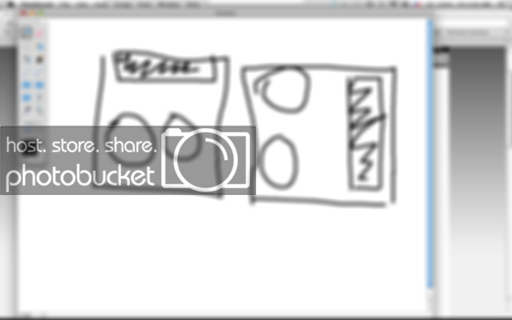

is there an advantage by porting on the drivers side rather than say.. the top of the box?
like this:
there are huge differences on port placement If I remember correctly.. top/bottom/sides etc all make a difference.. I personally would not want to be sitting in a port opening 24/7 so I would do it on the opposite side

you must have never had a port directly behind you?
My last wall i just tore down i had 300sqin behind me off 21kw. The pressure gets loaded on the opposite side of the car. Also, i'm in a seat so i can't really feel the air either.
