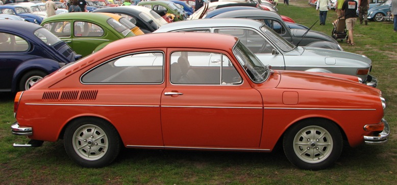

This is what I would look for were I going to do it again (see below). A jack and jackstands is all you need, granted, like anything else the better stuff you have, the easier it becomes. Air compressor would be very handy, especially if you plan on doing any body work at all. Most parts are cheap, and easy to replace, they are very simple cars. The main thing I would look for when buying a vw is how the floorboards and heater channels look. These essentially are the frame of the car, so you want solid heater channels at the very least, if not solid floorboards. Common places of rust are under the rear seat, below the batery, and up by the door hinges.

why do i see SPL potential in that //content.invisioncic.com/y282845/emoticons/confused.gif.e820e0216602db4765798ac39d28caa9.gif What is that one called?

Probably cause you see a wall of moofers in everything! //content.invisioncic.com/y282845/emoticons/tongue.gif.6130eb82179565f6db8d26d6001dcd24.gif
That sir, is a type 3 fastback. A bit more modern then the beetle, and a bit easier to work with. And it looks really cool in it's own way, not too far off from some of the old porsches. //content.invisioncic.com/y282845/emoticons/fyi.gif.9f1f679348da7204ce960cfc74bca8e0.gif

actually i was picturing rear seat folded down...forward firing subs...port in the rear all below the glass...lol
