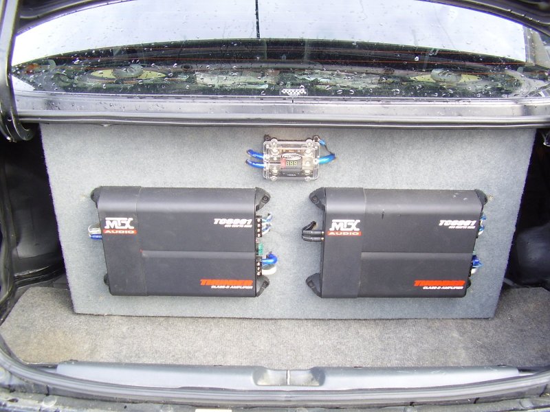

600RMS to each sub. The box is a little small, but it is all I could fit in the car and still have a little trunk room left. It is 3^f and is tuned to 35Hz.
Here is a pic of the amps.

I have have tried it with the subs facing back-wards and it sounded the same. With the the subs facing forward, you can feel the air coming off of them. It moves your clothes, hair, everything. I am working to seal the cabin completely off from the trunk right now. I have already sealed the area above the wheel wells with expanding foam. I will be making some MDF trim panels to go between the enclosure and the wheel well. I also have about another 50sq of sound deadening material to put in before I put my interior panels back in. I hope to put it on the meter here pretty soon.
