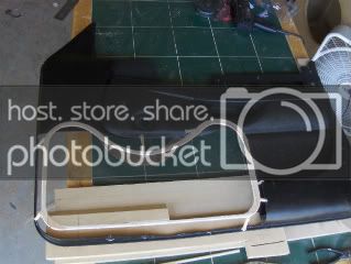

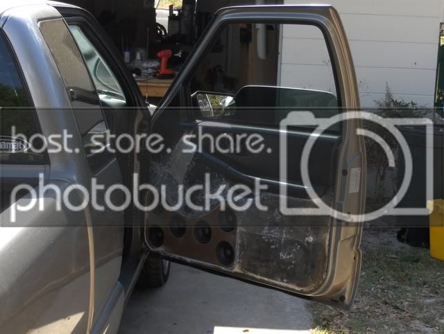

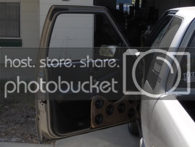

my first time fiberglassing. its been a pain in the *** for me, i hate not having the right tools
anyways heres some pics, i still have a lot of body filler work to do. but i dont have time, so this is how its going to SBN //content.invisioncic.com/y282845/emoticons/crap.gif.7f4dd41e3e9b23fbd170a1ee6f65cecc.gif
oh, and crank windows FTL!
and w/ no fiberglass. the door "pods" are attached directly to the door. the fiberglassed part only covers it as a "beauty panel". otherwise i felt it would be too heavy for it to be glassed to the actual door panel. S10 door panels are thin and flimsy as shit.
let me know how much you hate them, thanks //content.invisioncic.com/y282845/emoticons/wink.gif.608e3ea05f1a9f98611af0861652f8fb.gif//content.invisioncic.com/y282845/emoticons/frown.gif.a3531fa0534503350665a1e957861287.gif

ok, resized.
underneath of the two middle speakers ill probably put a Sundown Audio logo there, idk yet, still want to do the bondo to see if im keeping them or not. might scrap the idea and just stick with a pair of 6.5"s in the doors and a pair in the kick panels.
they are loud as fawk though, almost too loud. but sound WAY cleaner than the Dayton PA165's they replaced.
they are the Volcano Audio 5" mids btw, the kind that slapmaster is putting in his van, except he has like 40 of them lol.. i bought 26, cat chewed up 2 of them (paper cones). sold 8 of them, so im left with 16.
right now they are running at 2.66 ohms on the back 2 channels of my sax100.4, but i plan on getting a larger 2 channel and run 8 per side, giving me a 2 ohm load per side. (single 4 ohm btw.)
