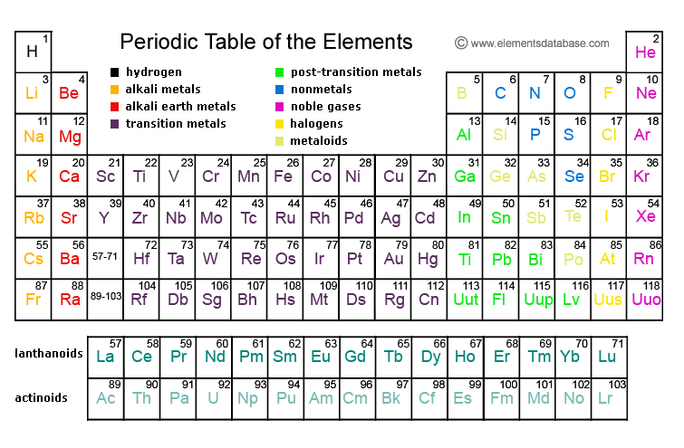

what?!?
now "copper" needs to be broken in?
transition metal #29 ? are we talking about the same thing?
3 questions:
what are you drinking?
how much does it cost ?
and where do you get it?
... I need some of that!

You're an idiot but that's ok.
